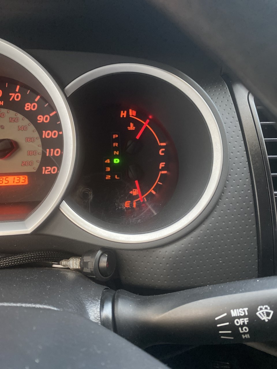

    @b_r_o Ok, let the engine cool then started her up with the radiator cap off. Didn’t see any bubbles foam up, but noticed the coolant started to raise up to the top of the radiator cap. Forgot to mention, that my engine temp doesn’t take long to reach normal operating temperature so I haven’t scratched the thermostat out of the picture just yet. Going to perform the blue liquid test either by myself or at a mechanic shop.

    2021 Silver TuRD Squirt DCSB 4x4 // 2008 Black Rusty Shitbox DCSB PreRunner
    15 minutes of driving 55 and this is as high as it goes. Also pretty much only starts doing this after the first red light stop.
    lynyrd3 and Taco critter like this.

    Im hoping for a thermostat, water pump, or plain air in the system. What’s weird is that the temp gauge redlined yesterday but no smoke or anything. Popped the hood and engine temp felt normal.
