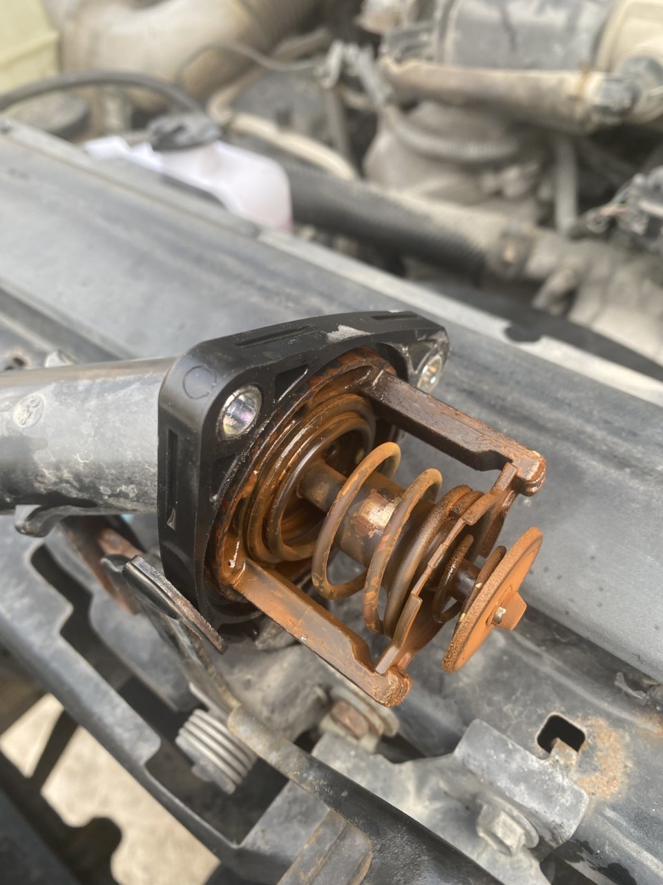

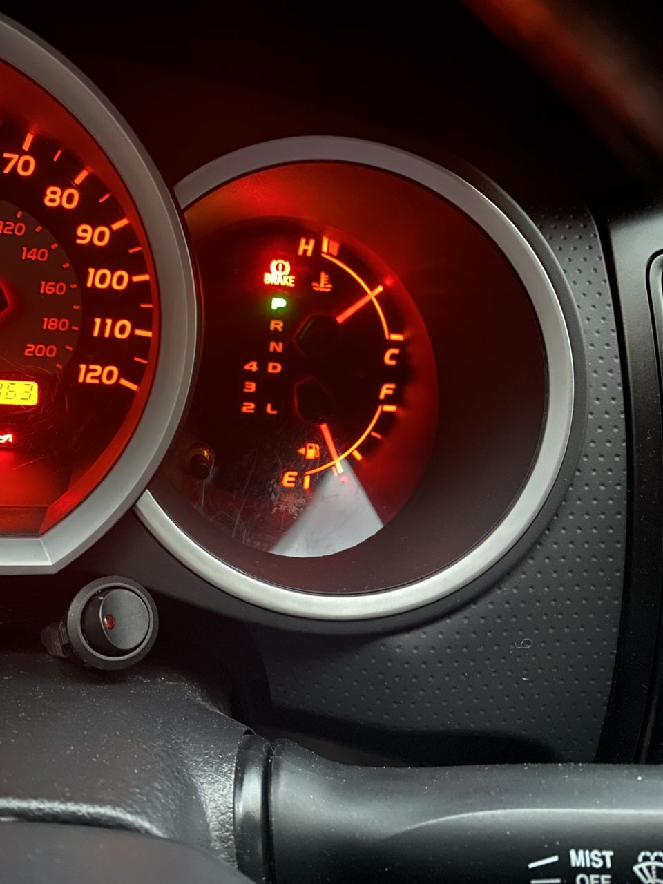

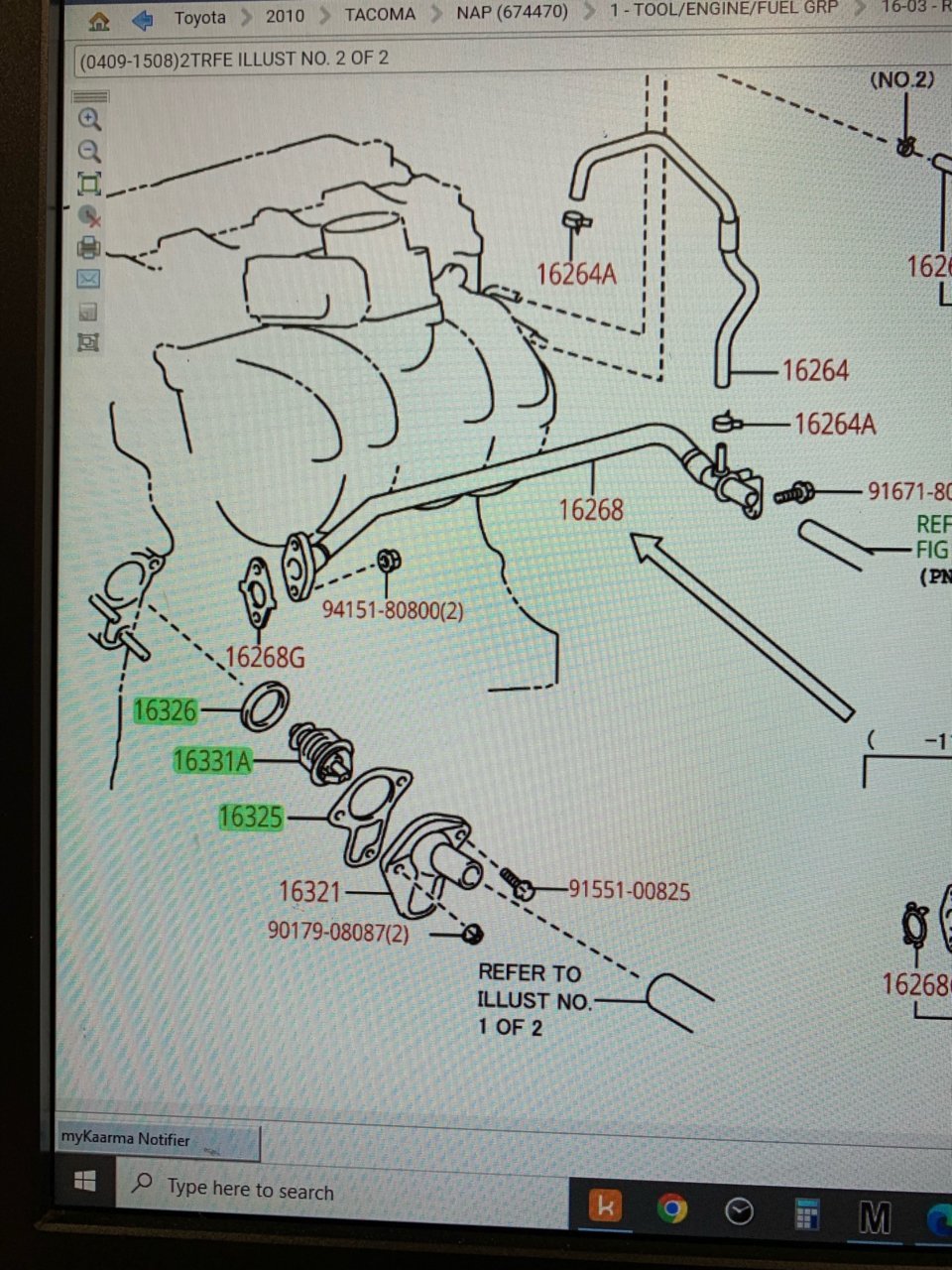

    Yeah, probably thermostat, and if the thermostat went it's likely the heater pipe burst too. This is what happened to my truck two weeks ago. The heater pipe is plastic and Toyota remedied the problem by making a metal replacement. My truck was doing exactly what @ALI3N_123's truck was doing, though it seemed like the needle went higher. My heater also quit working because the thermostat was stuck closed and the coolant couldn't make the full loop.

    Changing my thermostat at work. Hope this helps some.

    Also, make sure you check the heater pipe. Yours is a V6, right? I don't know where it's located on a 4.0L, but apparently Toyota originally used a plastic pipe that is prone to cracking and remedied it with a metal replacement part.

    Sounds like it’s hard to get to. I’m currently scared shitless, my instinct is to always hope for the worst.

    Same here; I thought my head gasket was bad. On a 2.7L, part 16268 is the heater pipe. My mechanic sent me this to show me what part needed to be replaced. The part is about $90...

    Currently replacing the radiator. We noticed only the top portion of the radiator heats up while the bottom remains cool. This is probably due to sludge buildup from extended use with plain water. After we installed the thermostat, we noticed that the temperature remained normal at operating temp at idle for a good 20 minutes before the temp started to rise, raising the RPM’s to 2k quickly brought it back down… something that wouldn’t happen before. Although this isn’t an official head gasket test, there isn’t any foam forming in the coolant by the radiator cap.

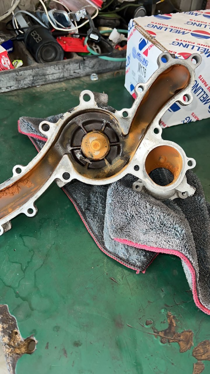

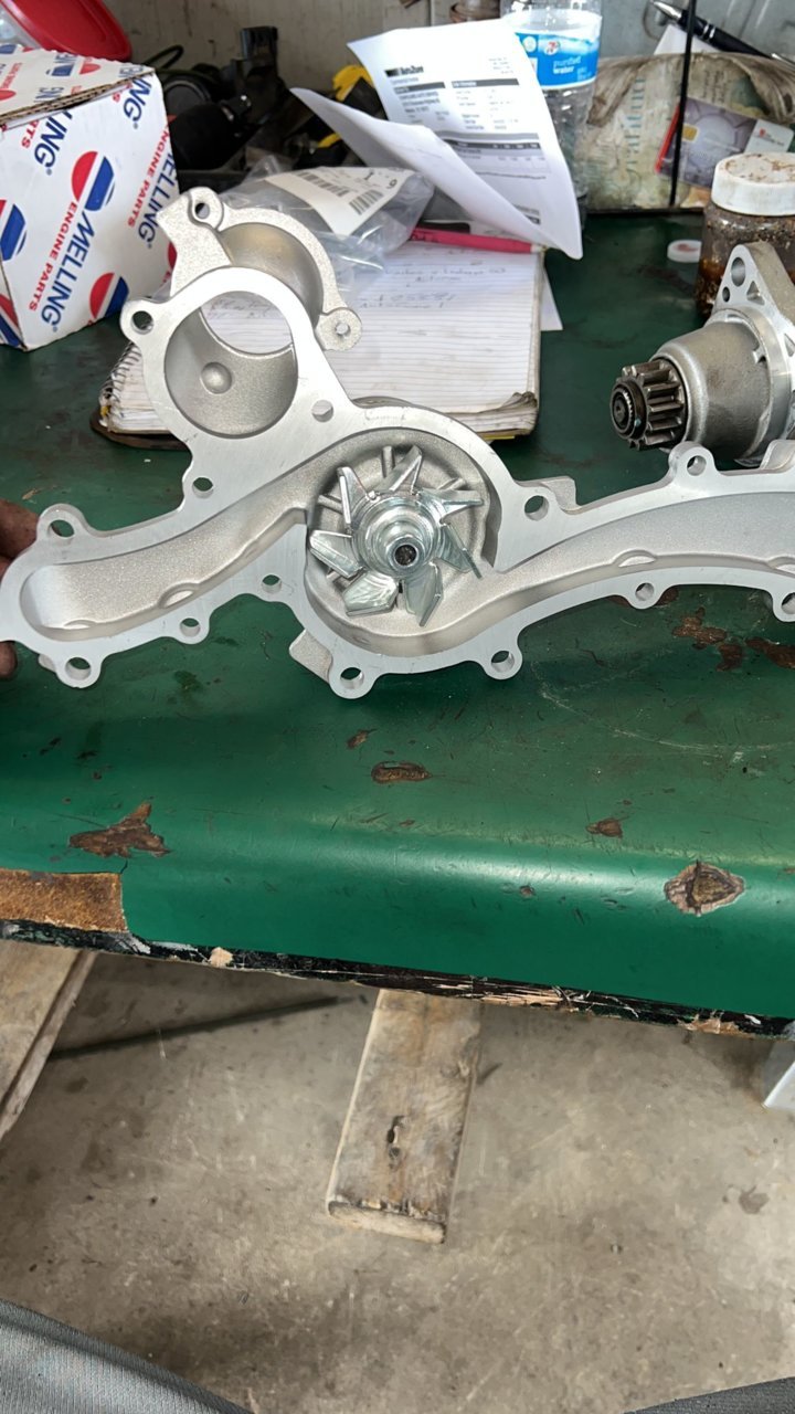

    Radiator replaced, still doing the same thing. He’s going after the water pump next. First he’ll inspect and will decide to replace or not.
    lynyrd3 and Taco critter like this.
  10. Oct 4, 2022 at 11:46 AM
    #730
    ALI3N_123
    ALI3N_123 [OP] ( -_・)ᡕᠵ᠊ᡃ່࡚ࠢ࠘⸝່ࠡࠣ᠊߯᠆ࠣ࠘ᡁࠣ࠘᠊᠊ࠢ࠘
    Dec 10, 2017
    #238195
    26,897
    Eric
    Austin, Texas
    2021 Silver TuRD Squirt DCSB 4x4 // 2008 Black Rusty Shitbox DCSB PreRunner
    Blades inside the water pump are completely gone.
    Once that’s replaced, my only worry would be the damage done to the engine if it still overheats after the new water pump.

    Driving fairly fast ranging from 30-75 mph, truck maintained normal operating temp. I truly hope this is what was causing the problem. Thanks to everyone and especially @b_r_o for the accurate suggestions. :thumbsup:

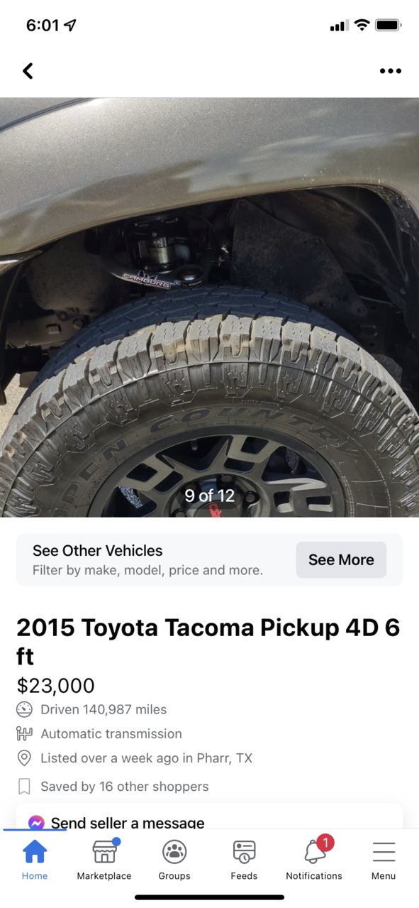

    Hmmmm. Supercharged, 33’s, ADS suspension, and 4x4, Limited, 140k, BUT it has front end damage on the CarFax…
