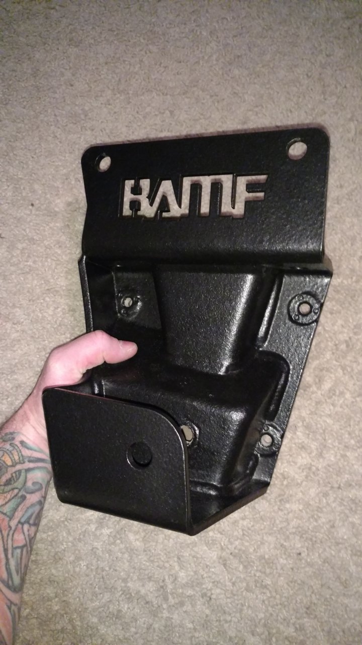

    Bolt on???
  3. Feb 11, 2019 at 9:57 AM
    #2083
    KENNY
    KENNY Well-Known Member
    Jan 13, 2011
    #49232
    6,602
    Yezzir
  4. Feb 11, 2019 at 9:58 AM
    #2084
    Bigdaddy4760
    Aug 6, 2017
    #226049
    77,337
    Maner
    Poolville Texas
    Easy, you got hardware?

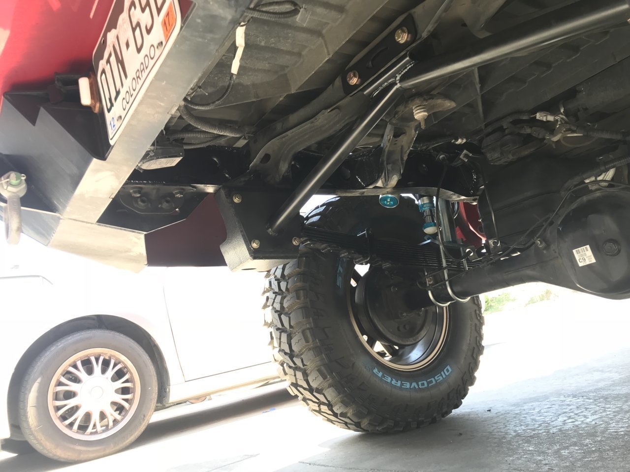

    @rjbiii Thanks to you an Alex I’m obsessed with this whole shock relocate an HD hanger thing...:annoyed:

    Oh they're already on.. Wanting to do something like this. Jerry is sending me over the plates that bolt to the hangers :thumbsup:

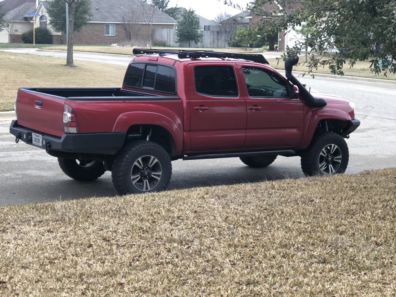

    Yea for the most part, feel like I’m selling my truck short though.
  15. Feb 11, 2019 at 10:26 AM
    #2095
    MattCowsmasher
    MattCowsmasher ( -_・)ᡕᠵ᠊ᡃ່࡚ࠢ࠘⸝່ࠡࠣ᠊߯᠆ࠣ࠘ᡁࠣ࠘᠊᠊ࠢ࠘
    Apr 7, 2017
    #215629
    48,693
    Temple, Tx
    O3 Rubicon wrangler
    You don’t know me to good then, I can never leave well enough alone.

    Clean from 20ft.

    Duuuuude. Check out Archive garage's shock relocate (this is what im getting). Allows you to put 14s under the bed without cutting through it. Relocations with 2.5" shocks require you to run 1.5" wheel spacers at a minimum (depending on tire backspacing) to clearance the shock at full stuff

    Well I got spacers up front now wth I’ll check it out.
