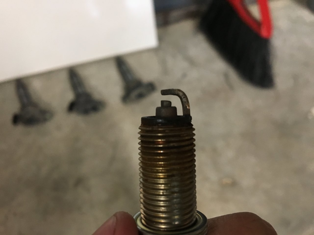

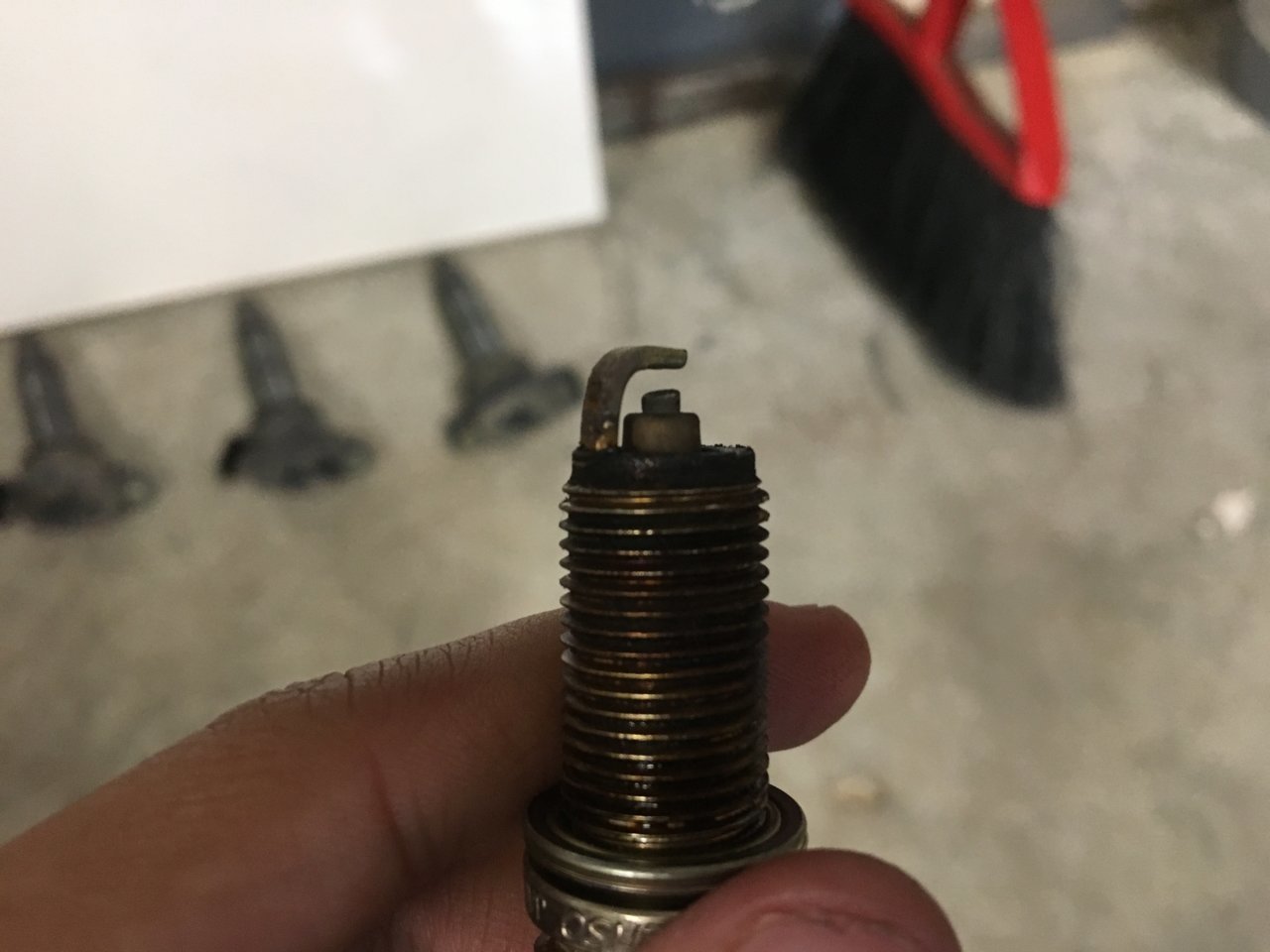

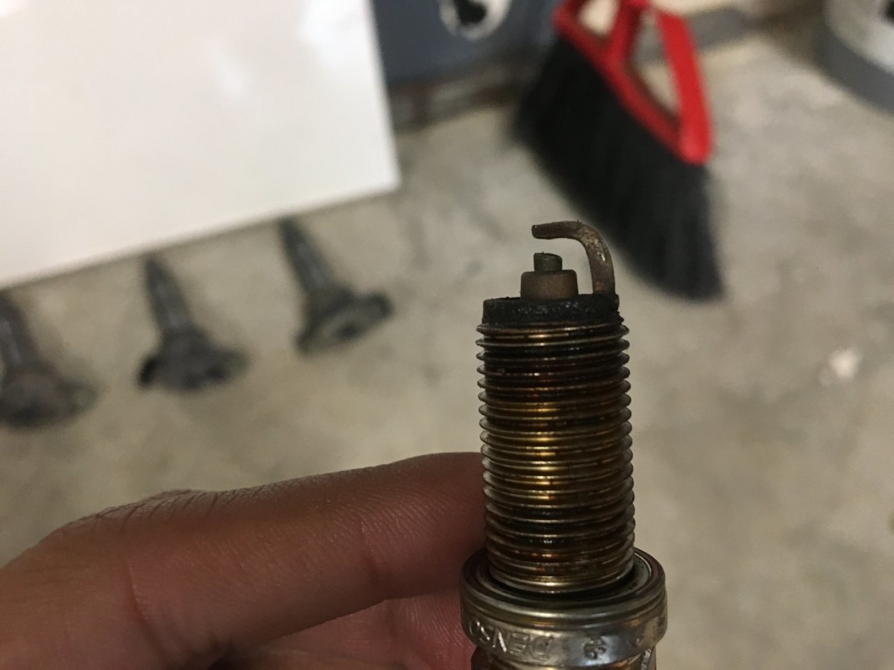

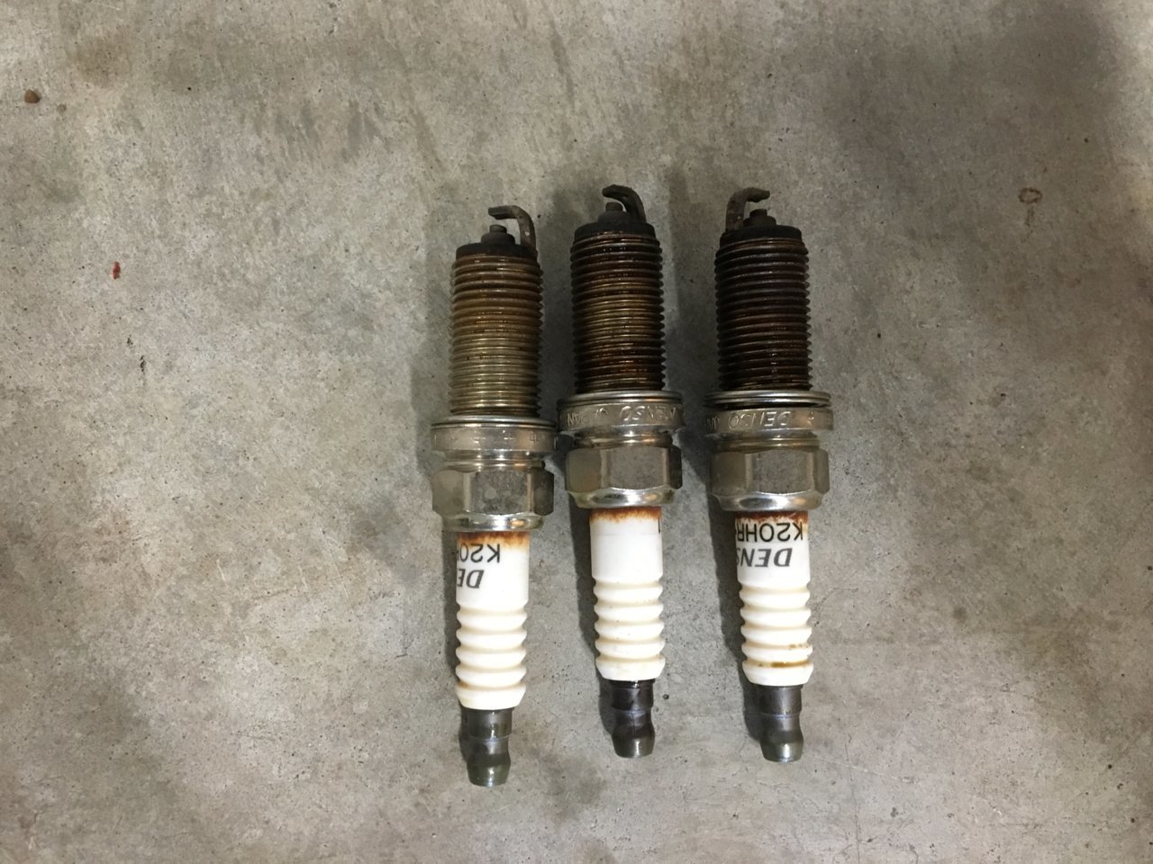

    Passenger side

    They don’t look that bad, how many miles?

    I think they're factory, if that's the case then they have 56,958

    They look great for the mileage

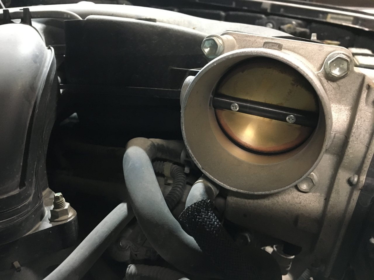

    After air filter, spark plugs, throttle body clean, and MAF clean, the truck feels smoother and starts up quicker. I love it

    Electrode is worn a little and the top is a little sooty, so slightly rich. Looks good for 60k miles, though.

    So I noticed that the passenger side were Denso and the driver side were NKG, is that normal from the factory?

    Yes

    What does the back side look like?

    I didn't take a picture, but everything was squeaky clean when we bolted everything back together
    It had just a little tiny bit on residue on both sides

    Those plugs look fine

    Pretty normal for a copper core plug, thats the old school plug design that has gotten er done for a long time. Toyota uses them in the 4.0 because they do the job and there's no reason to get fancy
