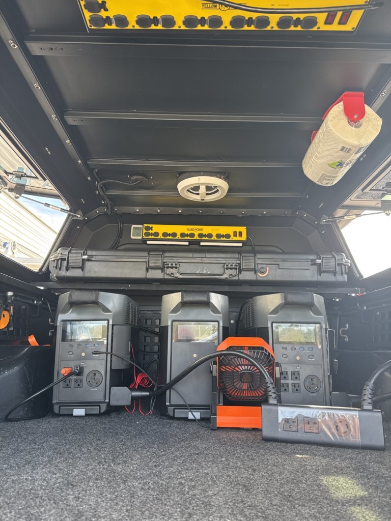

    This is where I’m at so far

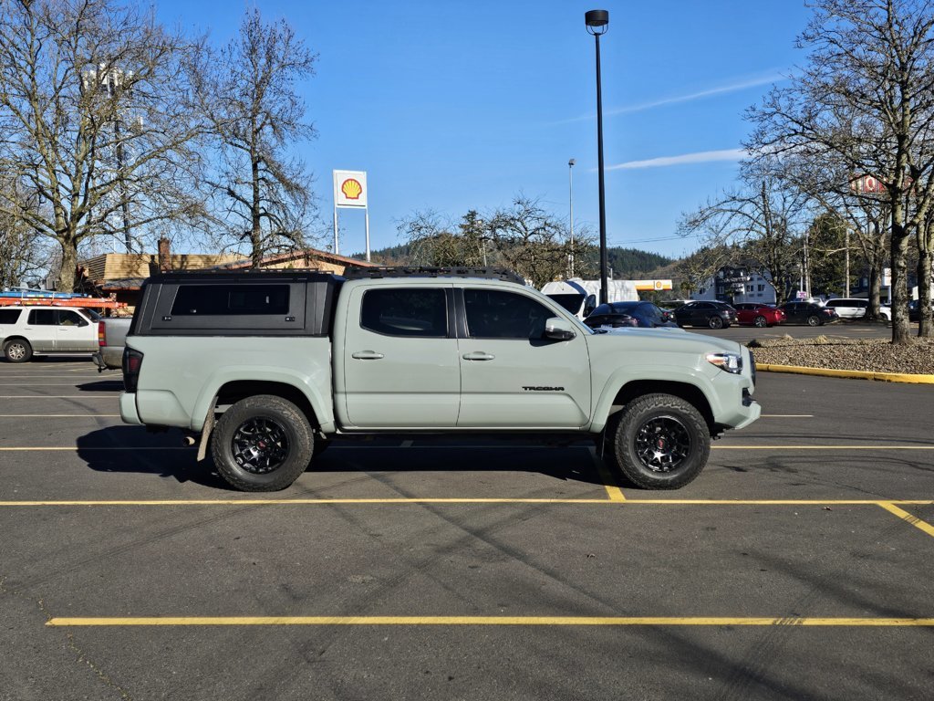

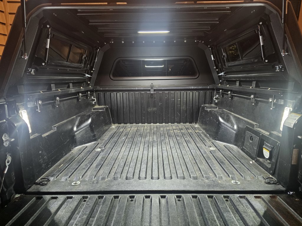

    Well I'm officially done. Wired the third brake light and a interior canopy light.
    The FBC harnesses were a lifesaver. Email him now and get your brake light and t harness harness for the canopy light. I think he is closing his shop and only selling remaining inventory.

    That looks fantastic. How did you wire the 3rd brake light to the FBC harness? Please post pictures. My canopy came with white wire, brown wire and red wire. I connected the FBC harness to the red wire but I cannot get the 3rd brake light to work.
    Can you also post pictures of how you connected the interior light?

    Should be white wire is your ground which is the white wire on the harness. I would then try the brown wire and connect it to the pink wire on the harness.
    I'd try that first.

    Thank, I tried using the brown and connected the ground to the white wire on the camper and 3rd brake light is working now. I am only needing to connect the interior strip light.

    I used an FBC harness for this also. I believe it was called the t harness. This connected between the body harness and the bed lights and then gave me two wires to connect the interior light.
