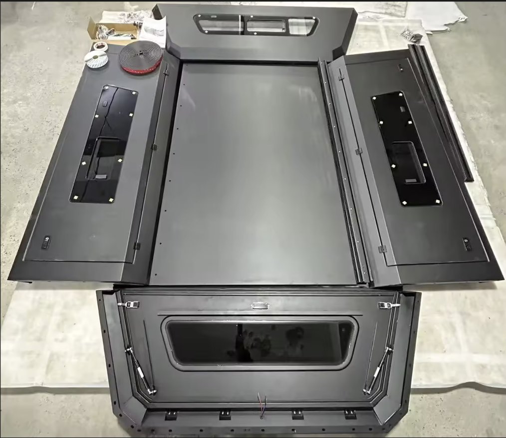

    Shell made it here in one piece!
    It looks pretty solid. I've got it bolted together and my brother in law is going to help me test fit it.
    Once I take it off, I'm going to remove all the bolts and then put it together using the double sided thicker tape (right?) and then the final picture is of the seal on the bottom. My F250 has 3-4" of bed rail, so I'm wondering if it's too small...really hoping to get this on and water tight.
    For the final step, I just use some masking tape and run some silicone in the 'joints' were the seal is going and then just wipe off the excess? I guess I could just test it and see if its water tight without the silicone...thoughts?

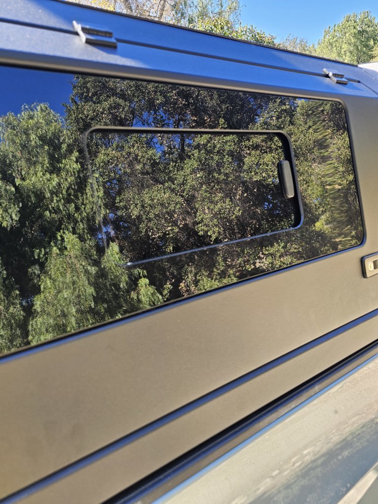

    Have you had any issues with the side sliding windows leaking water? By the way your truck looks great

    Yes, but only one of the sliding windows is leaking. I am currently not sure how to seal the sliding window.

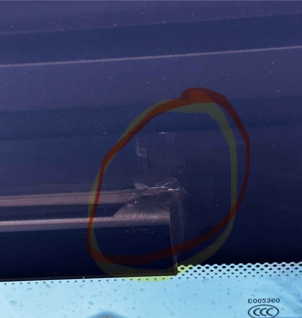

    If your sliding window is like rsi smartcap the window seal should be easily removed. One of mine leaked and I noticed a small slit at the bottom middle of the seal. I pulled itout and put that slit at the top and leak is gone. Just some food for thought.

    I will check it out. Do you have a picture of the top where put the slit? I wanted to see how you did it.

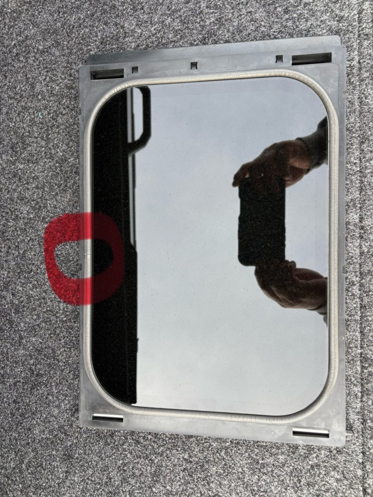

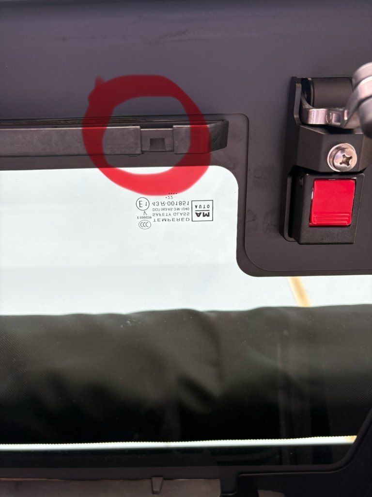

    Ok so heres my window you can see rsi had a molding clip that comes out and allows the window to be removed completely. Then theres a pic showing the slit in the window seal. The gray seal easily pulls out of the frame and if yours is the same just pull it out and spin it to the top and put it back in. This solved my leaking window. I suppose you could also put a dab of sealant on the slit too.

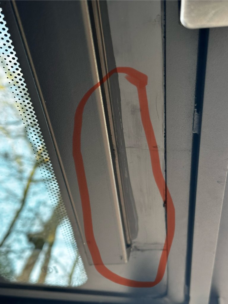

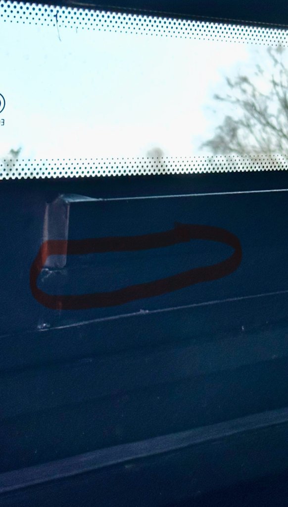

    Thanks. My sliding window is different from the rsi and it is leaking on the bottom left of the window.
