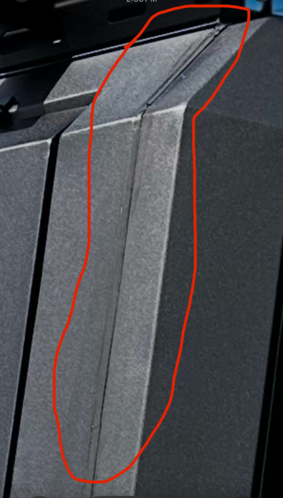

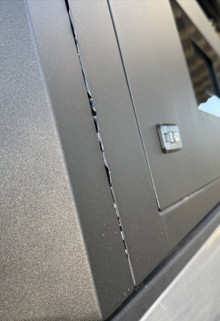

    Well, my topper leaks...pretty sure it's my fault (plus lack of actual directions...) Anyway, not really upset - seems that the Smartcaps leak too.
    I'm thinking about taking an exacto knife and trimming the rubbery-sealant that squished out and adding a bead of black silicone over top. They supplied some silicone and I didn't use it yet because I didn't want to make a big mess and was hoping it wouldn't be necessary. Also, this sealant did not squish in with any uniformity. I'm really hoping I don't have to take this thing all the way back apart.
    My plan:
    1. Trim excessive rubbery sealant
    2. Apply tape to both sides of gap
    3. Apply bead of black silicone to fill in the gap
    4. Pray it is water tight!

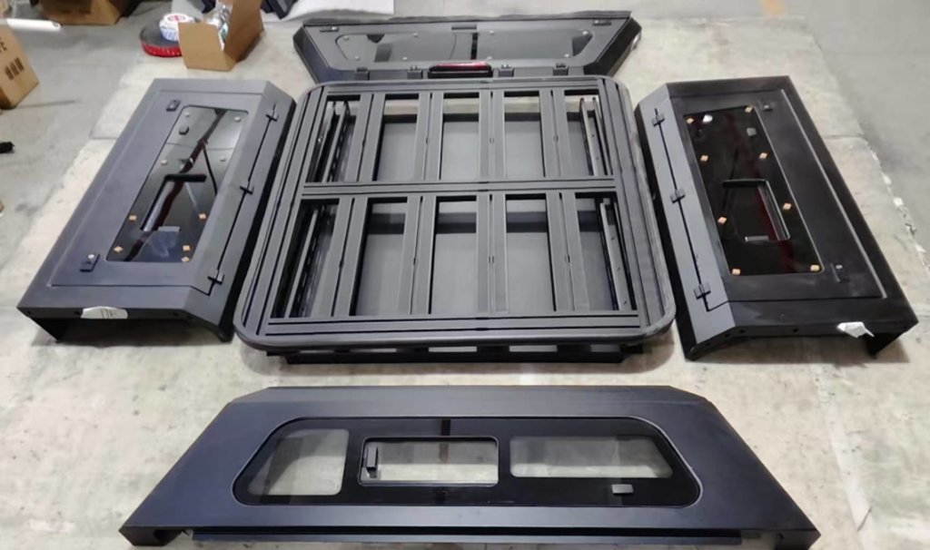

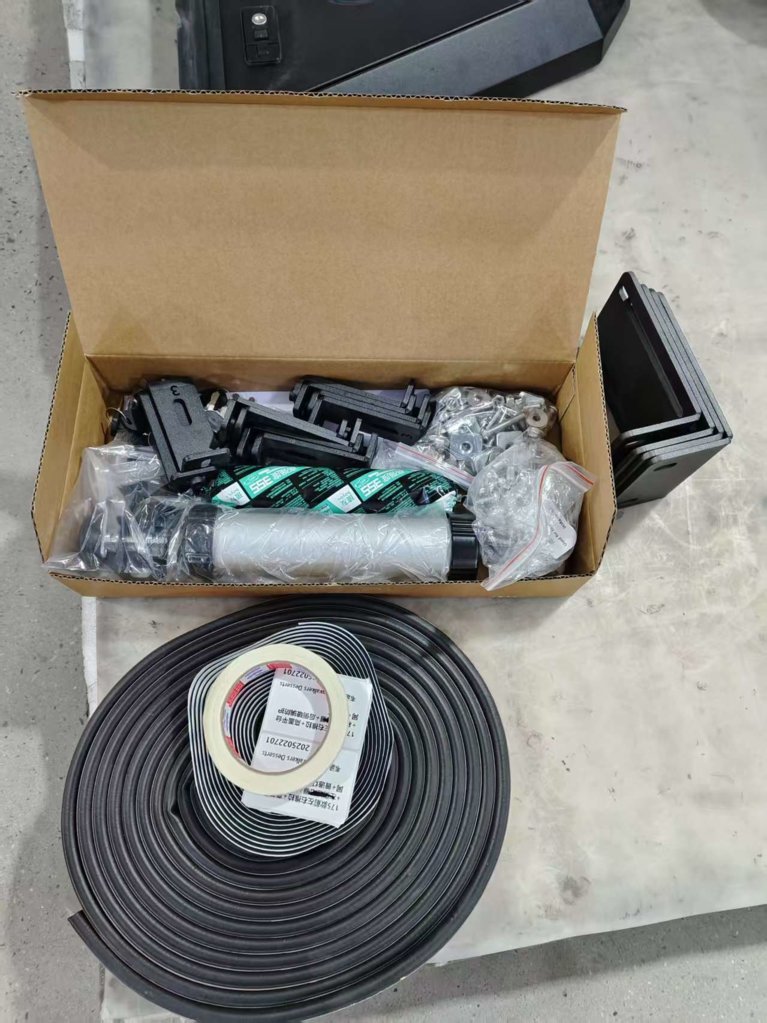

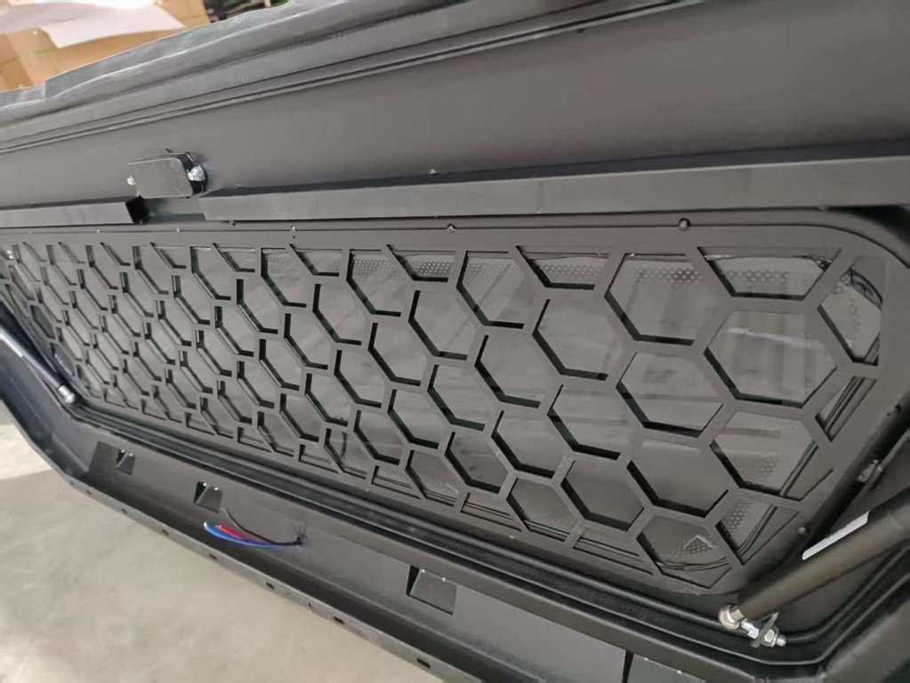

    Here's the update on mine: they sent me these images prior to shipping. I'm pretty optimistic and excited for it.
