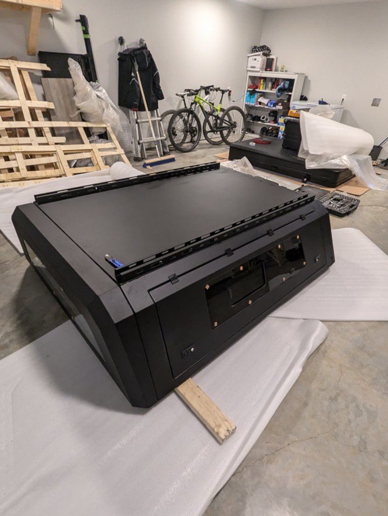

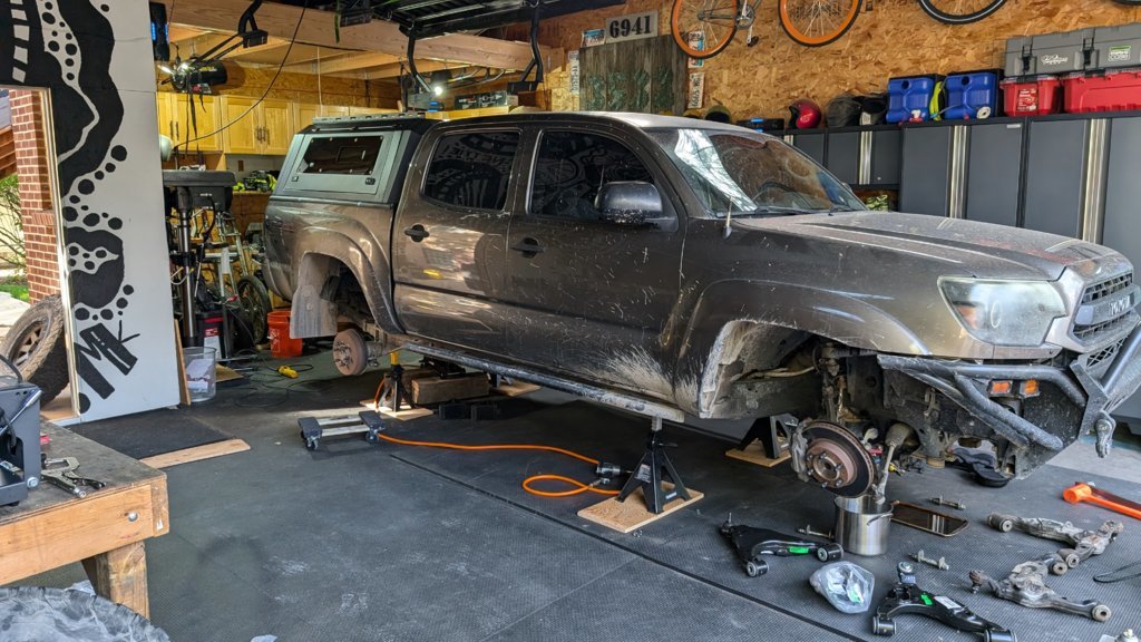

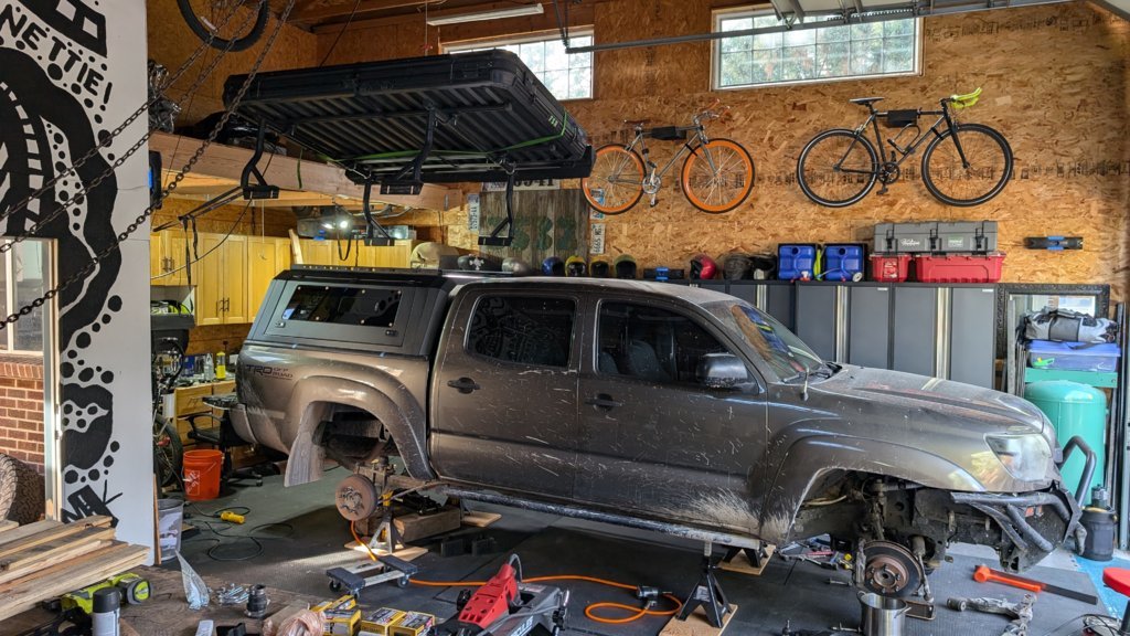

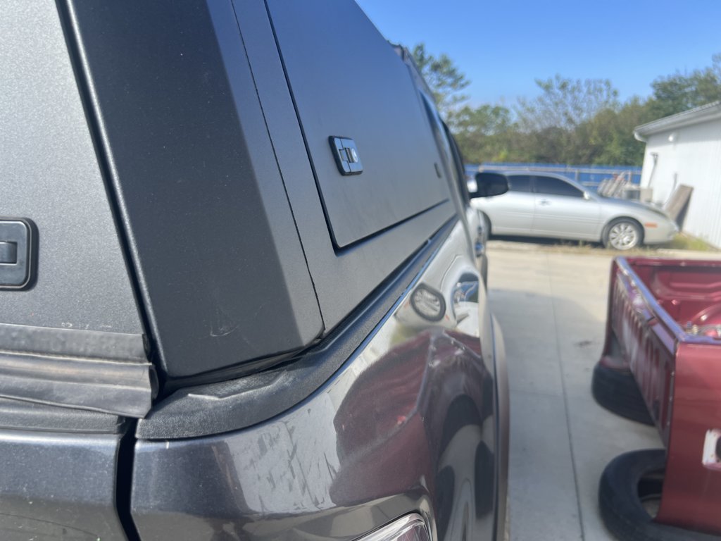

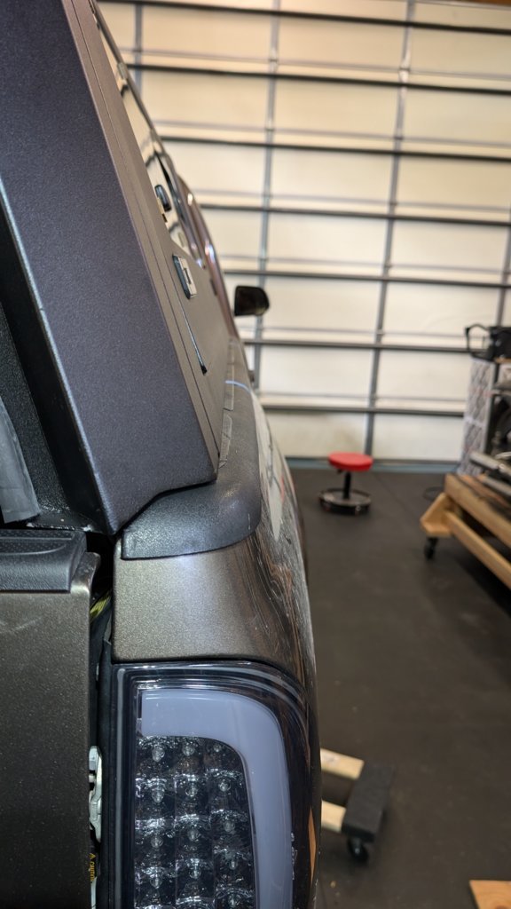

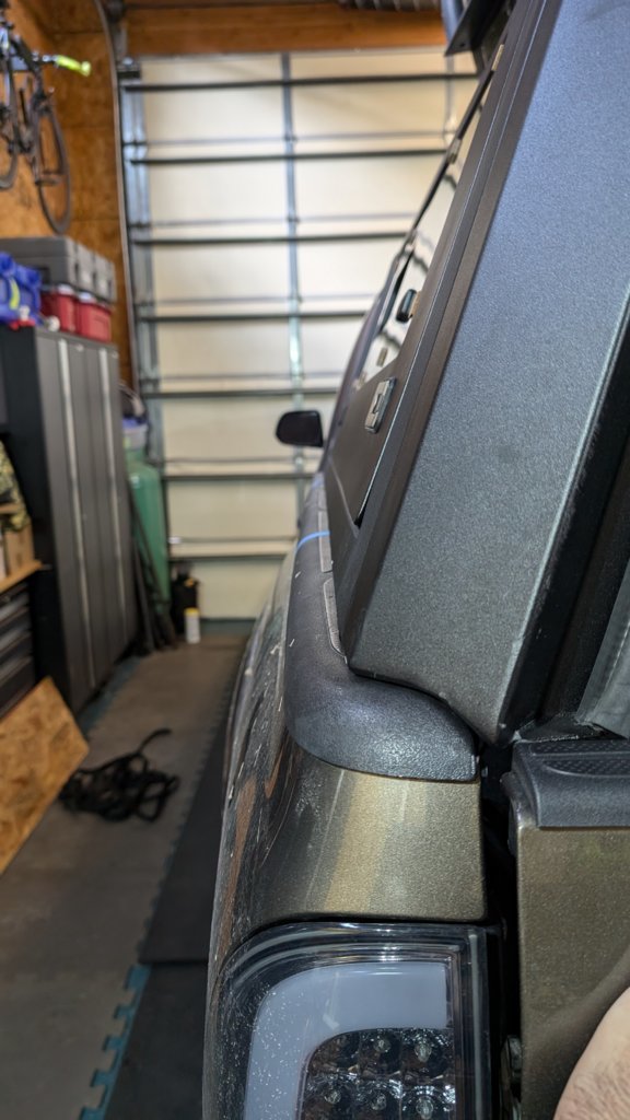

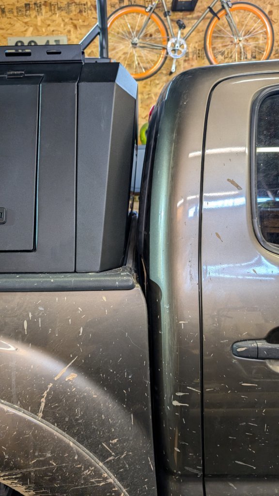

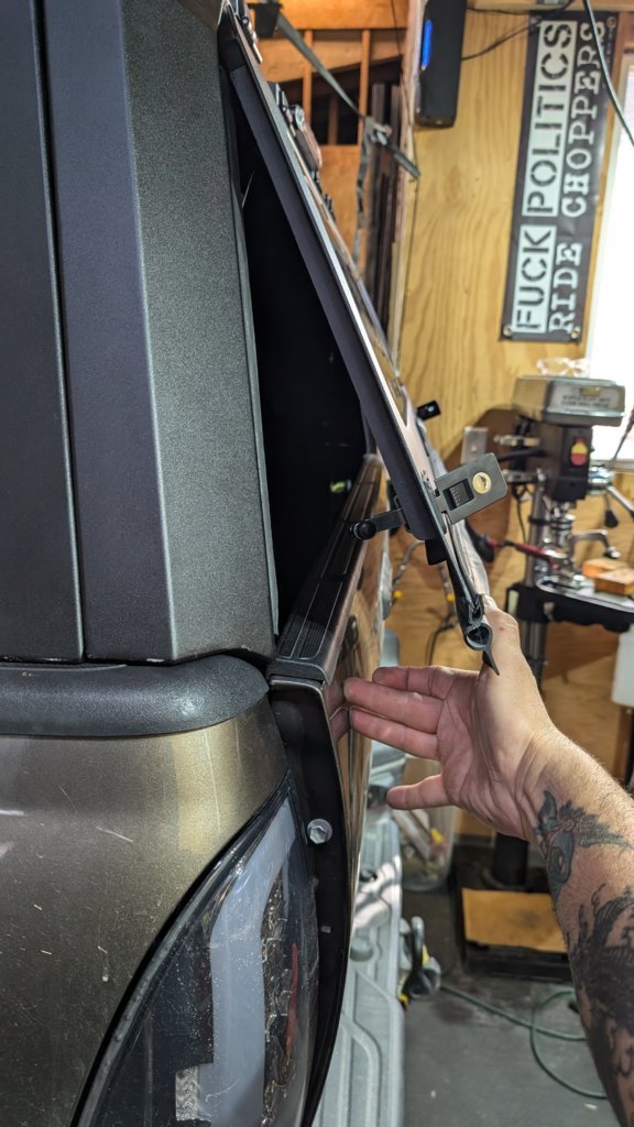

    2nd gen 2013 Tacoma short bed Alibaba bed cap, camper shell, bed cover ordering and fitment experience.
    https://m.alibaba.com/x/AxcGj2?ck=pdp
    To purchase this cap I randomly picked a seller on Alibaba (see link above) and started chatting with them. Every pic they had was caps on 3rd gens. I asked if they had a version that would fit my 2013 Tacoma short bed. They assured me they had one that would fit. Me being me and not trusting them I proceeded to send a ton of pictures with measurements of my bed sides and cab height, width, etc. They responded confirming they had something that would work but would have to manufacturer it. So, I ordered and waited, and of course, messenged them like once a week.
    4/17/2024 purchase made (used credit card through PayPal so I was double protected in the event never showed up)
    7/1/2024 supplier messaged saying goods were at wearhouse prepared to ship out
    8/20/2024 freight company called to schedule drop off
    8/21/2024 freight delivered to my residential address
    Well, per usual I have about 5 projects going on at the same time in the shop but had just enough room to slide this bad boy up in place to test fit. I am pretty happy with the fit.
    The annoying and now turned brain teaser puzzle is taking it apart 1 piece at a time while still on the truck to seal all the joints and get all the hardware installed. I just threw in a few bolts here and there to get it together for a test fit. However it was enough of a pain to get on there due to the tight quarters, the truck being on Jack stands, my hoist currently holding my tent and no other helping hands to lift that I'm NOT going to take it off again.
    I do plan on trimming the lower lip off the front cab side panel so that I can adjust the whole cap forward about 3/4" so it fits a bit better towards the cab (I think I saw some YouTube about this on one of the Bynd4x4 caps). Also as it sits the tailgate is a bit snug to get closed. I'm sure the tailgate would close easier if I actually had the double bulb seal in place, but it will definitely close if the cap is forward a bit.
    I will try and update as I go!!PXL_20240926_220213436.jpg PXL_20240926_220202028.jpg PXL_20240926_223431494.jpg PXL_20240926_223446491.jpg PXL_20240926_223454015.jpg PXL_20240926_223532385.jpg

    Looks great! The bulb seal underneath will solve the tailgate issue. Mine wouldn’t shut when I test fit it but that extra 1/4”-3/8” made all the difference.

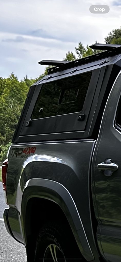

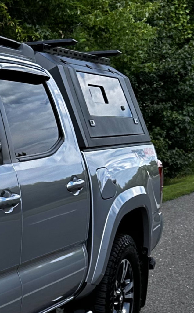

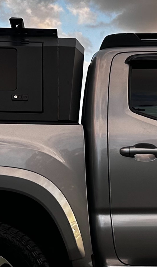

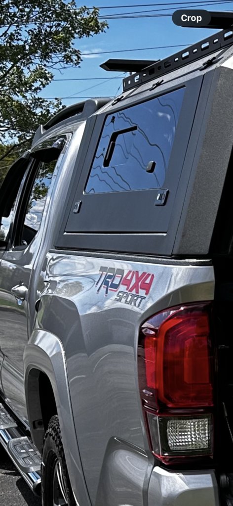

    Here are pictures from my truck. I think it is almost flushed. I am very happy with my purchase.

    Not sure I like the edge left between topper and bed. I would think they should be about .5-.75 longer and at least that wider per side. They do look decent and for the price maybe hard to beat. Wonder how much load they can take on top.

    I agree the sizing is just a touch off. But once I got the bulb seal and everything tightened up I think it will be enough for me. Especially for the price. This one is aluminum, I believe it's got like 400-450 dynamic load rating.

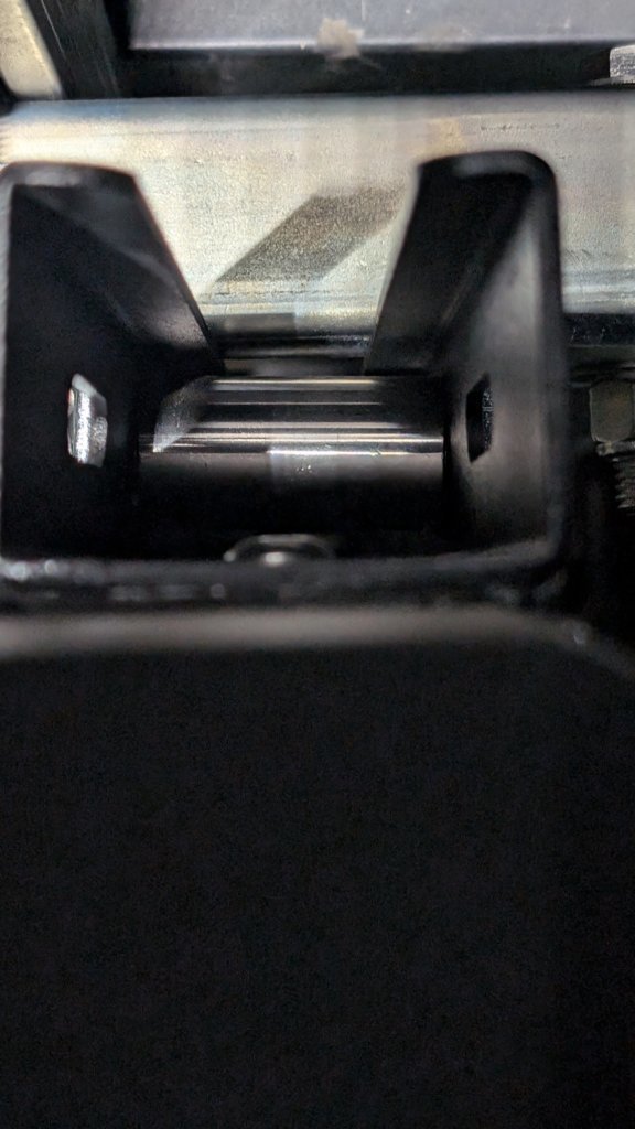

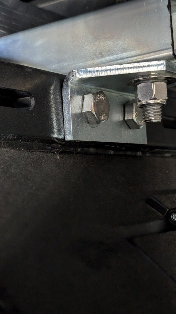

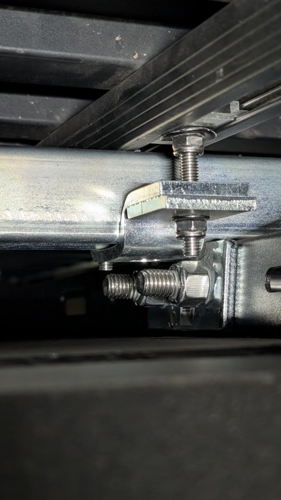

    Here's how I set mine up. All unistrut parts. Very stout and probably overkill. Can get everything from big box store except for the brackets (link below) I couldn't find anywhere.
    https://www.amazon.com/gp/aw/d/B0BN1V5WYQ?ref=ppx_pop_mob_b_asin_title
