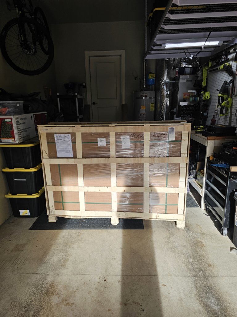

    Received text 12/18 from a shipping company and confirmed delivery for 12/23.

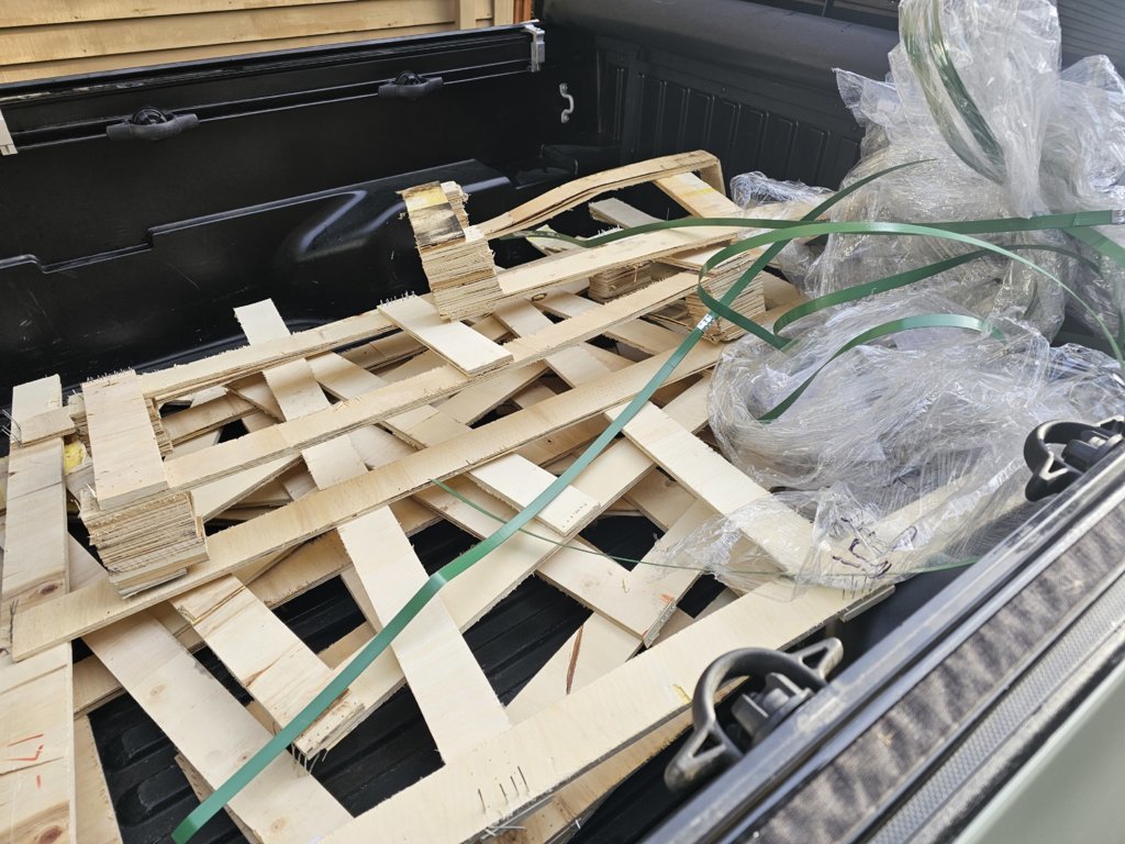

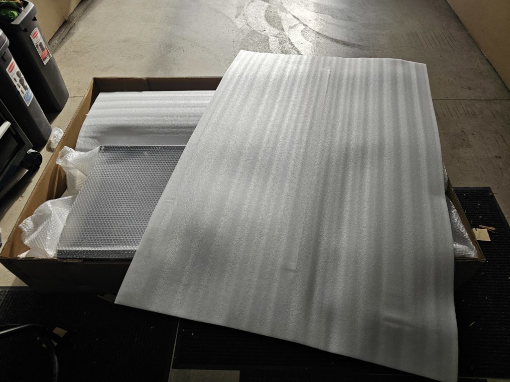

    Delivered on 12/23. Props to R+L carriers. The online tracking the night before said it would be delivered at 10:35am and he showed up at 10:33am. I removed the box from the wooden crate and then removed everything from the box and packaging. This thing was bullet proof! I'm impressed with how they packaged it. Lots of foam and bubble wrap.l and the shipping box was super thick. I will be putting this together on Friday, 12/27.

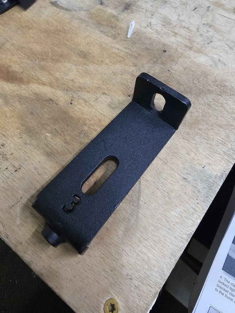

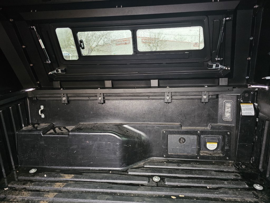

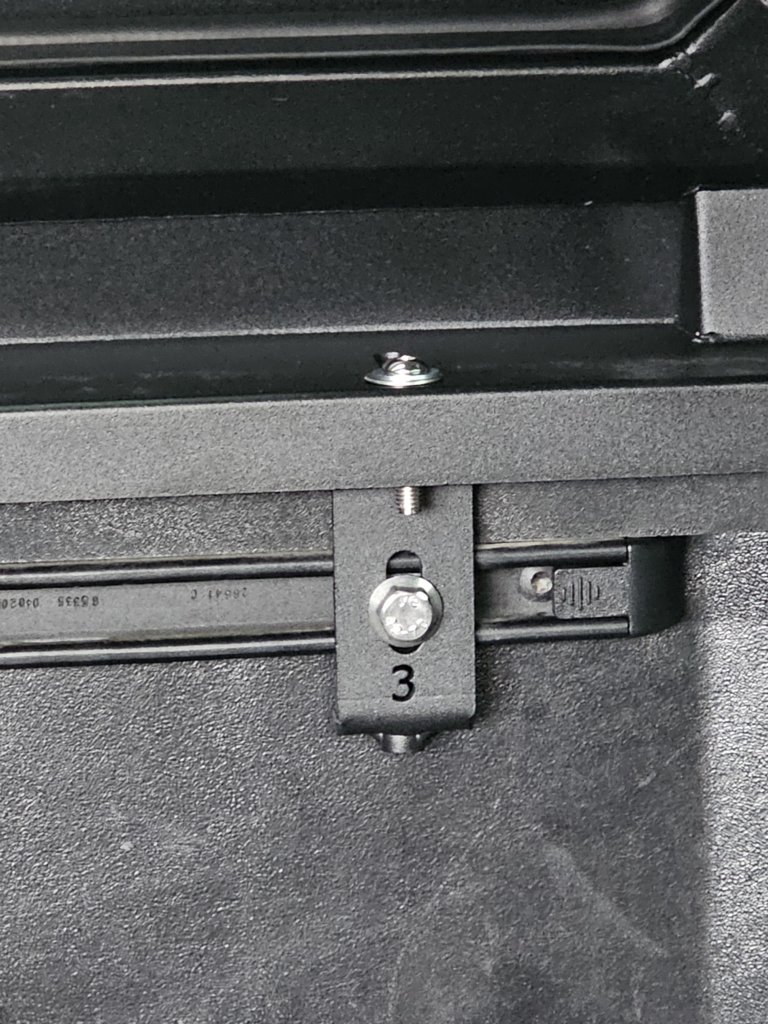

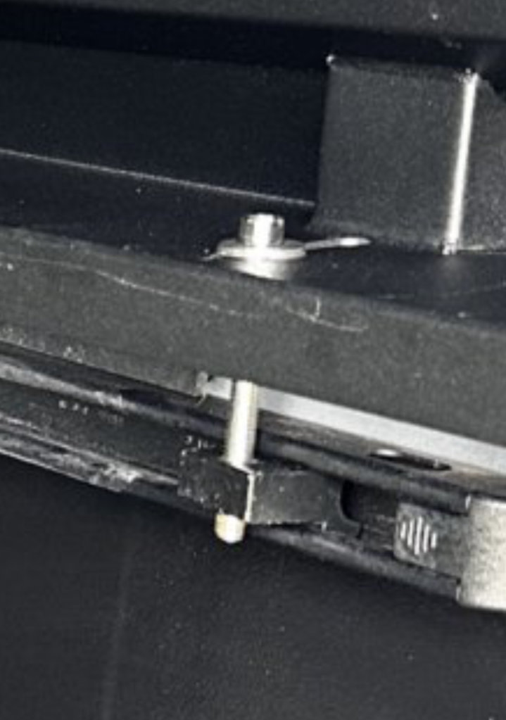

    Can you post a picture or two of the bed clamp installed?

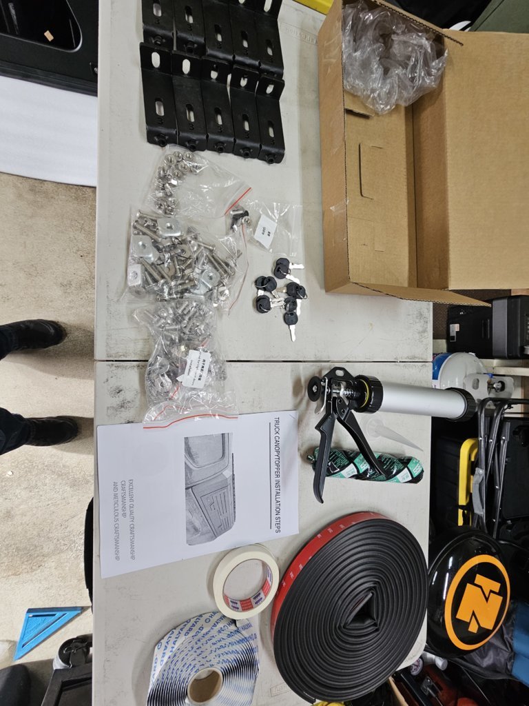

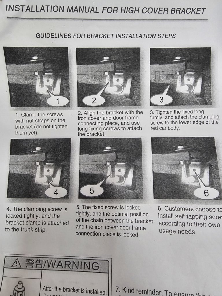

    Those instructions are garbage. I used the black brackets along with the long Allen head screws to secure it to the track. I could only do 4 on each side as I was missing hardware. I might stop by the hardware store tomorrow and buy some better bolts for that.

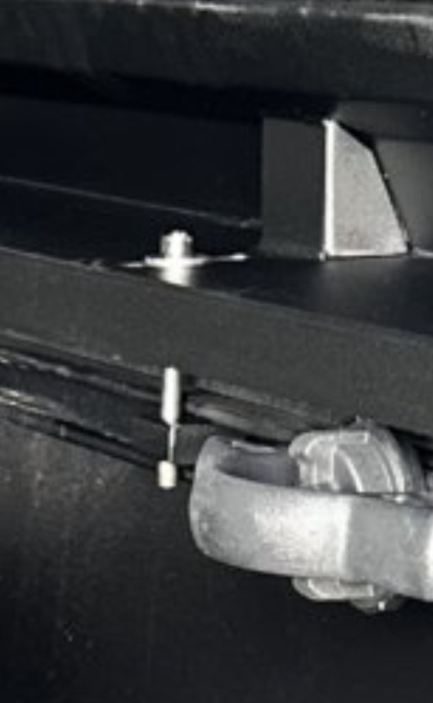

    I am not sure if all are issuing the same hardware for these types of camper shells. I was able to install 6 or 3 on each side. Here are the example.

    Hmm, mine is different than yours.

    Mine did not come with install instructions. I had to figure out which one to use :( to clamp the camper.
