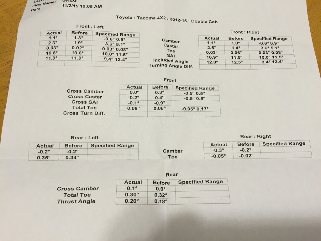

    1. 2016 SR5 4x2 DSCB
    2. Bilstein 5100s at 1.75 setting. No height changing mods in the rear.
    3. See below. This was done at Crown Toyota in Ontario.
    4. Slightly out of camber/caster, but drives straight as an arrow and perfectly fine. We like the stance of 1.75 so we're keeping that height and upgrading to SPC UCAs.

    Thanks Dean724! I think your numbers are the only ones I have run across on the site. Great looking SR5 btw.
    I'm not familiar whether the 12-15 tacoma had different ranges, but my '05 caster range was around 1.2-2.7. Do you know if they modified the caster range for some reason? Seems a bit high.

    Thanks much, it's been a fun work in progress as it's been for all of us. :thumbsup:
    I also thought the caster range was pretty high. Not sure what's going on there.
