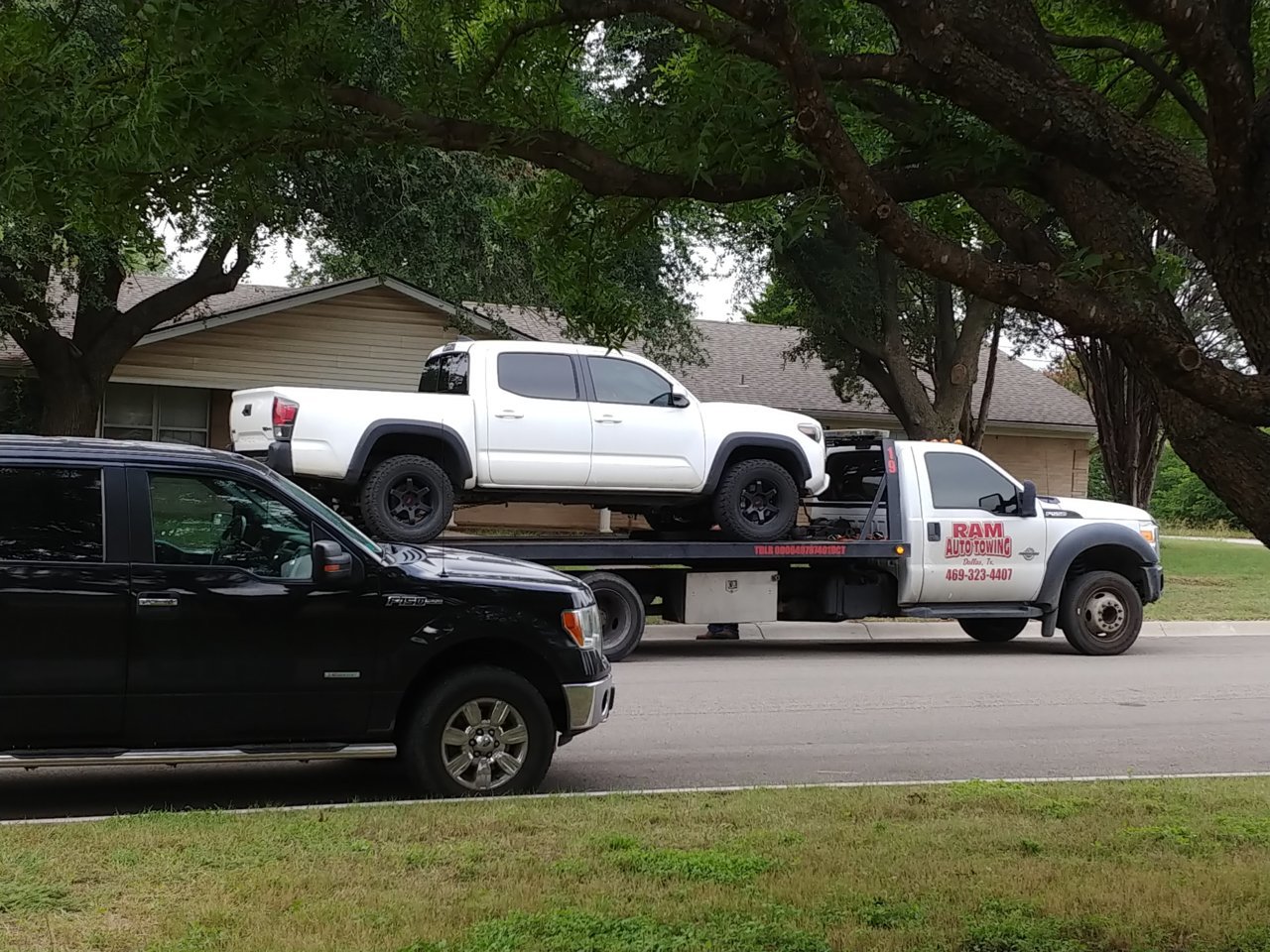

    well, as of about 15 minutes ago, here's where I'm at... towing to Tandem OR.

    yeah it's almost safe to drive but not so much on the highway. that and i'm slammed at work and just need to get it out there.
    i've had it at 3 shops so far. it's had 5 alignments and 4 tire rotations. and as of yesterday the metallic sound happened again and the 5th alignment was lost and now it's a total mess all over again.
    this is actually quite an interesting story, especially for folks with SPC UCA's. i have a tentative diagnosis, but it needs validation by getting this all corrected. Tandem will deal with it next week, and if the planned fix is correct then I'll share the whole story. this has been a huge PITA to figure out.
