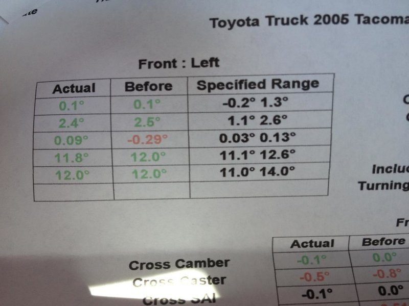

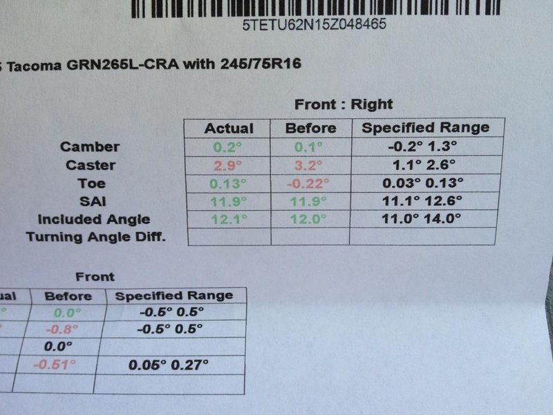

    So, I just got new tires and alignment.
    They said they couldn't get my passenger side caster in spec.
    (see pics)
    They wouldn't adjust my coilovers and asked me to do it and come back.
    What I need to know is what way do I adjust?
    seems like it would be up , but then looking and measuring, my passenger side is 1/4" higher.
    So, maybe lowering it would get me back into spec?
    not sure

    2.9 Is fine

    +1
    Yup.... 2.9 is perfectly fine.

    And having a higher caster on the right is going to offset the slight right pull we notice from the crowning on the roads. Caster, in itself, will not affect tire wear.

    I also raised my icons a turn to get the caster in spec, initial numbers say 2.7 but they want to get the bad tire replaced before adjusting it.
