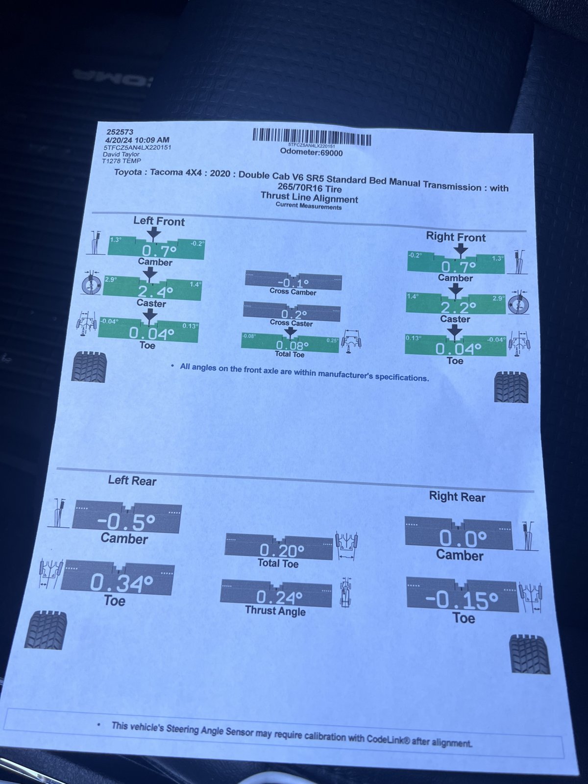

    Installed 6112 (10/8) /5160 setup last night with icon rxt stage 1. I marked and reset cams to where they were prior to ripping everything apart. Took it in for an alignment this morning. Said they didn’t adjust anything and everything’s good to go. Just straightened my steering wheel out and sent me on my way, no charge.
    How do these numbers look?

    Yeah that looks pretty darn good. Nice job!

    Anything I should have them adjust? Getting some wandering and slight pulling to the left mostly. Rechecked the torque on everything and it’s all good to go. But definitely doesn’t go straight lol. Also the front end feels like it’s floating rather than planted. Could that also be because my truck is now level rather than having the factory rake?

    right side caster +0.5 degrees to accomodate for crown.
    personally i want caster as high as possible, it pushes the tires forward and away from teh cab mount so if i want to go bigger tires i wont need a CMC it also is stable at higher speeds,.
