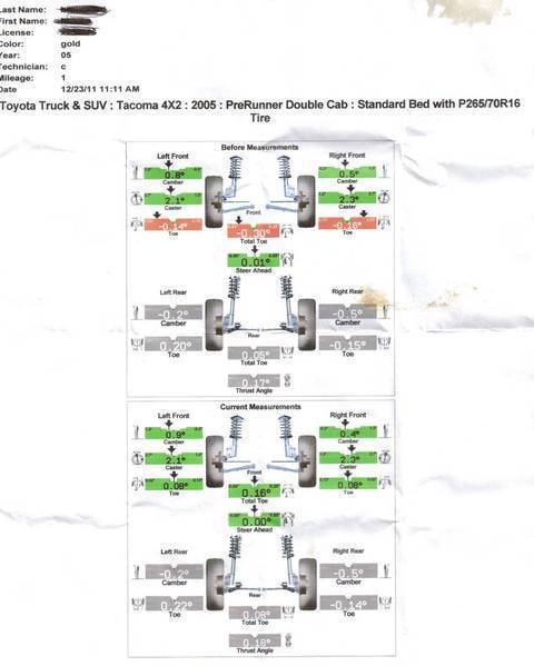

    After Changing my suspension with eibech/5100. i went to get my 05' pre-runner aligned at a local tire shop. i asked for a diagram of what they did so i could get some advice on TW. Im pretty sure the place i went to used the factory specs when aligning tires for factory tire sizes. i have 265/75/16 Wrangler authority A/T (that cheap wally world rubber)..still a badass tire...anyhow i wanted someone to take a look at the specs to give me advice or input on what they did!
    Also im running at 40 psi..I'd like thoughts on that as well. i havnt had the time to do the chalk method.

    Camber on the left side could be better. Both sides should be 0.3 or less ior else you may get premature wear on the outer edge of your tires.

    Looks like they only touched the Toe to bring into spec....which is fairly standard from places that advertise "$29.95 alignments".
