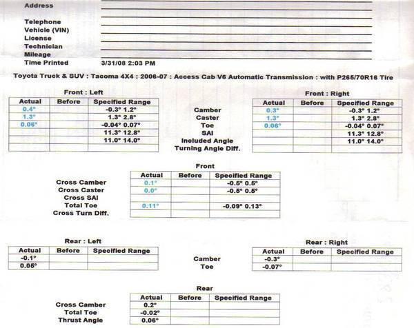

    My numbers are lower front and rear except for toe? Positive is toe in, right? Tracks good and I run the tires at 30# front and rear running light. I still plan to go up one tire size when the time comes.

    What is your camber and toe set at? Recommended tire pressure for these trucks is 32 psi.
    With those Caster #'s your truck should handle good given the Camber and toe is correct. I'm thinking that your toe might be off?

    Camber and toe are set to spec, see my alignment printout above. I have C-rated Revos, LT tires need higher pressure.

    Your Toe and your camber isn't very good.
    You might need UCA's.
    They may have gotten your Caster to what you requested, but in doing so, you lost the other readings.
    The IFS when you change one thing it affects the others. So to get all your alignment specs correct, you may need UCA's.
    Your toe on both sides need to be the same. slightly Toe-in would be better.
    And your Camber needs to be 0* or slightly neg. also.
    Then the Caster of 2.4* will work great!
    But all these things need to work together.
    Good Luck!

    Agreed, we'll see what the next alignment can do.

    I'm going to try and get a new alignment this afternoon, my taxi business buys all its fleet parts from a local Ford dealer and they have a very good alignment tech, the service manager will work with me and let me watch so I'm going to give them a shot.
    I'll post up specs and driving results as soon as I have them. Going to try and max out the Caster as close to 2.8* as we can get it, set Camber perfectly to 0*, and set Toe to maximum positive spec of +.07* toe in. Caster and Toe determine a vehicle's directional stability, maxing both of those adjustments should hopefully take care of my wandering problem. Driving to work this morning with the tires set at 38 front and rear, will take the long way on the freeway and make sure that feels as good as it did last night and also will check them with the chalk test in my office parking lot.
