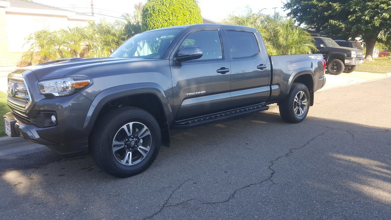

    Threads arent any fun without pictures!

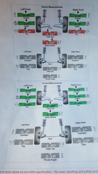

    Anyway took my truck to the dealership by my house this morning and they wanted $120 just to take a look at it! Left and took it to my friend and had him take a look and he told me everything looks okay. Went to another dealership and had them align it. Asked them to check u bolts as well because it seems like its a common problem and I hear some rattling when my rear end drops over a speed bump. Not sure if they did it or not, I can hop under there this weekend and double check. Easy for me to do. Got the car back and the alignment was much better but now instead of the wheel being turned to the right in order to go straight, its turned to the left... might leave it but if it bothers me ill drop it off and have them correct it. After all this, I decided I will take it easy with my truck. Not in the financial position to be blowing tons of money on it just yet and plus its brand new. Ill take my dirtbike out when I feel like cruising around the dessert. Thanks for the help everyone! At least it wasnt any serious damage :D
