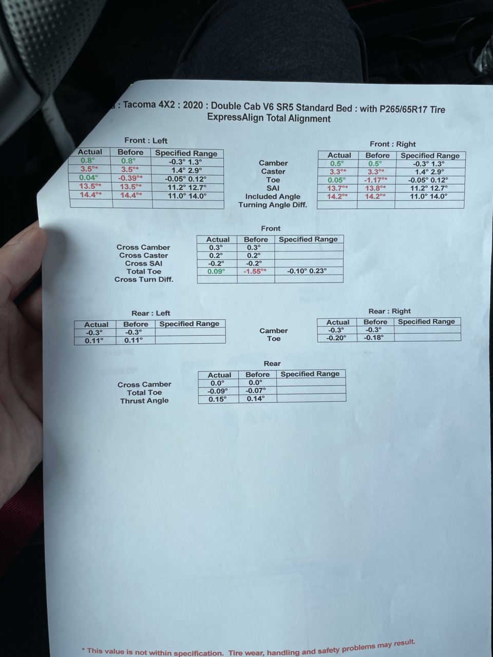

    I just got my 2021 Tacoma lifted with some King 2.5 and Camburg UCAs.
    I took the truck to get aligned and this is what I got. Any opinions/commments ?

    Not sure how your thread got overlooked, but I replied to your comment in the Magnetic Grey thread too. It doesn't look like the place you had your alignment done changed any of the specified ranges. Trying to revive this to get some input from other member with more experience and similar setups as you. Did you do anything to the rear too? I can only comment from what my lift specified the ranges should be and where my alignment currently sits, but hopefully someone can steer you in the right direction here. If it helps, I can upload my ranges but I don't think it will.

    Looks like a quick toe and go.

    Looks good to me. Your UCA's allow you to run that 3.5° of caster but threw your toe off a little so they adjusted that.

    Toe and go, but in reality, that is all you needed. The caster is high, but nothing wrong with 3.5 degrees as long as you don't rub. Higher caster is harder on suspension parts, but with a 3in lift, caster will be the least of your problems down the road.

    In the rear I got aal with the king shocks in the rear

    0 camber 3 - 4 caster 0 toe
