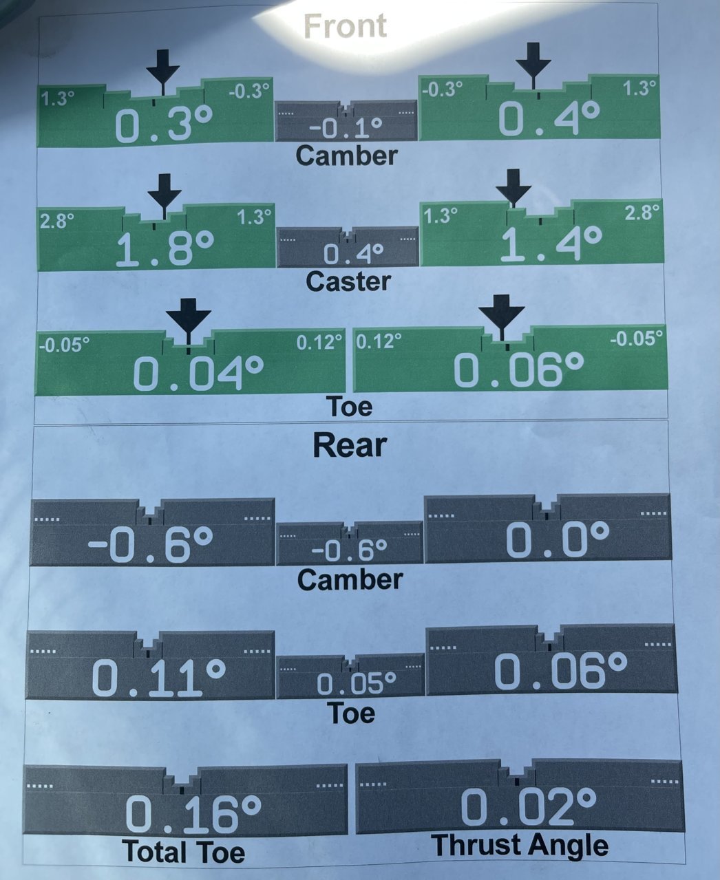

    Yeah I’m going to disagree. I align trucks several time a week at work. I regularly see truck with pulls right caused solely by incorrect cross caster. You do not want cross caster with the right side being the lower measurement. It will induce a pull right.
    But hey, if you guys want to speculate on possible other causes for a pull that only was present after an alignment change, with a printout showing an alignment with poor cross caster, go for it. Seems like a waste of everyone’s time to me.

    Stop trying to be a know it all.
    The OP is saying its going right, the alignment confirms it.
    1 degree of cross caster isn't a pull, its a drastic problem when its under 2 degrees. Undriveable.
    0.4 doesnt look like a lot, but with these trucks the closer to zero, the closer it is to being a shopping cart.
    I don't let anyone leave with less than 1.6 degrees of caster. Even on cranked spacer lifts.

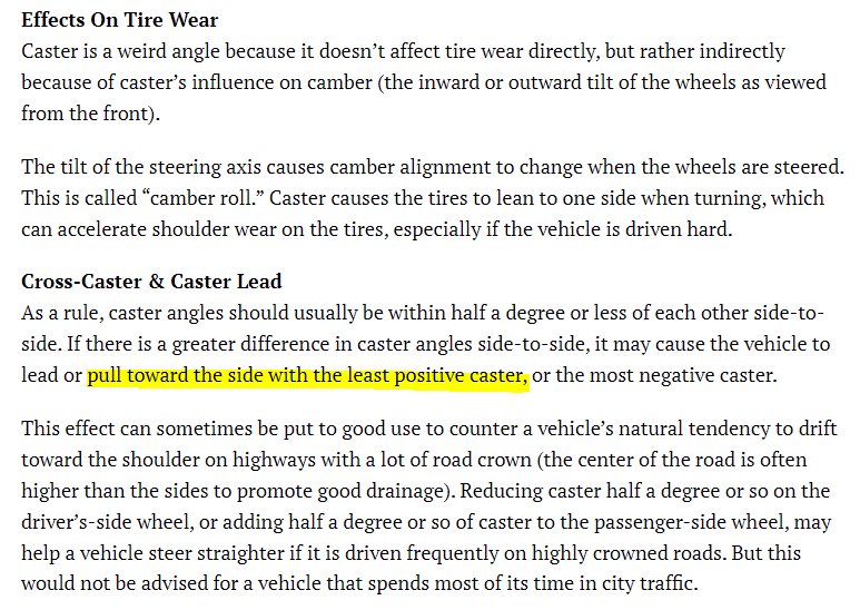

    As others have said, increase the caster on the right side and it will stop pulling to the right. If you have a divided highway where the passing line is sloped down to the left, see if it tracks straight in that lane. Compare that to a road that is flat or a lane that slopes to right and compare how it pulls.
    Truck will pull to the side with lower caster unless there is slope in the lane to counteract it.
    Also, higher caster will make the steering feel heavier if you like that weight. Low caster feels lighter but there is a tipping point where too low will make it feel unstable. On 2nd gens, most people felt like it needed at least 2 deg caster to feel good. I always preferred at least 3 deg caster.
    Wouldn't worry about camber much yet. At some point, too much camber will lead to faster tire wear on the edge but up to 0.5 should be ok most of the time. If you tend to hit corners hard, you may increased wear on edges of you tires. Camber as close to 0 as they can get while still hitting a reasonable caster is what you want. Caster and camber are linked so adjusting one changes the other and some techs don't like to spend enough time getting it right.
    https://www.underhoodservice.com/using-caster-to-properly-align-vehicles/

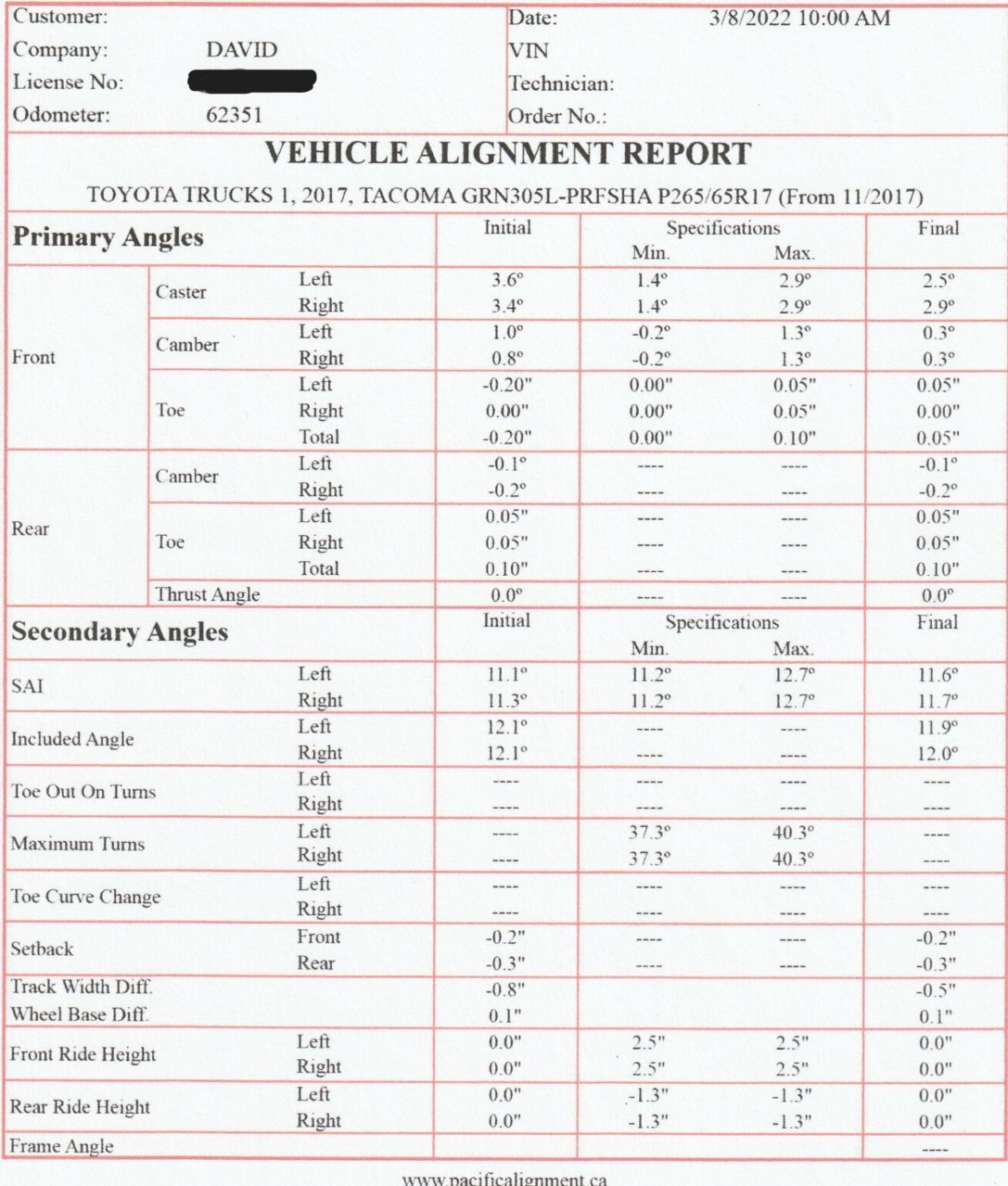

    Here @Komurphy I thought I would share my specs, I did an Eibach Pro-Truck Stage 2 lift with 1" blocks in the rear with 265/70R17's. So similar to yours... I do have Trail Tamer UCA's as well...
    2 things I notice different between yours and mine is that my Caster is a full degree higher than yours, this will increase the on centre feel, or the return to centre. There is a .4 degree split going to the left on mine, where yours is going to the right. I drove a 40 km round trip last night (the things we do for our children) and I carefully watched my steering. I drove on several off camber roads going different directions, I never experienced any pull, left or right, regardless of the camber of the road. Does the Caster split make a difference, maybe, but I should have seen that last night and did not... The higher Caster numbers help maintain a straight wheel I know that much.
    I will also note, my alignment was messed up for a week before I got my to the shop. I never experienced any pull.
    I would suggest you try the wheel swap, it is easy and quick, if that fails then return to the alignment shop. Talk to them and see if they have some insight into the issue. This thread might not help you much...

    Or take it back to the alignment shop and have them correct the caster split the truck has… This thread has plenty of useful info, you jus refuse to accept that you might not be correct on this.

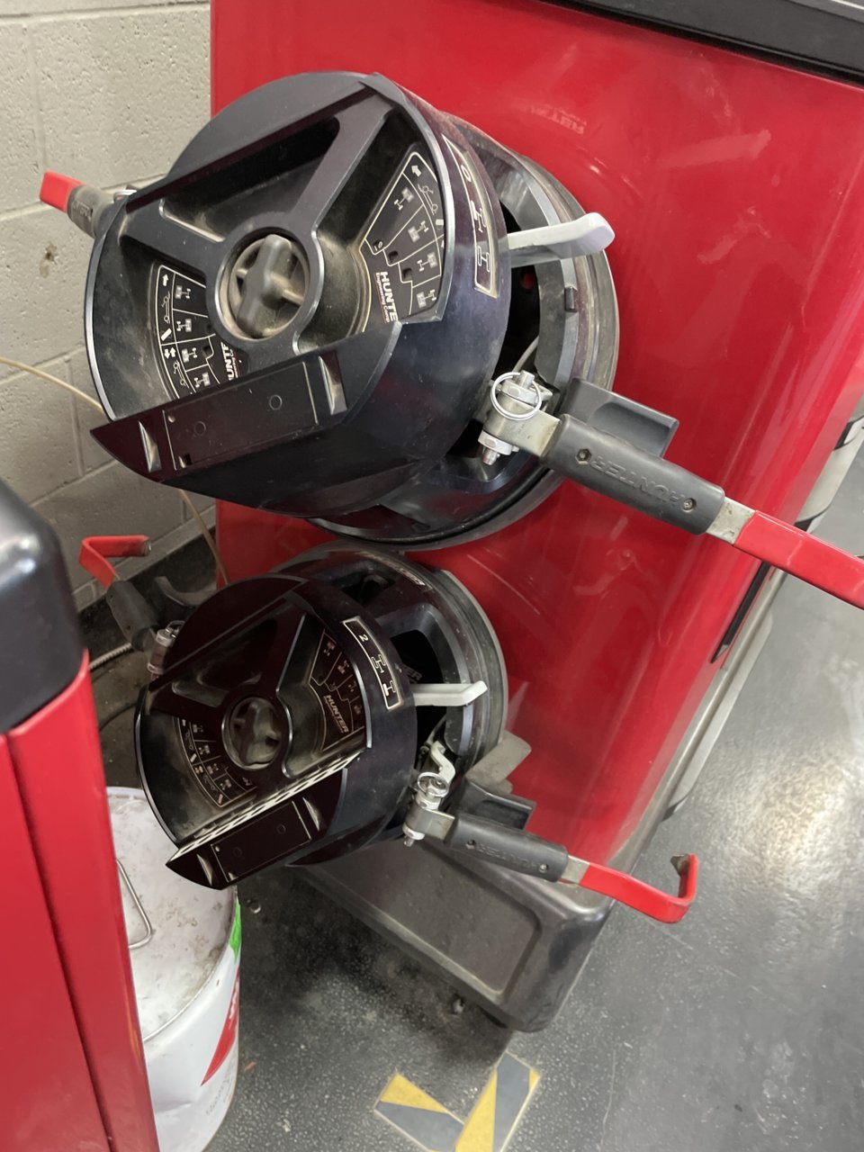

    The #1 thing I would see that caused incorrect caster/camber readings was binding slip plates and turnplates. Then to exacerbate the problem the overzealous tech takes them apart and loads them up with grease. Ugggggggg. Or drive on or off the turnplates without removing or setting the pins. I've seen techs slip right off the rack.
    #2 might be not getting the wheel sensor/target on the rim or tire correctly or not keeping the set pin tight or loose at the right time. Some of the machines tell you when this needs to happen.
    #3 The incorrect use of the brake pedal depressor and the steering wheel holder. Or no use at all. Big no no.
