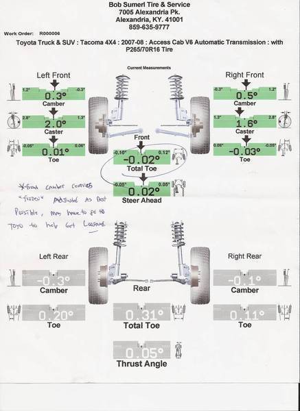

    At 1.75" of lift and caster set to 2.4, how are you guys not rubbing on at least one side? I'm trying to get my alignment sorted out. May have to try 2.6 driver side and 2.8 passenger side.

    The settings in the above posts are what everyone seems to be using. My truck is at the shop right now getting it done. My problem with the alignement is that the camber was noticably off. Both front wheel seemed to be really wearing on the outside. Other than that, my alignement was perfect, it tracked straight, stearing wheel was straight, didn't pull. I just hope that its the same way afterwards with the above specs.

    I just talked to the guys at the place doing the alignement, they told me they got it as close to the specs I gave them as they could, but 2 of the centrics(???) were frozen and couldn't be adjusted. If its not close, it will be going back to the stock configuration asap. I've had enough, and its not worth it anymore.

    This is what they gave me today. And now my steering wheel is crooked.

    They can center the steering by adjusting the Toe.

    Had my alignement done for the 5th time today. Final Tire Discounters was able to correct the alignement into specs. I was about to just give up and put it back to stock. Here is my sheet.
