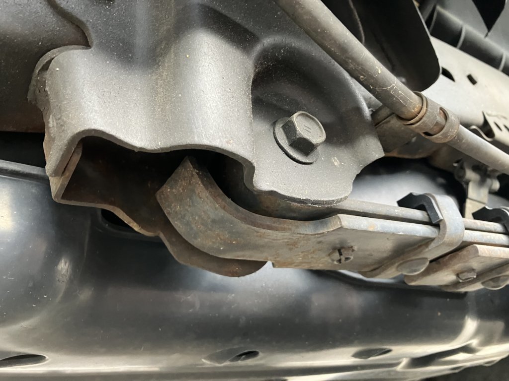

    Possibly.
    The "wrap" goes toward the front of the truck.
    The rear doesn't have a wrap.
    But.....OP didn't use oem springs.
    Anyways, here is mine.
    Wrap ( Installed in Front mount)

    I looked on their site.
    It looks like their springs are bent like the OEM springs.
    One end has the wrap, the other doesn't.
    The diagram with the dimension doesn't show the lengths to the center pin.
    Well, if it does, the center pin is not picture.
    It just shows the same measurement to the "center" of the diagram. (I'd like to see the pin for reference)
