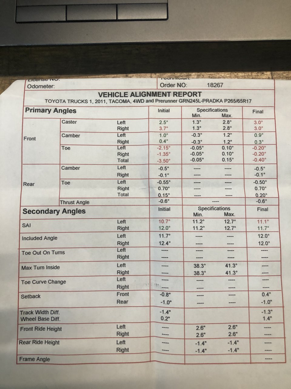

    Just picked the truck up. I probably wont be using this shop again. They kind of developed an attitude as soon as I asked about doing 3-4deg of caster. The truck drives ok, and the fender flares rub a little when I turn, but I’m mostly worried about tire wear. What’s up with that toe?44F0ECA5-0CC0-4974-96F8-4799708E11B0.jpg

    You can account for the crown of the road by offsetting with caster or camber. If both are dead on even you will feel everything in the road and it will want to drift a little on you. It looks like they accounted for your with camber since you requested the high caster of three degrees. Not sure what your UCA limitations are but everything looks good. Your TOE did not appear to brought into specs though. I would definitely want that fixed. If you don’t recalibrate your speedo for the larger tires as well then don’t forget that your wheel rotation cycles will be a little long as well.
