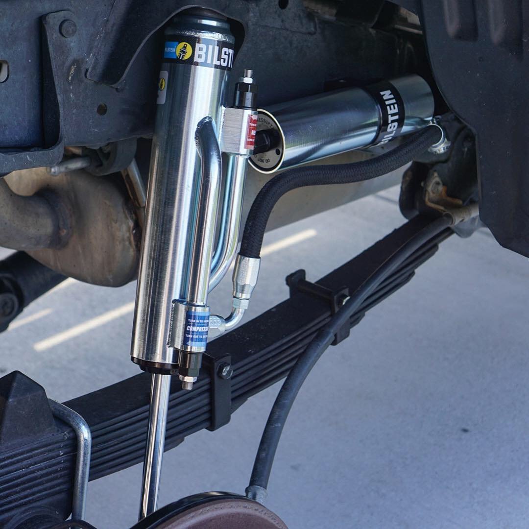

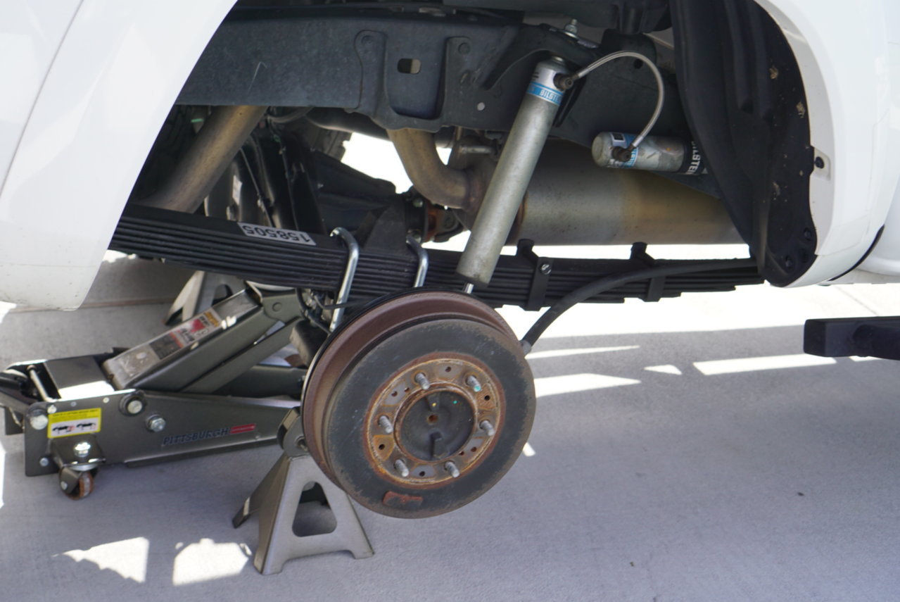

    Watch this video and it’s a piece of cake. The rear shock is literally one bolt at the bottom and a nut up top.
    Harbor freight tool will get the job done. You’d only have to invest in a torque wrench. I’m sure you can handle a 1 hour job if it’s just a shock. My resivoirs took a bit to install.
