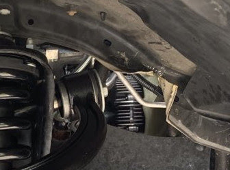

    Yes most people cut or pry out the inner fender lip to let the bolt pass through. Example: https://twstatic.net/attachments/ebdcef02-526c-4278-affc-f5e6b0e959b1-jpg.3342707/
    I avoided this by cutting off the bolt head in-situ with an angle grinder, and installing new $20 bolts with the head toward the rear. Even then driver's side required unbolting 3-4 fuel line brackets.

    General practice in aviation is to keep the bolt head higher in safety-critical applications, unless prevented by access. Toyota drops the cab onto the frame after the suspension is installed on the frame, so there's no consideration for access. Installing the bolt from the rear is better than doing this:
