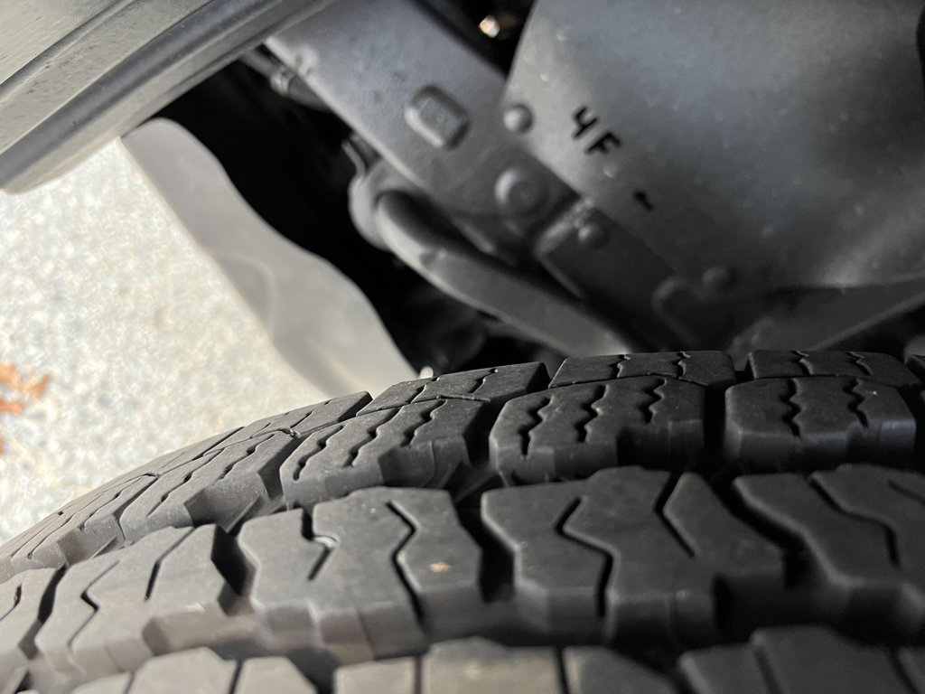

    Good to know about Firestone's lifetime alignment, I have one near me. Thanks for the tip! Pretty sure my tires are set to 32 psi, but I will double check. It looks like a bit of scalloping when I get right up on it, I had to pretty much put my face on the tire to see it. I popped a pic, but you can't really see it too well. There is no visible pattern when looking at the front of the tire, can only see it from the side. I was caught off guard when they told me I needed an alignment at the service appt. I wasn't expecting to do a damn thing outside of fun parts for a long time with the mileage I drive it. Figured I would post and you guys would have some solid advice. Thanks again for all the help! I'm really not sweating it now. Unless I see that pattern get worse or start getting vibrations, I will continue with the plan for an alignment when I slap some new rubber on her. Hopefully I can get another 10-15k out of them.

    Those tires look fine.

    Agreed. This is the crap that gives the service departments at dealers a bad name.
