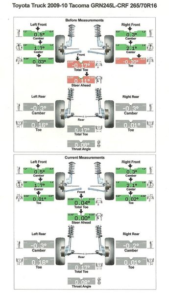

    Here is the print out of the recent alignment (I have a firestone lifetime). They gave me my print out, told me about my "loose inner tie rod on the drivers side" and sent me on my merry way. Didn't give me an estimate or mention any danger in driving. I called them later that evening to get an estimate and they never called back (told me they would work one up). I called again yesterday and they again said they would work one up, but never called me back. Pretty weird. You would think if they were trying to "upsell" me on a un-needed repair, they would at least give me an opportunity to have it done.

    Yep, a OEM cv is definitely in my future. I took it to have another alignment today and they figured out it was my tires that were causing my drivibility issues. Uneven wear was causing pulling, thus my steering wheel was slanted while driving straight. They rotated them and its much better now. Just bizarre that it start right after the CV was replaced.
