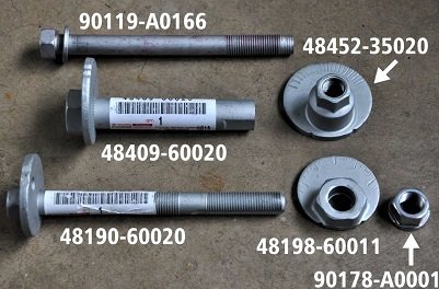

    @Pportera
    To be clear, the top bolt is free-spinning inside the cam (middle piece)? Even after you hold the nut in place? In this case, the threads on the bolt are stripped. You can try drilling the end; drill about an inch inwards, than tap lightly with a hammer. Inspect the nut for damage and replace accordingly. Febest makes good quality replacements; I'm using their cam with the OEM bolt and nut.
    Pic provided by @Muddinfun . See post#64.
    https://www.tacomaworld.com/threads/what-to-do-for-seized-alignment-cams.573731/page-4#post-19492686

    I have a third gen. Also the whole thing spins I have tried holding one side with wrench and pulling other side with strong arm...u can't break the nut loose it's like the whole thing is solid and it just spins... it's not seize but u cant tighten it or lossen it.
    I have brand new moog bolts in a box but I dont know what kinds shop would fix this for me. Most alighnment shops wont mess with it.
  14. Mar 1, 2019 at 6:36 AM
    Pportera
    Pportera Well-Known Member
    Feb 10, 2016
    #177747
    202
    3rd gen.
    In your pic. Its like part #90119-AO196 and # 48462-35020. Are locked and I cant break them the WHOLE thing will just turn both eccentric sides just spin together.

    That bolt slides through the cam (middle piece in pic), then threads into the nut, -35020. The cam also slides into the same nut - thus, they turn together. So, the key is going to be to separate the bolt. The front of the cam is hexed; if you hold that in place, try to unscrew the bolt. The bent tabs can be bent back with a punch and hammer. Hopefully, they won't break off, but a shop can weld a replacement.
    Pportera[QUOTED] likes this.
