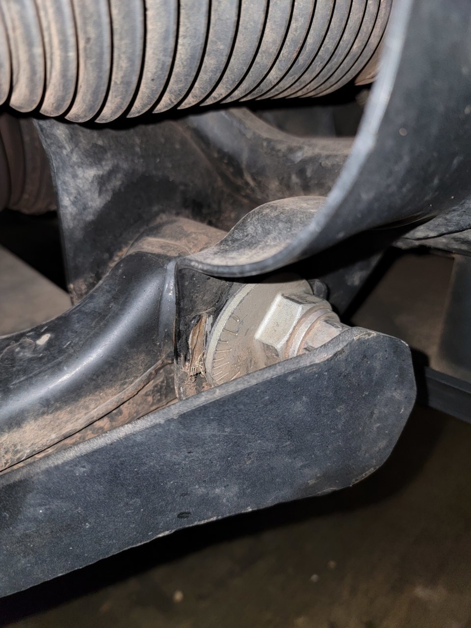

    Hi all, I have seen several threads on alignment tabs bent by off-road use or human error in some way. I am assuming mine came from wheeling and would like to see what options are for installing a weld on alignment tab kit. At the moment I do not have access to a welding apparatus of any sort (nor totally trust myself welding on my frame). I am in the NOVA area, can anyone recommend some good shops who can get this done? Also, would love suggestions on tab kits that people are using, have seen the Total Chaos ones but am absolutely open to recommendations, thanks! Pic attached of the front passenger tab 20211022_204724.jpg

    Looks off, its rusty, has a dead spider on it, and looks almost like it was ground off with a cutoff wheel. If it snapped off you would think there would be some cracking in the paint on the weld, or the weld would be bent. I dont have much to contribute other than that though. Good luck.

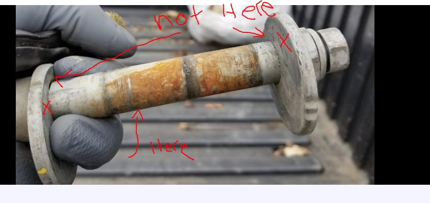

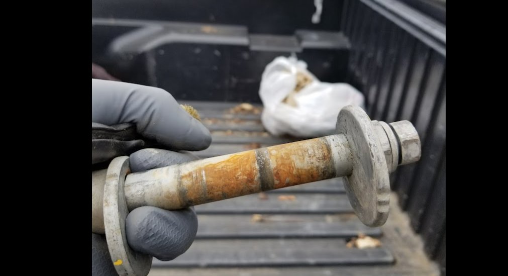

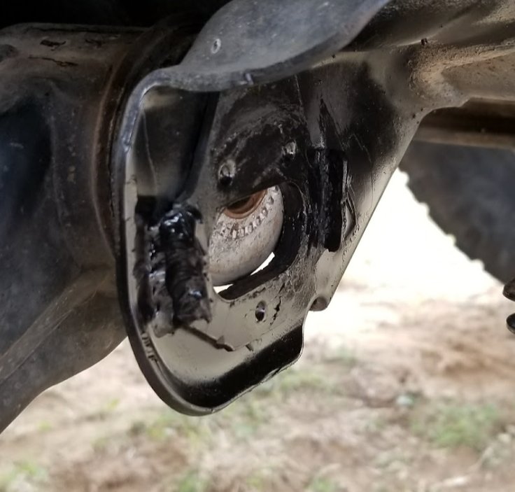

    I just bent mine back and put a giant a$$ weld bead on the back. Has held for 3 years. Anit-seize the shat out of the cam bolt when you put it back. They rust and freeze, mine had just started.

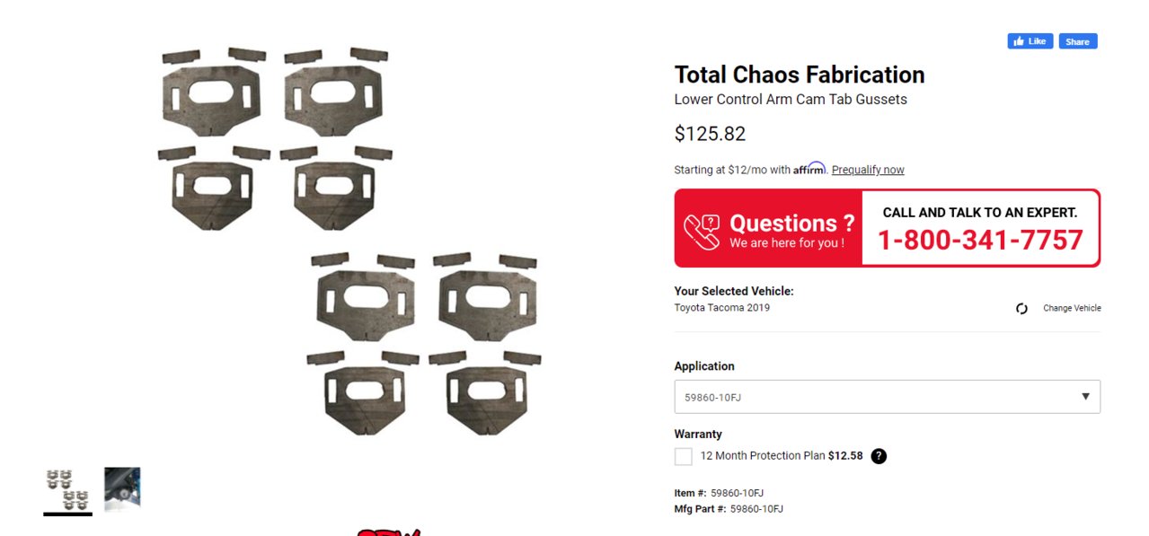

    These kits seem to work pretty good, if repairing.

    This is super helpful thank you, great photos showing the detail. The tap back and bead method may be the easiest option right now unless I can find a fab shop around me that I trust with frame welds :eek: Ill take the tip on the anti-seize right now though.

    My fault on picture quality, it just is severely bent over to the point of being flat haha

    Perfect, these were the exact ones I was looking at! Probably go for these tbh

    Someone must have put some of that voodoo magic on my tabs :stirthepot:

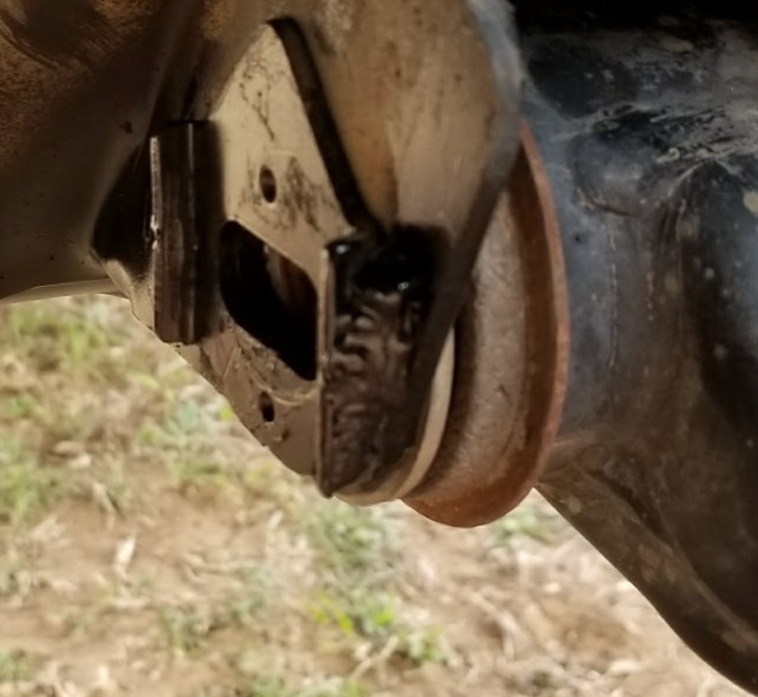

    Oh ya, i see them now. Mine were just like that. I was going to go with the Total Chaos kit, but figured i would just bend them back and put a bead on the back of them and see how it went, as that was way easier. I cant weld for shat either. I just practiced on some old mower blades for a while before going to my frame. Proved to be a good idea. Weld didnt look great, but i have had zero issues so far. I just kind built a littl slant down from the top of the tab to the fame. Didnt go crazy with it and its held up fine. Really not sure why they dont just do something similar from the factory.
    Also, when you anti-seize the bolts, just try to keep it on the bolt its self and off the back face of cam bolt, if that makes sense. Sorry for the 4th grade writing, cant write with a mouse for shit. If you got some on there already, dont worry too much about it. Dry right there just keeps it from wondering after its set. Lubed up it could move some, they say. Not really sure if it would or not.
    TACAMOA[QUOTED][OP] likes this.

    Here is another bad pic from a different angle. Wish i would have took the pic before hitting it with spray paint. Also, i didnt drop the a-arm out, as you can see. So i just took breaks welding, so i didnt roast the rubber bushing behind it. Do a little, move to other a-arm, go back to other and do other side. Back and forth, etc...to keep from melting that bushing. Forgot that important note, lol.

    I used the little shitty Harbor Freight welder I bought to practice. Lol. Figured I could always grind it off, as I'd have to do anyway with the kit, if it didn't work.
