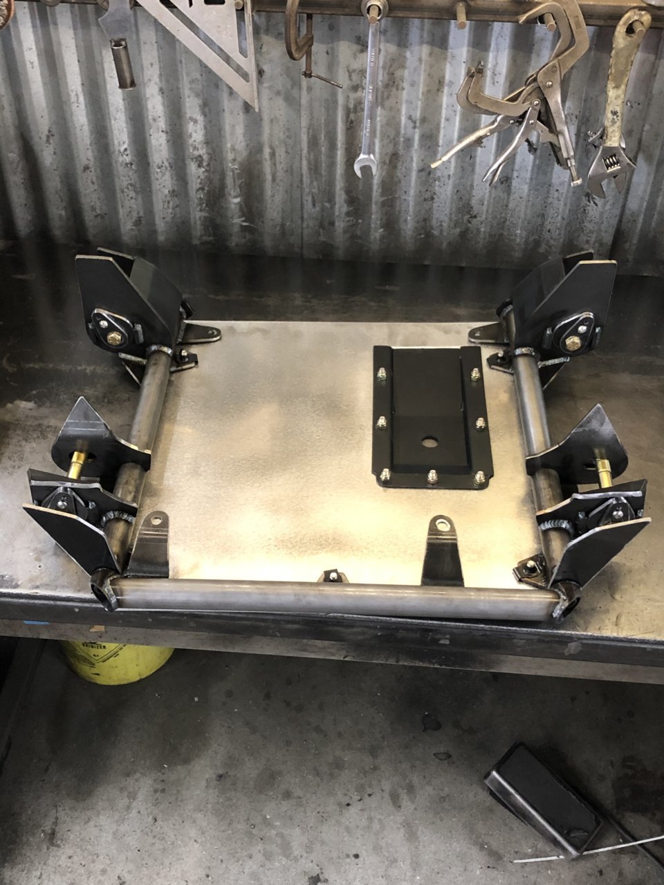

    This kit is now available for 3rd gen

    that kit looks awesome. Is there a link with pricing and info for it?
