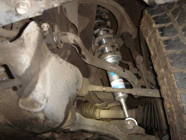

    Can you post a picture of your 5100's? By the numbers that you gave, I want to see the the 5100's Take a picture of your struts.

    Thanks for the help Toku! I hope these photos help. Please let me know if I should take it at a different angle. I could only get the driver side right now. I'll post the other side tmw. Thanks again!

    Hey, Sorry for the late reply.
    I see your problem!
    You installed the spring mount upside down. That is why your numbers are so off!
    I had a feeling you did that that's why I asked for the picture.
    You need to flip them over.
    Good Luck!

    Im pretty sure they are correct. These are upside down:

    The strut pictured is actually correct.
    The picture that the OP posted is most definitely upside down. I'm not sure of how safe that could be either.

    Ok....The mounting is the same whatever direction, so I cant imagine any safety issue arising. Good to know which is which though. :)
