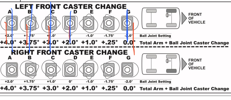

    O gotcha I thought I was replying to a different thread. So I’m reading 2.1 right now at position D. So wouldn’t adding caster be moving the tire forward?

    Only if you increase caster at the LCA will the tire move forward. In simplest terms caster is the angle of the Spindle/Knuckle (the piece that connects the upper and lower control arms with ball joints).
    If you increase the caster at the UCA you are essentially moving the top of the tire towards the firewall since you are trying to gain a positive increase in caster. The SPC UCA sheet depicts this well.
    The change in distance is very minimal and is not much concern when running stock size tires but becomes very apparent when running oversized tires. A higher caster number also drives better, specifically with Tacoma’s that have larger tires (probably applies to many other vehicles but I only know Tacoma alignments).

    So I basically wanted to know which way to adjust the ball joint to achieve getting the tire away from the firewall. As well as what caster reading I want the alignment chart to say. If I’m getting a 2.0-2.1 reading, what do I need to be reading with the tire moved forward? Should I leave it in setting D and deal with rubbing until I get a CM relocation or should I adjust it? What do I want the caster to be reading?

    If bigger than stock my recommendation would be 3° caster or higher.
    Looks like you have a 3rd gen, I’ve heard rumor that there is a tiny bit more clearance than 2nd gens.
    I personally just left the SPC UCA at D, only change I made was setting the camber roughly in the middle. To answer the question, “which way to adjust the ball joint to achieve getting the tire away from the firewall,” setting G would do the most but would also set you back -2° caster. Since SPC’s come with default setting D at +2°, you would be at the same settings as the stock UCA.
    I have a pretty heavy CMC (Cab Mount Chop), flattened pinch weld, and instead of trimmed fenders went with fiberglass. With the alignment you have seen I am on 315/76R16 with -11 backspaced wheels as well as 1.25” spacers and I have minimal rubbing.
    If you are wanting 35’s you could probably get away without the relocation and just a chop. Once you go 37’s and beyond you end up needing to tub so the cab mount is the least of your worries.

    Yea I currently have 285/70/17s with 17x8.5 -6mm offset. I spoke to the SPC tech and he told me settings A,B and C will bring my tire more forward giving me a 3-4* caster. I’m trying to achieve around a 3.5 since that’s what I had with the stock UCAs and lift. All I changed was the UCAs I will change to coil overs later down the road. Also I’m gonna have my mechanic do the CMC/pinch weld etc for me

    As for the SPC tech telling you A, B, and C will move the tire forward, it sounds like he needs to look it over again because that’s not how SPC designed it. Those settings will increase your caster but will also rotate the top of the tire back towards the firewall.
    Here’s a rough show and tell. Red indicates where the ball joint is, which also tells you which direction the top of tire is moving. Blue is simply the center of the bolt.

    I see what you saying but the closer to 4* caster you are the further forward you are. That’s why guys try to achieve this because it moves them away from the rear

    You have to remember that caster is also affected by the lower. In the stock configuration you cannot change the upper.
    Alignments are a balance between camber and caster by adjusting 2 separate cams. If you move the caster, you affect the camber. Then you finish with toe.
    If you increase caster at the LCA, you move the tire forward.
    If you increase caster at the UCA, you move the tire backward.
    The caster degree you see is only the angle of the spindle and does not care where it is in the wheel well.

    Then setting to AB or C must allow for further adjustment on the lower cams. Cuz at setting D the cams are maxed an i can only get a little above a 2* caster
