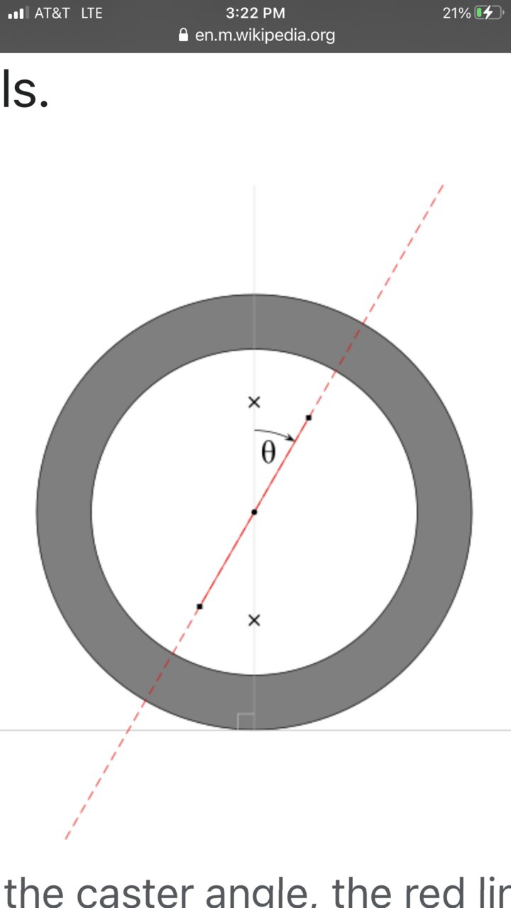

    When you adjust caster on the top or bottom, it directly effects the the other the same amount. You can’t adjust one with affecting the other. Ie. Adjust the top back(positive) it moves the bottom forward. If you adjust the top forward(negative) it moves the bottom back. The top and bottom are connected via a fixed point through the center of the hub. It’s vertical line that pivots, it does not move linearly forward and backward.

    If you move the top or bottom forward or backward any amount the opposite end move the exact same amount the opposite direction. 23CFBF2D-255B-4AAE-ABF8-DBBD9C9B4E82.jpg

    Changing the settings on the upper most certainly does not change the settings on the lower. It does however change the caster angle which is indicated in your photo, which in turn affects camber and toe.

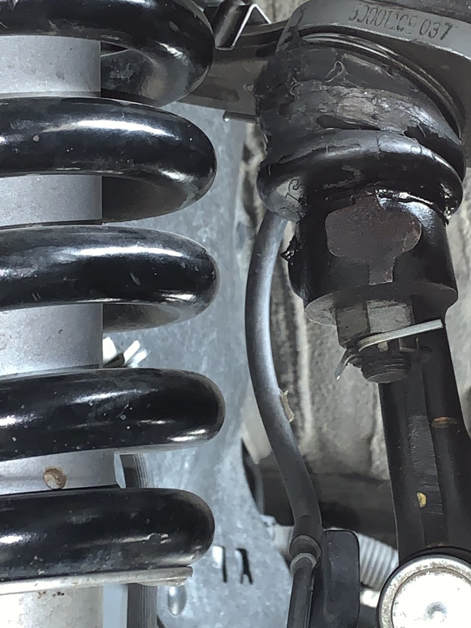

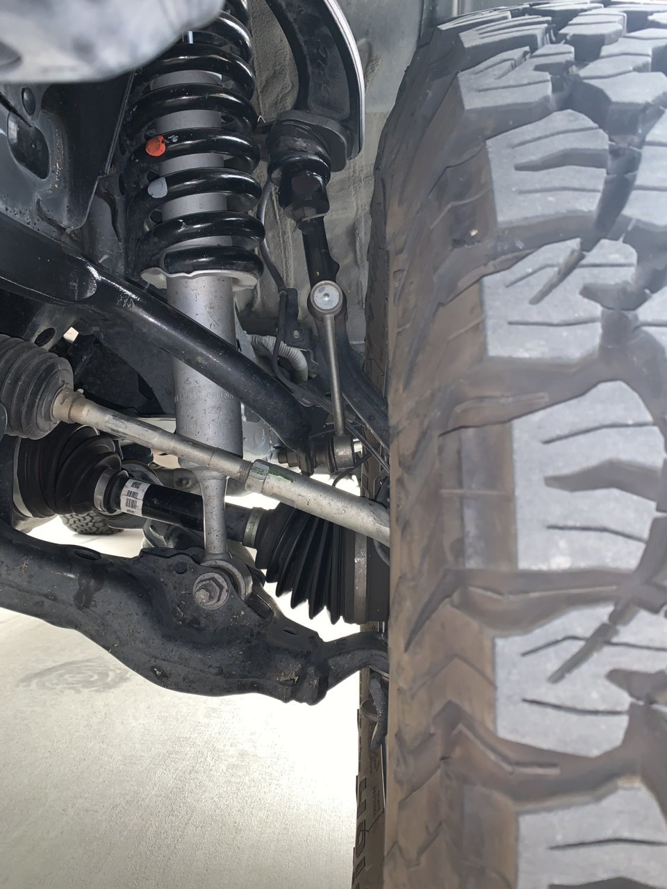

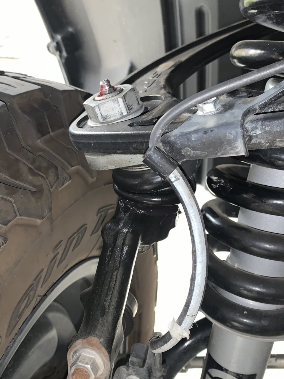

    So the shop that just did mine got 4.2/4.6 caster so my upper ball joint no longer hits coil spring on droop. The ball joint is now behind the coil. But, in return they said the tire got closer to the cab mount. They said drive it like that for a couple days and tell them if I have any run issues. Does this make sense to have such high caster( like I wanted) and have less cab mount clearance? They set the Spc’s to the A position highest caster position. Idk. I don’t rub but might at steep angles. About half an inch to three quarters clearance

    Are you sure your balljoint is hitting the spring, it looks like plenty of space there. I run my SPC's at position E and I don't have any contact with the spring. I have 885 springs so maybe they're narrower.

    Well I had gouge marks on the spring and in the area I’d always have grease on the spring in that spot. I assumed it was hitting on big speed bumps ect. It was real close
