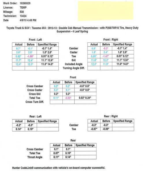

    Probably should have thrown this up along with my question but here it is. the printout I was given. Sorry its sideways..

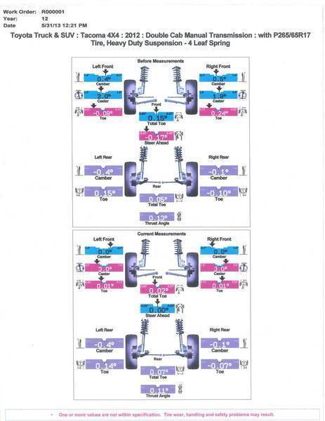

    This topic has kinda been beat to death but here are my .02. I installed a 3" lift on my 2013 DC and had the alignment done to factory specs.
    This alignment ended up causing my truck to have a "loose" feeling in the steering wheel and created a ton of bumpsteer problems. After checking on TW to diagnose the problem i realigned my truck with some specs recommended by TW members.
    This setup is MUCH better! The looseness is gone and the bumpsteer is really unnoticeable. The driveability is better and the braking is solid and not squirly. I do have Light Racing UCAs so the 3* caster was possible for me but you probably wont get that without aftermarket UCAs.

    Where did you go for your alignment? I see your location is Denver.
    Here are my latest numbers after going back to the shop today. Camber is still off and the tech said that he can't get it closer to 0 without the caster going into the Neg. Any truth to that?

    You're probably going to need UCAs to get a good alignment. Might be able to try another shop but I doubt you're going to get the numbers you really want without them. That's why I didn't risk it and just bought them with my lift.

    I have LR UCAs also and they are normally required to get there numbers exactly, however I have heard of people getting 0 toe and 0 camber with a low 2* caster with stock UCAs but never seen any proof. Many shops just don't know how to align properly or lack the motivation which may be the case for you. My 2nd alignment was done at Coloradoland in Littleton and as you can see they got it right on so I would guess they might be able to get you taken care of or at least improved from where you're at now.
    If you look at the specified numbers for your truck on the alignment sheet you can see where they should be able to get with stock UCAs which are way better than the numbers you have on your alignment sheet so I would have someone else try again. It is certainly possible to get 0 toe, 0 camber, and at least 1 or 2* caster.
