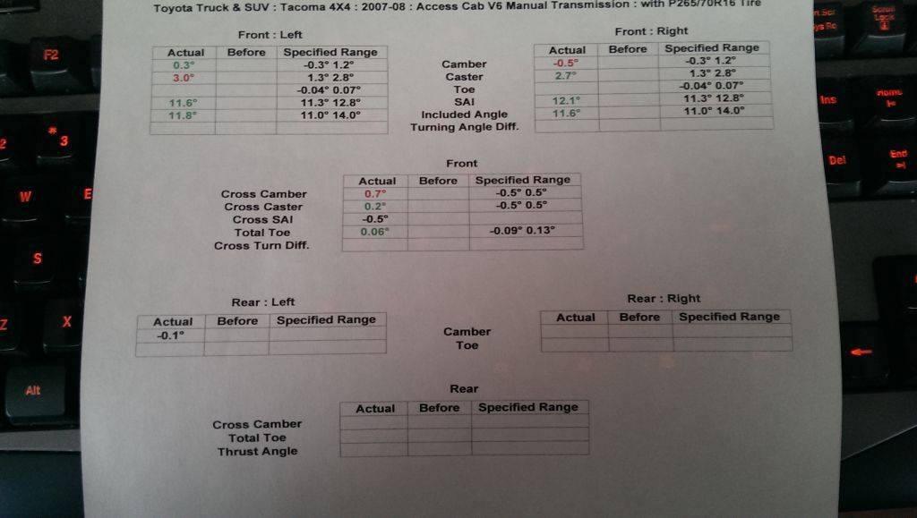

  14. Feb 13, 2014 at 10:18 AM
    #234
    replica9000
    replica9000 Das ist no bueno
    Apr 6, 2008
    #5782
    16,276
    Lake Chargoggagoggmanchauggagoggchaubunagungamaugg
    2019 T4R ORP
    How does this look? I don't remember what my UCA's balljoint is set to.
  15. Feb 13, 2014 at 10:20 AM
    #235
    chadderkdawg
    chadderkdawg Don't ask questions you don't want the answer to..
    Apr 29, 2011
    #55763
    8,148
    Des Moines, Iowa
    09 FX4 F150
    Wish mine would dial in like that... You should try and figure out what the caster is set to on your uca.

  17. Feb 13, 2014 at 10:30 AM
    #237
    replica9000
    Apr 6, 2008
    #5782
    16,276
    2019 T4R ORP
    I seems to track straight, but as soon as a hit a small bump it pulls to the right.
  18. Feb 13, 2014 at 10:53 AM
    #238
    bjmoose
    bjmoose [OP] Bullwinkle J. Moose
    Aug 31, 2010
    #42529
    6,009
    Steve
    San Jose CA
    '11 Std Cab 4x4 5sp
    OME suspension, ARB Air Lockers, CBI/Relentless/Pelfrey armor, HAM radio
    Caster looks good but camber is a little wacky - especially -0.5 negative camber on right side, leading to 'cross camber' out of range.
    Personally, I'd try to zero those out a little better.
    You should be able to do it without affecting caster by using the 'camber only' top nut on the LR UCA.
  19. Feb 13, 2014 at 8:24 PM
    #239
    replica9000
    Apr 6, 2008
    #5782
    16,276
    2019 T4R ORP
    Looks as though it's set to position C.
