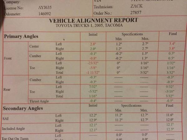

    Installed my OME complete kit with LR UCAs a few weeks ago. Don't know too much about alignment but printed out the first page of this thread for the guys at the alignment shop to help them out. Here's what I got.
    What do you guys think?

    50,579
    Peter North
    British Columbia
    3.4 / 3.8 ?

    This is why I asked, I'm guessing this is bad?

    That's a fair amount of caster. Some people like that as it makes it "drive like a truck" and track really straight on the highway... As long as your tire clearance at the back of the wheel well and cab mount is good - I'd say you're set.

    Thanks for the help, so far so good and I've had her stretched out quite a bit, goes down the road straight as an arrow, I will be doing some adjusting when I upgrade to 285's. Thanks again and for the very helpful install thread!
