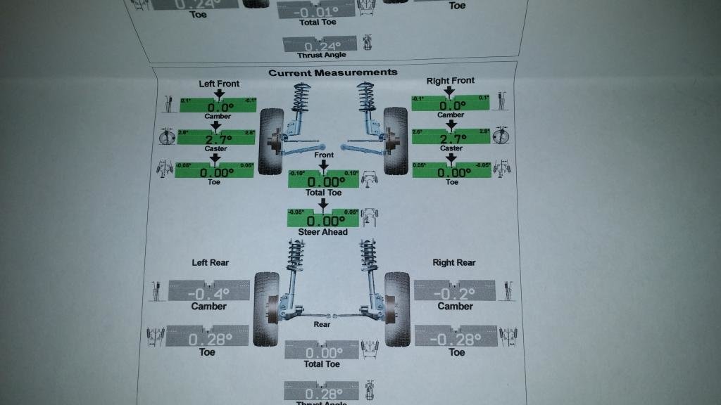

    I am thinking I want around 2.5 caster.
    Should I go with d or e with around a 2 inch lift?

    2" lift - I'd start with "E"

    Yes. You are correct sir. It is spot on. Thank you.
    275-70r17 with 5100@1.75 No noticeable rubbing. But I have not stuffed them yet. I am sure they will rub then.
