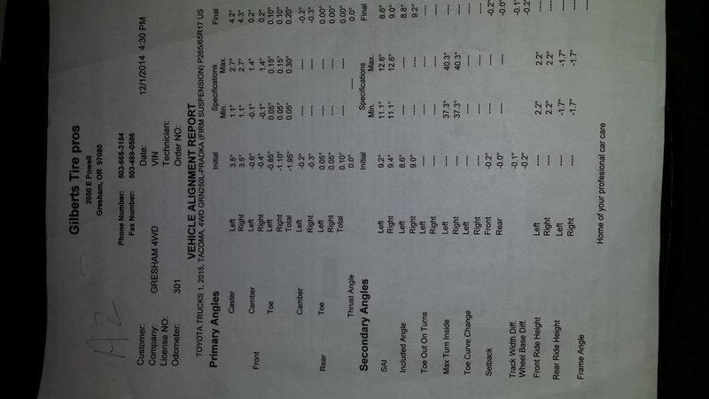

    I have light racing ucas on my 2015 tacoma double cab long bed with a bds six inch lift and fox shocks with 35 12.50 18 tires and rims with a 5.0 backspace. We did the body mount mod which stopped the wheel rub but now it hits the rear fender flare.on our first alignment it never hit the flare but on the second it did.The second alignment was done after the mod and after cranking the front coils to give us 1 more inch in height. What do you think caused this change and what do you think of these numbers? The first alignment was with the tire pros.

    I've not yet seen anyone using LightRacing control arms with a 6" lift.
    That's a lot of initial caster.
    I'd try going back to position E or maybe even position F.

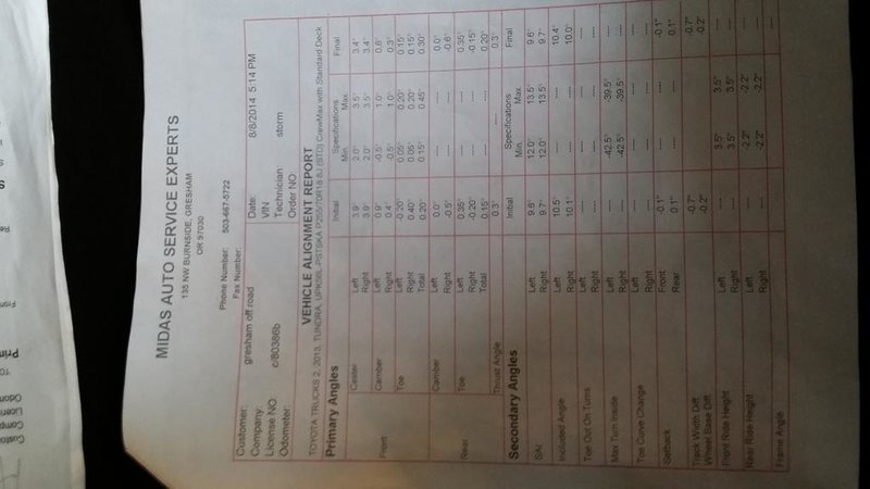

    I got to help out with my alignment today. We were able to jack the truck up on the alignment rack and adjust the caster.
    Did not touch LCA bolts due to issues in the past.
    Camber was at .2 on driver and .4 on passenger
    Caster was at 3.2 on driver and 2.6 on passenger
    Toe at 0 on both sides
    Weird thing was when we adjusted caster for more caster on passenger side; It just stayed the same. Each time it would throw the toe off and when we would bring the toe back in the caster would go down. Its such a headache. I do love that you can adjust the camber with the sliding nut. Anyone got any advice. The driver side is set at C the driver and the passenger side is B.

    Could my alignment numbers be off due to my icon extended travel coilovers? One side is cranked down more than the other due to the taco lean.
    caster on driver 3.2
    caster on passenger 2.7

    It's not uncommon for alignment techs to add more caster to the right to compensate for road crown.

    I actually did the alignment with the tech. We could actually jack up the truck on passenger side to make adjustments to the caster but the weird thing is that the caster never really changed when making adjustments on the settings.
