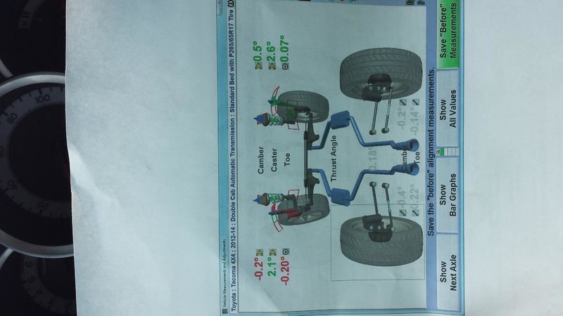

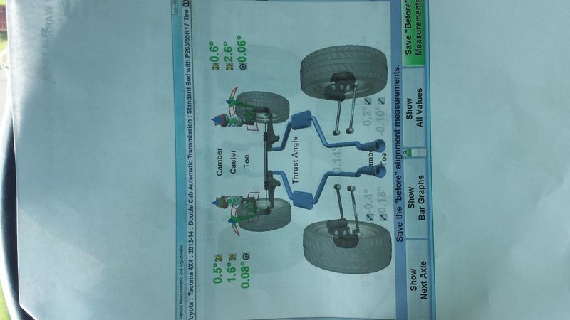

    Here are my numbers before and after. They told me the driver side caster was set lower due to compensation for road crown. I this point I was frustrated and didn't want to keep arguing. It did drive better after wards and didn't wander as much. I did notice that the wheel has to be slightly left to drive straight though.
    I can't seem to figure out why it keeps uploading the picture sideways and for this I apologize.

    Correct me if I'm wrong but you set camber to compensate for road crown, not caster.
    I used position "D." And set the camber nut all the way out towards the tire.

    I did an extended test drive on the freeway and it pulls right when the wheel is centered. Also noted that there is still some wandering at speeds over 60mph. I'm going to take it back tomorrow to equalize the caster.

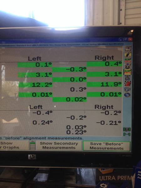

    Sorry, fell behind here! UCAs are on in the "D" position!
    Alignment is gonna need some help. 1 of 4 cam bolts could be freed up! No go!
    We set camber and toe to 0 to help tire wear, but there is a slight wander to it! Nothing worse than what it was with bad bushings and one bad ball joint!:p
    I really don't want to put money into LCAs because they will be replaced with the frame...whenever that happens! (I was told 2-3 months in the beginning of Dec.):confused:

    I had a frozen cam bolt and we were able to get 3,0,0 by using a combination of the LCA cams and the camber adjustment on the UCA

    Yeah Oz, we tried that! To get even close, my tires would have been rubbing at a 1/4 turn of the wheel! My weekend plan was to soak the bolts again and try to free them up! Don't want to use heat because of the rubber bushings!

    Goodyear is still giving a hard time about caster. They basically said they aren't going to play with the numbers because they are only concerned with tire wear. I'm just going to have to find a small shop that'll do play with it.

    That's odd that they can't get your caster up
