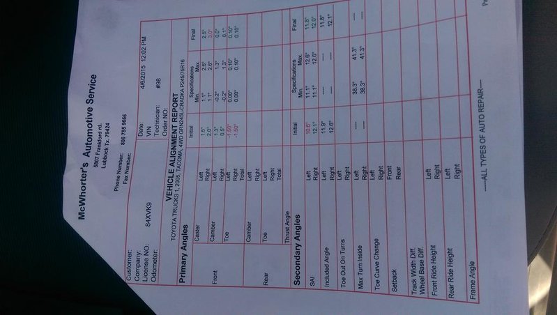

    Here are my final numbers. Paid a lot, but man it drives and handles way better than stock.

    those numbers look good!

    Is this the sheet to show the alignment guy?
    Doesn't mention camber adjustment very much.
    So basically start with caster on UCA, then caster on LCA so its near 2.5*-3*, then get the camber adjusted to 0* using the LCA and UCA, then toe

    Those upper control arms are worth every penny. Luckily I got a tech who would drive it after he did some work, if he didn't like it, he would tweak it again until he was satisfied. I'm very happy with the results.
