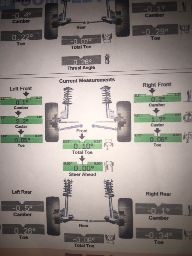

    Got my alignment done today... Went up to Firestone and got the lifetime alignment for $200. Told them I had aftermarket UCAs, gave them the LR UCA instruction sheet, and told them I wanted 0 toe 0 camber 3 caster.
    Here is what they did...
    42F4279D-2A23-4C0C-AC40-2D9E8CE597EF_zps_4eebdfa1fa631f4f6fcec447e9f047f4b018444b.jpg
    Honestly doesn't feel much different than what I had prior to alignment. Not sure if they couldn't get my caster up any more or if they wouldn't.
    What do y'all think about these numbers???

    I forgot to get a print out of my alignment. From what I remember, toe and camber was pretty close to 0*, and caster was at 2.9*

    Yep, that's kinda what I thought as well. It was late and I didn't feel like waiting for them try it again. Try again next week lol

    I think they wasted your time.
    Find a small mom and pop shop thats willing to work with you. I took mine to small local shop, I got to stand in the garage and watch the owner/mechanic/only person there do the alignment. He listened to exactly what I wanted. I got to see that everything was done properly. I think he honestly spent more time talking about hunting and fishing with me than he did on the actual alignment. And I paid a measly 52$ to have it done RIGHT.

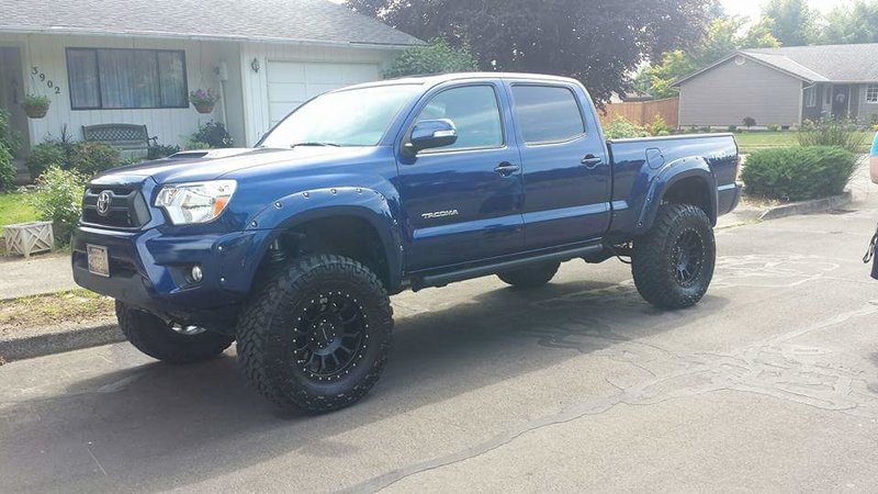

    Just had my alignment done. LR UCAs set at the +2 caster position & slid all the way outward. 2.5" lift up front. All of the adjustments were done at the LCA cams by the mechanic.
