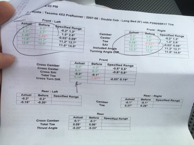

    Here's my contribution to the thread. 3" lift with LR UCA's:

    Everything in green so looks good? Lol. Fox 2.5co 2.5in lift and hs aal 1.5 in the rear

    OME884/5100's Wheelers Progressive AAL LR UCA's 265/75/16 Duratrac Method NV wheels Color matched grille surround ImMrYo rear view mirror relocation bracket Avid slider/steps
    Alignment from yesterday, running 5100/884's with Method NV's on 265/75/16 Duratracs. After settling still achieved ~2.5". The LR UCA's were an afterthought, couldn't get where I wanted to be with the stock UCA's. Very happy with outcome and ride.

    My 3rd and final alignment dialing in the LR UCA's and 3' lift. First @ 2.4 caster and then 3.4. Now at 3 and it is the best by far. Think im done. Time to enjoy now !!

    i had mine previously set at 3.4 and it was a bit firm and stiff for me. Dropped to 3 and very nice now..
