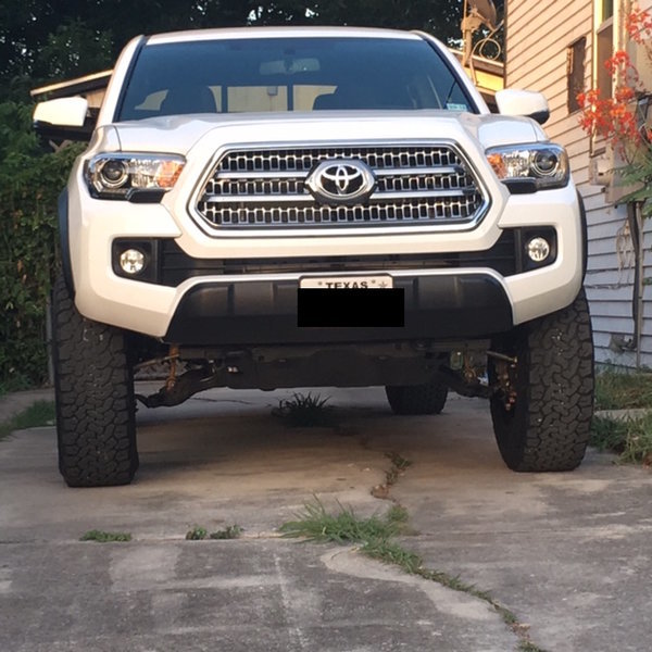

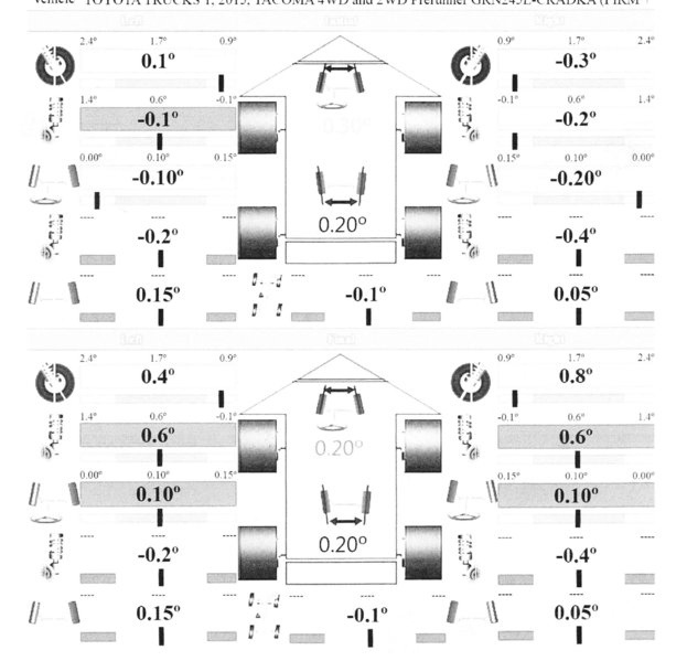

    I had a 2 1/2" lift/level and 17" SCS Ray10's with BFG KO2 285/70/17"s on my 2016 TRD OR 2wd today, Driving seems straight, firm and no rubbing on way home, My drive way may be off because of the cracks but I notice a tiny bottom inward slant on Pax front side. These are my shops alinement spec sheet
    I apologize but know zero about this stuff, if you can let me know if I should bring it back fro corrections or wether thesis numbers are ok! He did say to bring back 500-1000 miles for check and retorque! But as much as the BFG's cost me I don't want then worn before then!

    Ive got some good advise here and this kinda confused me,
    "Those 3rd gens sit an inch higher stock than our 2nd gens. I think he's definitely lifted too high."
    my TRD OR is a 2WD I don't know if that matters!
    This is the lift I got!
    DAYKTO9I2OBK
    05-I6 TACOMA 2.5" FRT. I.5" REAR DAYSTAR LEVELLING KIT
    how is this over 3"s
    from what Ive gathered these numbers are horrible
    I was told under 3" I would be fine but what I'm gathering here from the pro's evidently my 2.5 inch daystar level lift is way over 3"'s!
    I guess I'll take it back have them remove the lift and I'll put the stocks rims and tires back on and call it a day! Didn't realize I messed up that bad!
    I guess I'm back to square one, no one here in San Antonio, would do a headstrong billy 5100 lift with OME coils and UCA's, I have the money for that but cant find anyone to do it, so I just bought the one above!

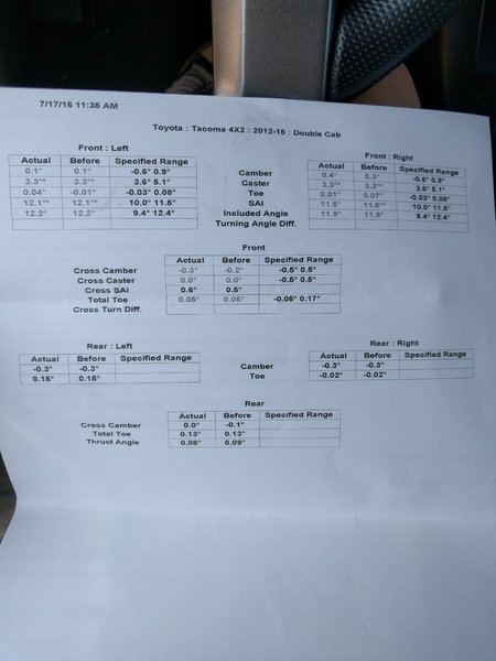

    Alignment was redone today after switching positions on my LR UCAs.

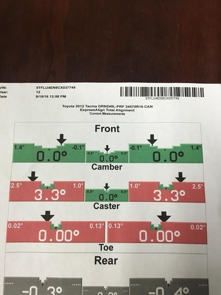

    here are the results after my first alignment.
    i specified exactly what i wanted, and they preformed accordingly.
    truck was dropped off with the star plate set at D, and now post alignment they are set at C.
