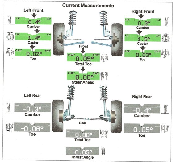

    I'd appreciate some input on ideal alignment numbers for my rig.
    Setup:
    • Lift: Icon stage 1 coilovers w/ about 2.5in of lift in the front w/ 1.5in Icon AAL in the back
    • Wheels & Tires: 255/80/17's Cooper ST Maxx on XD Revolvers, 0 offset & 4.5 backspacing
    • I've already trimmed quite a bit, so i'm not worried about rubbing/clearance
    I currently have stock UCA’s but plan to install the Light Racing UCA’s as my current alignment specs are not ideal. I’m guessing my caster needs to be between 2.4-2.8 based on what I’ve read.
    Thanks for the help!

    Are you having issues with your current setup and current alignment? Are you rubbing a lot??
    We need a to hear from you a little more on the issues you are having, if any, to give you some feed back!!
    what have you trimmed so far?
    with your setup and alignment specs I imagine it drives on the road rather well but maybe you are having some rubbing when the wheel is fully cut left or right?

    no issues w/ the current setup- just realizing that i should have gone w/ new UCA's when i lifted the truck to prevent wear & tear on suspension parts & hit correct alignment specs. It drives great on the road as is.
    No rubbing currently at full lock either way- I trimmed quite of bit in the wheel wells when i was running 285's previous to the 255's.

    I do not believe that you are necessarily damaging anything by not having upgraded yours UCAs.
    2.5 inches of lift is like right there at the limit thats all.
    Your best wear and tear prevention is you as the driver behind the wheel and where you decide you wanna stick your truck in and out of and in what manner you approach obstacles.
