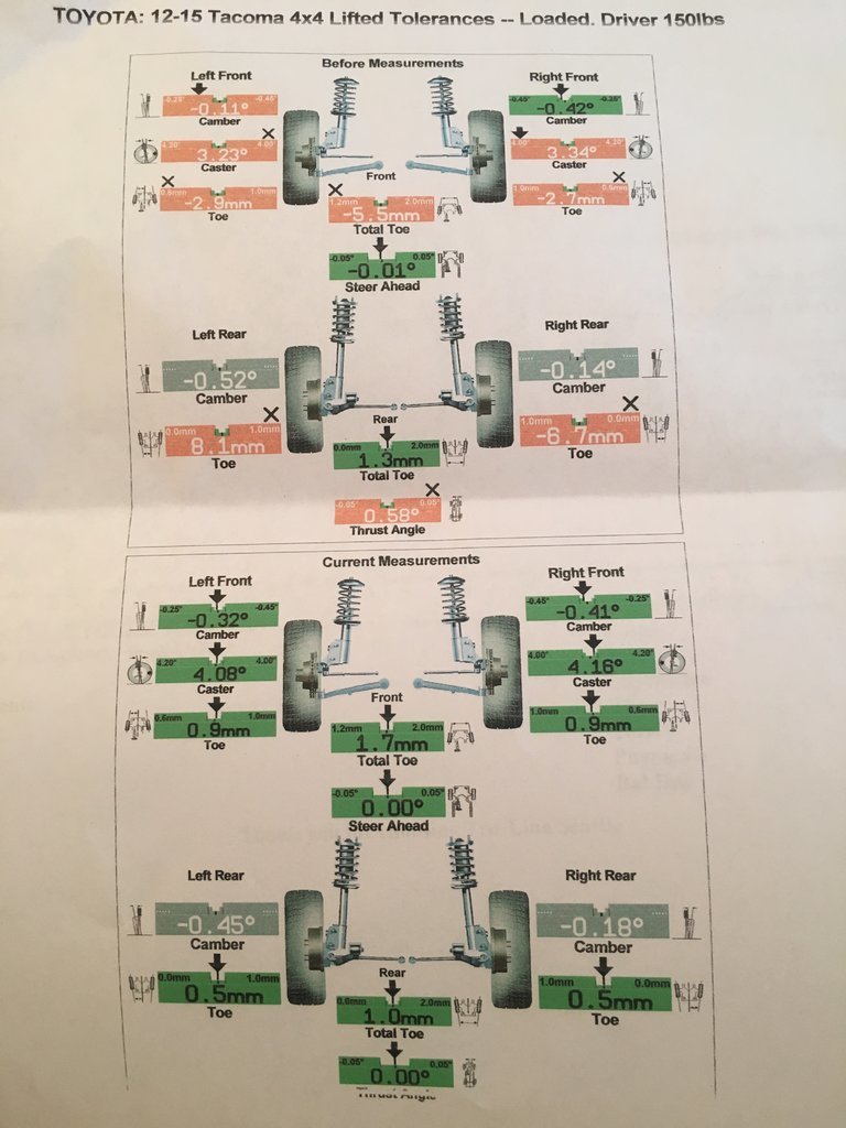

  15. Sep 7, 2017 at 5:05 PM
    #935
    mateo_roberto
    mateo_roberto Well-Known Member
    Feb 29, 2016
    #179798
    708
    Mateo
    San Diego, CA
    1995.5 Tijuana Teal 4x4
    Stock
    Reading thru this thread helped me a ton when getting my alignment done. After finally sacking up, I got a "big boy" alignment as opposed to firestone where they put weight in the seat, all that jazz. My rear thrust angle was nearly 0.6 degrees, but toe was good so I knew the rear axle was crooked. My current alignment had me at 3 degrees caster already, but 2 of that was from the UCA so i still rubbed my back fender. Also, I went ahead and had them do their own recommended camber and toe settings for tire wear, which they'll look at every 4000 miles and adjust accordingly. I know everyone recommends 3, 0, 0.
    Modifications: SPC UCA at the recommended 2 degree setting, 6112s set at 5/4, ome dakar light duty with aal, and 255s.
    Before measurements:
    Camber: -.11 -.42
    Caster: 3.2 3.3
    Toe: mm to degree math
    Rear axle thrust angle: 0.58 degrees!
    After measurements:
    Camber: -.32 -.42
    Caster: 4.1 4.15
    Toe: more math
    Rear axle thrust angle: 0.00 degrees
    Pretty happy with how it drives so far on the way home. The 4 degrees makes it feel more like a car as far as steering goes. I would recommend trying the 1 degree setting, and trying to get even more than 2 degrees caster from the LCA!
