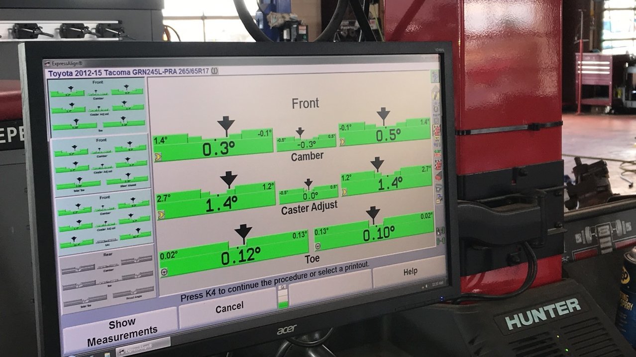

    That’s one of the alingments I’ve had lately

    With SPC LR UCA's? :eek:

    You don't want more caster ?

    He does but the multiple shops hes taken to cant or dont know how to get him more. I hate to think how much he has spent in alignments lately. Tomorrow he has an appointment with the guy that did mine and hes known to be the best around here. So hopefully he will get him dialed in.

    Yeah.they just so stupid around here they said that was my best clearance.but when we was playing with the alignment Saturday I watched them shift that wheel all the way forward that’s what I wanted but for some reason they didn’t leave it there.but we will see how tomorrow goes.getting sick of gettting alignments so they better get it where I need it
