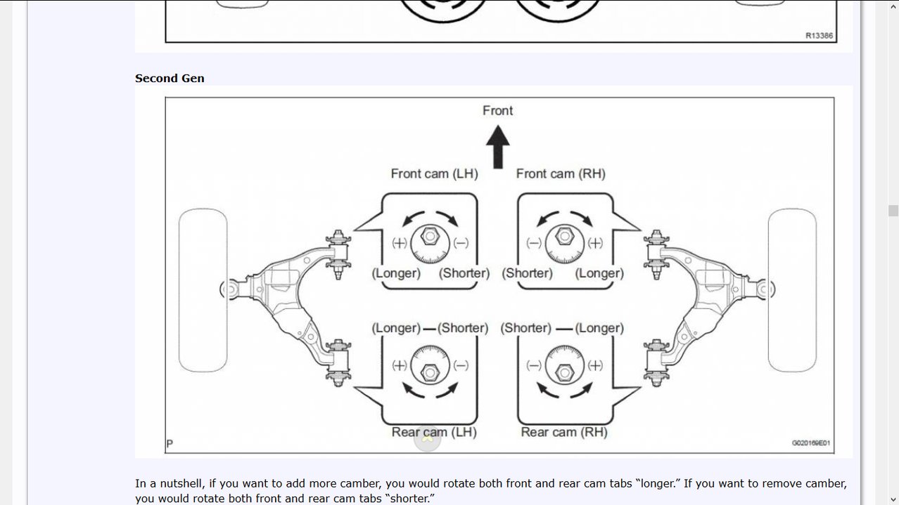

    Look @ the sticky thread above this, & when you get a minute read the whole thing, for pictures.
  8. Mar 7, 2018 at 8:37 AM
    #988
    MolonLabeTaco
    MolonLabeTaco Well-Known Member
    Jan 30, 2018
    #242953
    2,786
    Dude
    N. Texas
    '12 DC 4x4 OR
    From that thread above:

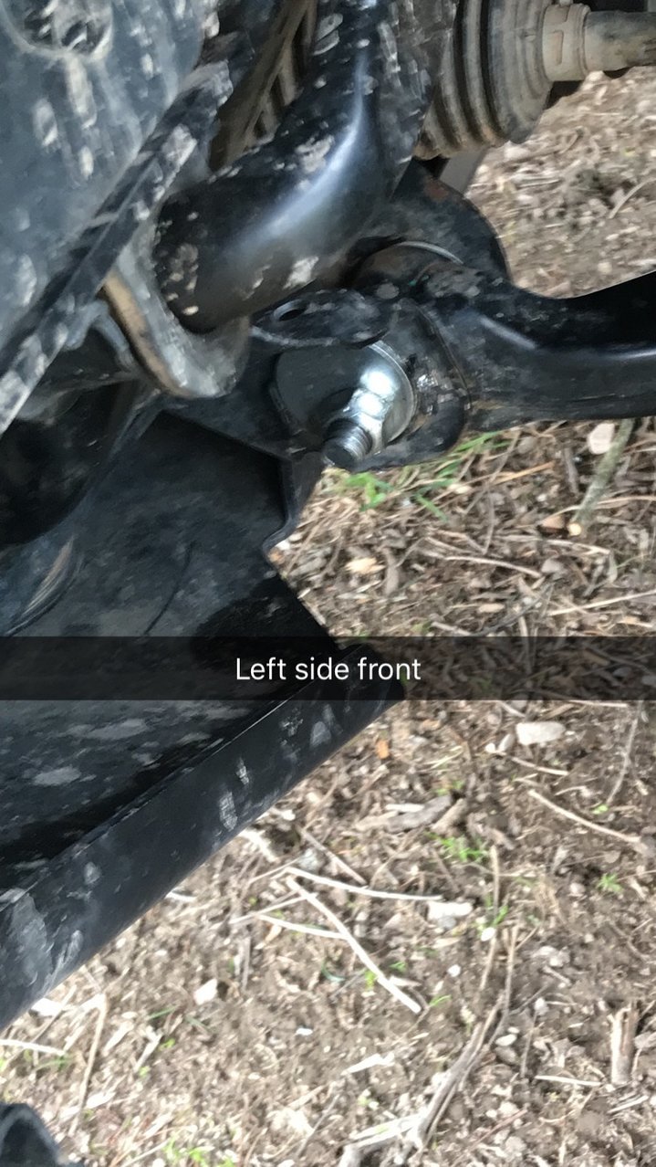

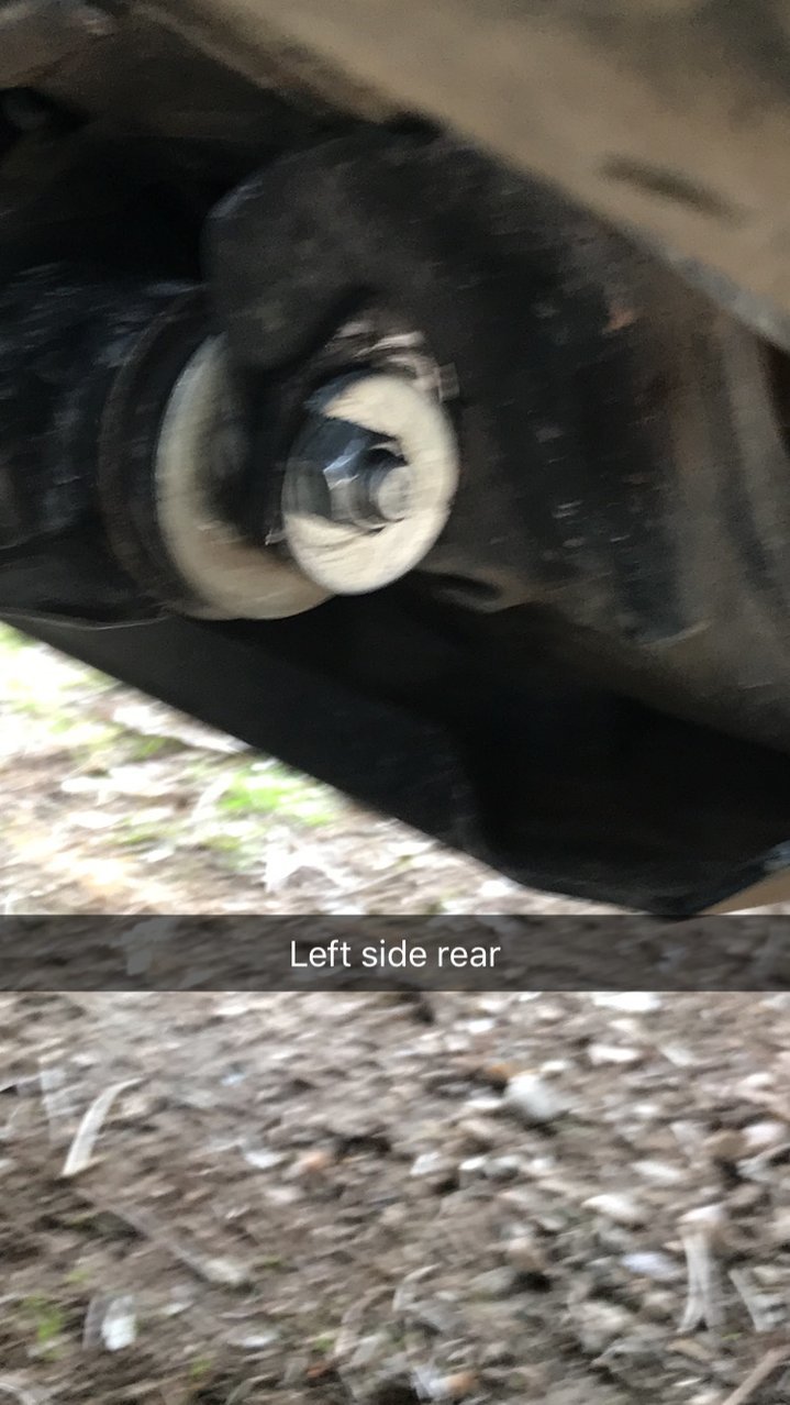

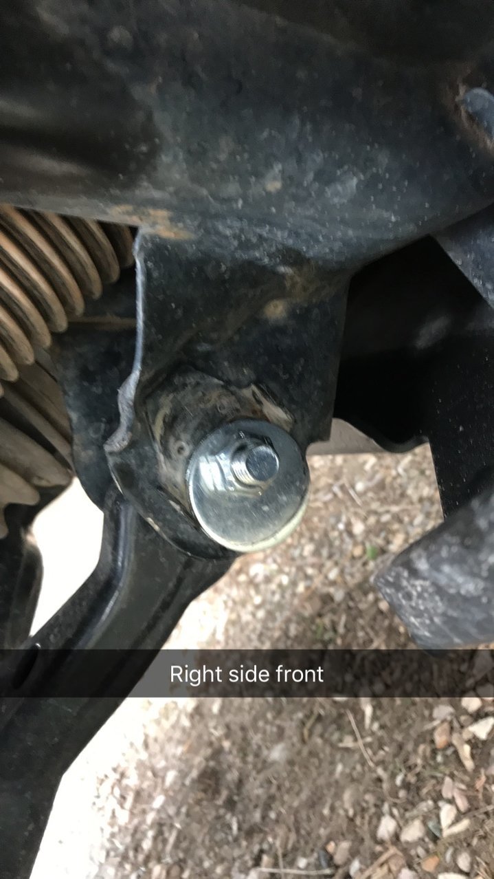

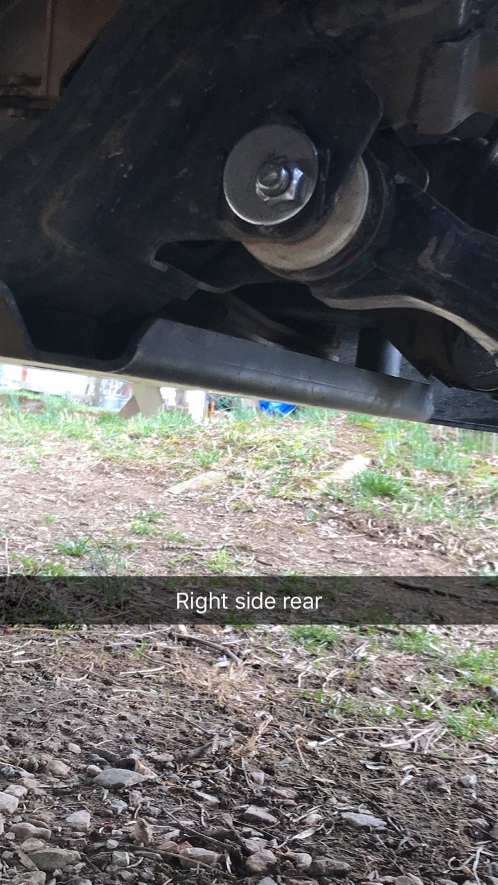

    Ok I’m gonna go look.if I have trouble telling I’ll take Picts of the cams to show you

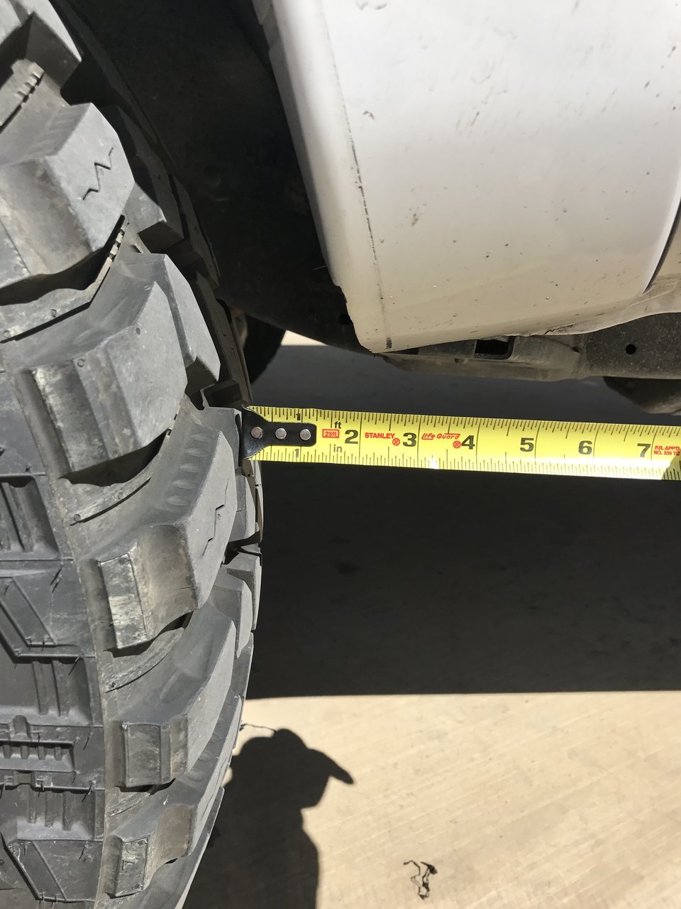

  10. Mar 7, 2018 at 9:06 AM
    #990
    MolonLabeTaco
    Jan 30, 2018
    #242953
    2,786
    Dude
    N. Texas
    '12 DC 4x4 OR
    My clearance:

  11. Mar 7, 2018 at 9:31 AM
    #991
    Jcash
    Jcash Well-Known Member
    May 29, 2016
    #188224
    289
    Jeremiah
    Va
    2015 silver Tacoma Trd sport

  13. Mar 7, 2018 at 9:43 AM
    #993
    MolonLabeTaco
    Jan 30, 2018
    #242953
    2,786
    Dude
    N. Texas
    '12 DC 4x4 OR
    The only one correct is the left side rear!
