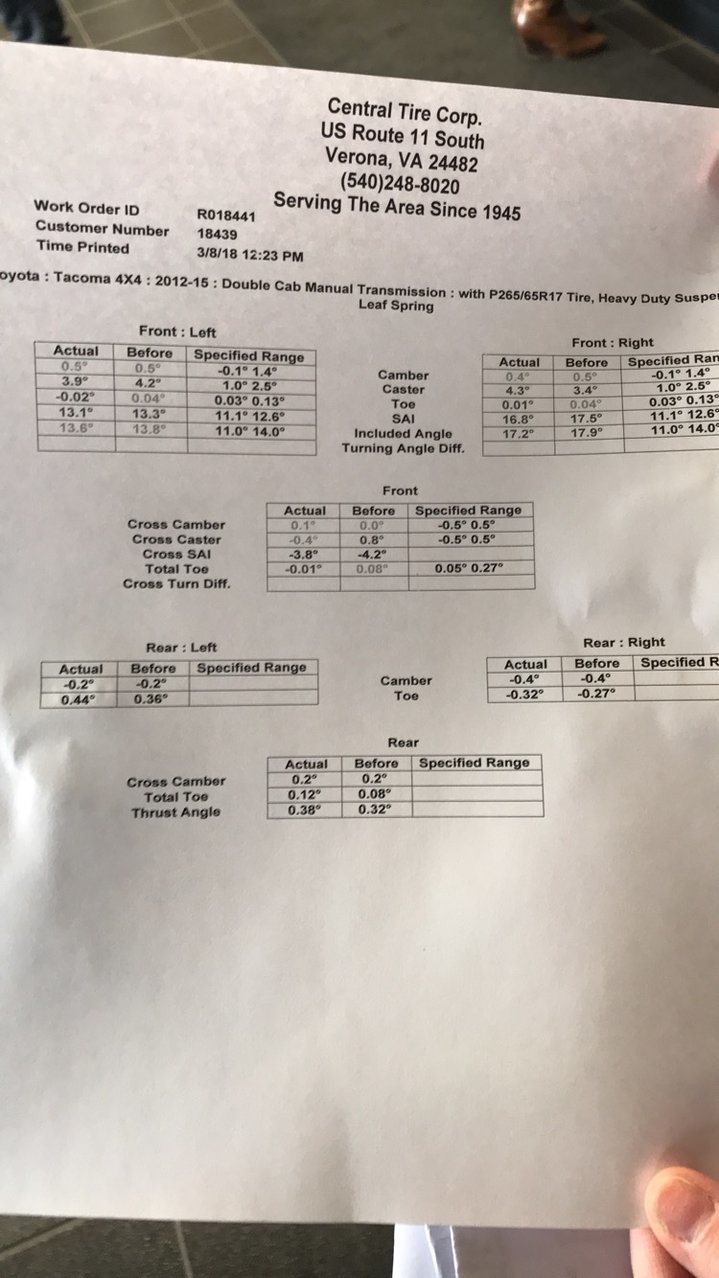

    What you think?heres the finsihed product?

    Here’s the alignment sheet from today.what do you think083C349E-31A8-4B99-B883-A31AF2AD89BA.jpg

    Read the last sentence of my last post.

    It won't wear weird. That's 2 hundredths of 1 degree. Very, very small angle.

    As far as an alignment goes, yes. As far as having max clearance on the rear of the wheel well, I don't know.
    Are the cams set for max caster now?
    I've repeated the same thing a ton of times for you. I won't repeat it any more. I've tried to be patient w/you but I keep answering the same questions ad nauseam!!! Once again, READ THE STICKY IN THIS THREAD. Good luck.
