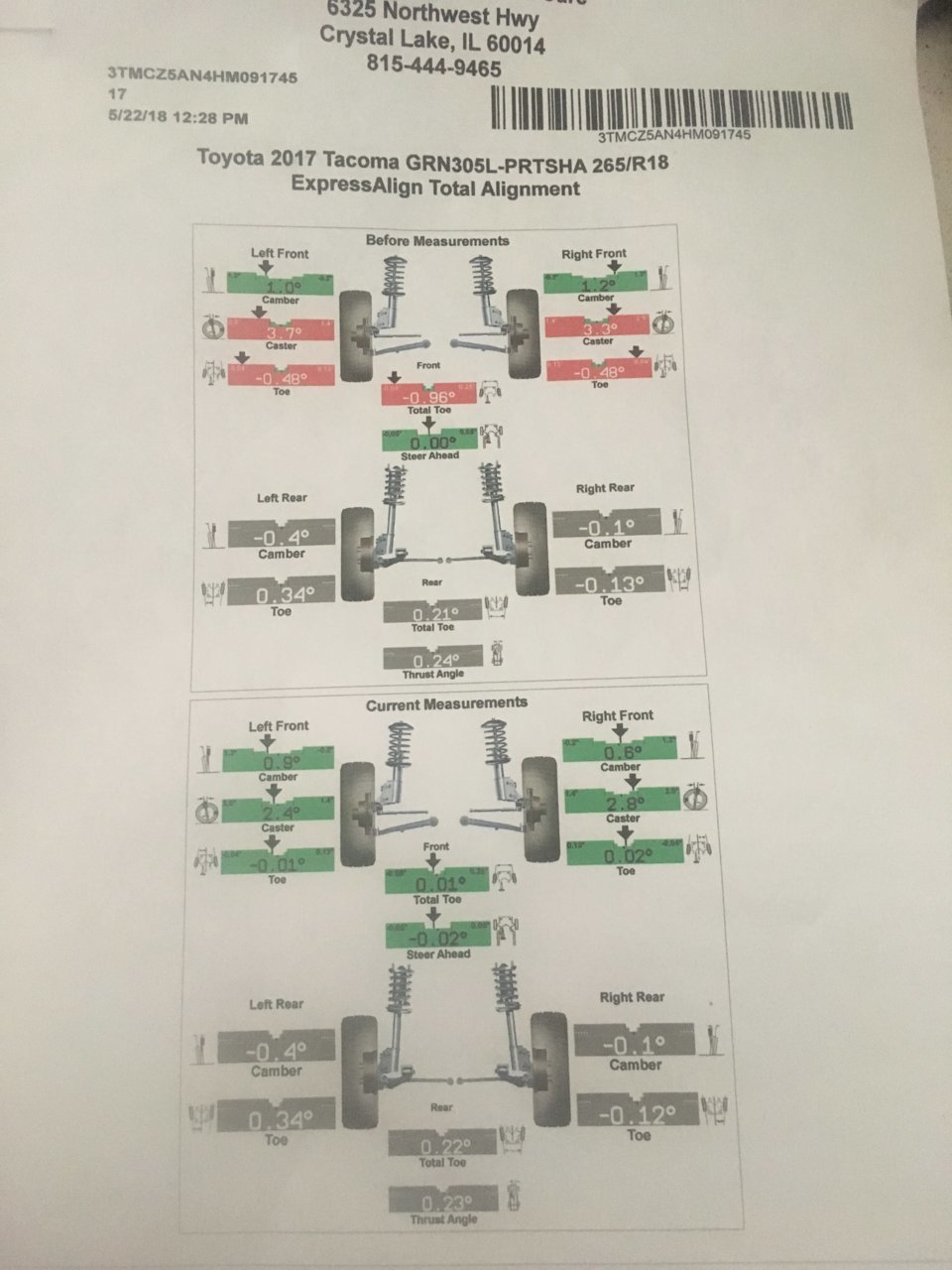

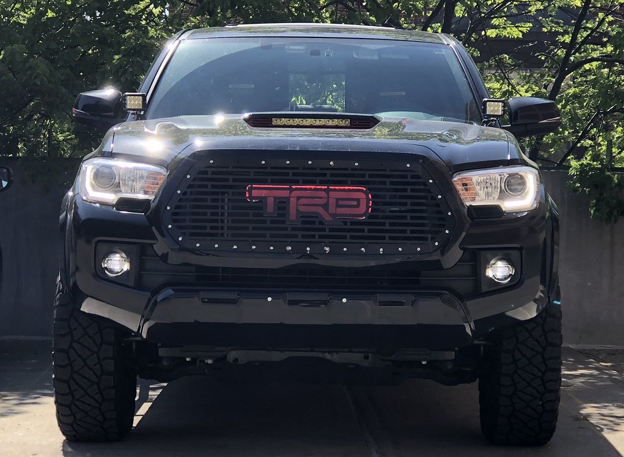

  18. Jun 12, 2018 at 1:06 PM
    #1038
    Pureevil13
    Pureevil13 Active Member
    Dec 18, 2017
    #238795
    29
    Lonnie
    Cary, Il
    17' Tacoma TRD Sport
    3" Fabtech lift w/UCA's Dirt Logic Coilovers with remote resi's SSO slimline front bumper with 20" light bar SmittyBuilt X20 synthetic rope winch Rigid mulicolor Ditch lights W/Rago Fab mounts JDM Hood Scoop Light bar RCI Offroad Sliders RCI full set of skids Morimoto HID conversion kit(Low Beam) Morimoto LED fog lights KB Voodoo 58" rack Smittybilt RTT Nitto Ridge Grapplers Custom Grill Window Tints Remote start Decal inserts for the tail gate, dash and door sills Interior LED lighting SPOD with custom switch plate
    Here is my recent alignment and pic of the front of my truck. It drives well but looks like the Camber if off from just looking at it but numbers on alignment are not high.
    My current setup is a Fabtech 3" lift with Fabtech Uniball UCA's. Does this look correct or should I have them tweak it more to get camber and toe at zero's?
