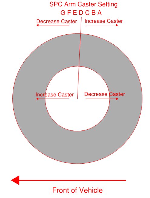

    Your description of the cam adjustment is correct except camber will also need to be taken into account. Also by moving the lower control arm forward you will increase the positive caster. I would then have them increase the positive caster as much as they can. This will give more clearance at the rear of the wheel well.
    Another option is to set the upper control arm to position E (which will move the top of the spindle forward). Then have them align it to ~3 deg of positive caster. This should give even more clearance at the rear of the fender. This is what I have my '17 set at. I am running 285/75/16 tires with 16x8 0 offset wheels and do not rub my body mount. Your offset will increase the chance of rubbing the body mount.
    steveo27[QUOTED] and Kolunatic like this.

    Attached is a diagram that I put together. Hopefully this is helpful. Basically the idea is set the UCA to the lowest caster correcting setting while being able to get enough positive caster using the LCA. By doing this it will move the tire forward in the wheel well and increase clearance at the rear of the tire.

    My alignment guy is pretty good at doing what you want as long as I can tell him what you want.
    1. Pull control arms the whole way forward to create as much rear clearance.
    2. Set caster via upper ball joint
    3. Set toe
    What seems to be the best compromise between clearance and caster and keeping the wheels centered in the wheel wells?

    If you keep the UCA's at position D I would try to get 3.5 degree of caster.

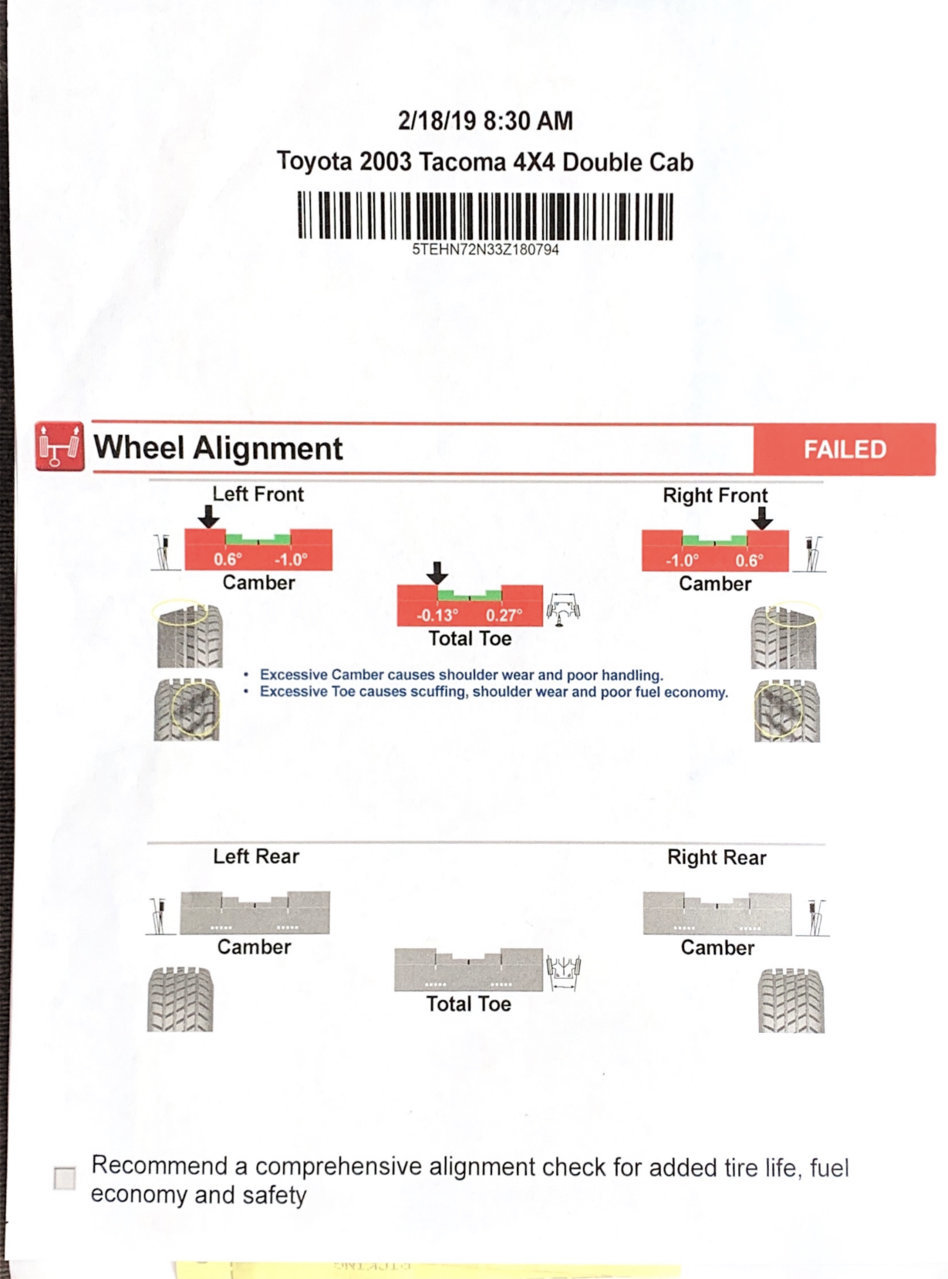

    #1077
    JMJordan
    JMJordan Active Member
    Jan 14, 2016
    #174945
    34
    Jason
    Atlanta, GA
    2003 Tacoma 4-Door 4WD SR5
    285/70/17 Nitto Terra Grappler G2 BK-9504 Lift Kit w/Bilstein 5100's, 3" Toytec/Eibach Coils, 2" ToyTec AAL
    I just had my Tacoma aligned & rub with 285/70/17...all I see is red:

    So just a general question.. if an alignment is done after lifted with factory tires will it be affected with larger tires? (No change in lift)
  19. Feb 22, 2019 at 9:01 PM
    #1079
    mynewtoy
    mynewtoy I like men
    Apr 16, 2011
    #55023
    2,559
    greg
    Mississippi
    09 double cab 4x4
    Detriot locker rear ARB air locker front 4.56 gears OME 3" lift, SPC uca's , moto metal 951 wheels 315/75/r16 Treadwright guard dogs, homemade front plate bumper with smittybilt 9.5k winch, homemade skids, homemade Bed bars, Mobtown offroad high clearance rear bumper with tire carrier, Homemade rock sliders , U-bolt flip, Wheeler's super bumps, BORA 1" wheel spacers , Black headlight mod , black tail lights, Satoshi Grill , autoPage C3 RS-665 alarm with remote start, flowmaster 40 series exhaust, cruise control,bed/ground effect lights, wet okole seat covers, tinted,windows, weather tech floor mats, AVS vent shades, debadged, hidden cobra 19 cb, 7" offroad lights behind grill, rear diff breather relocate, abs kill switch
    No
    Hookedup[QUOTED] likes this.
