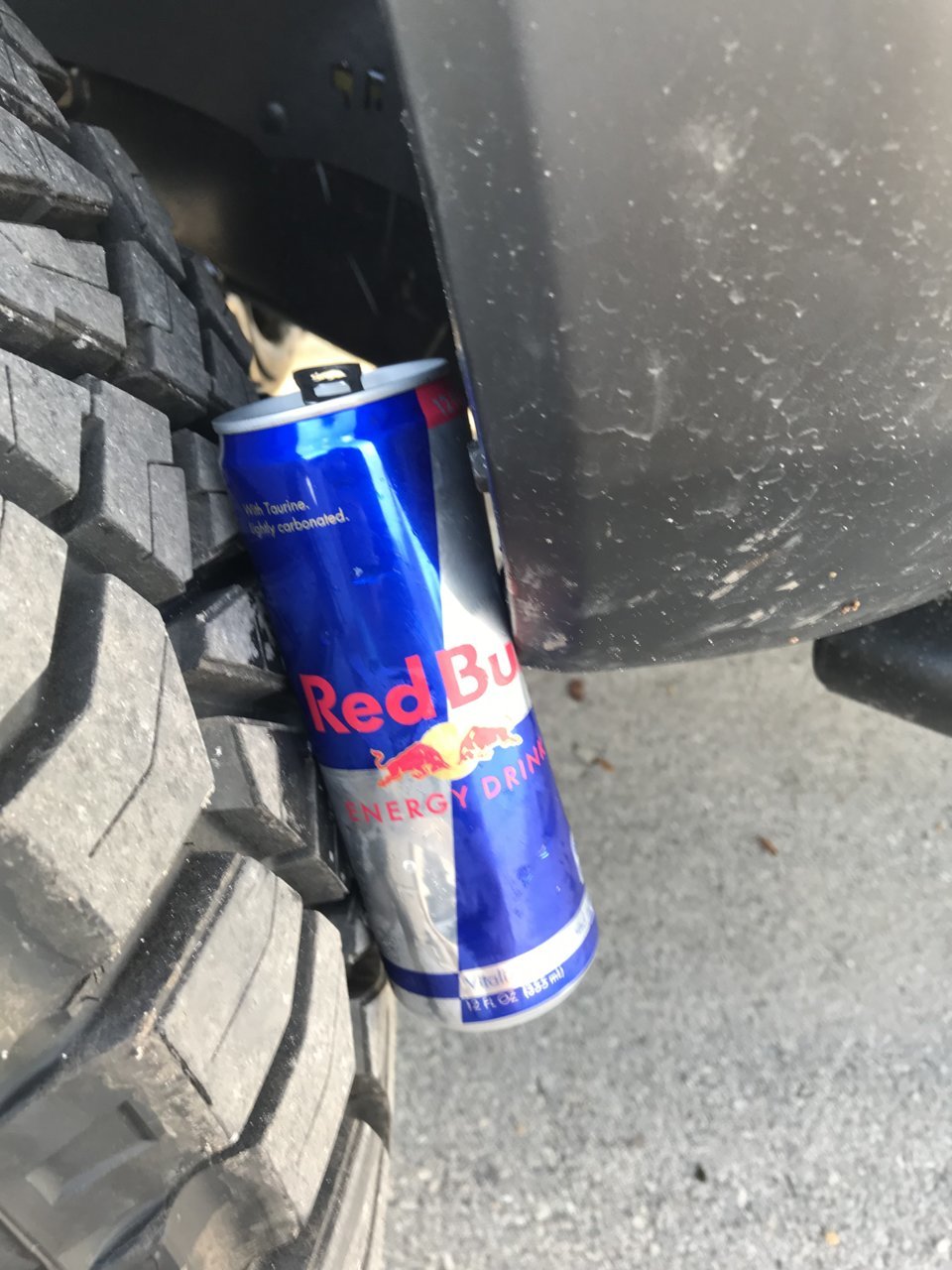

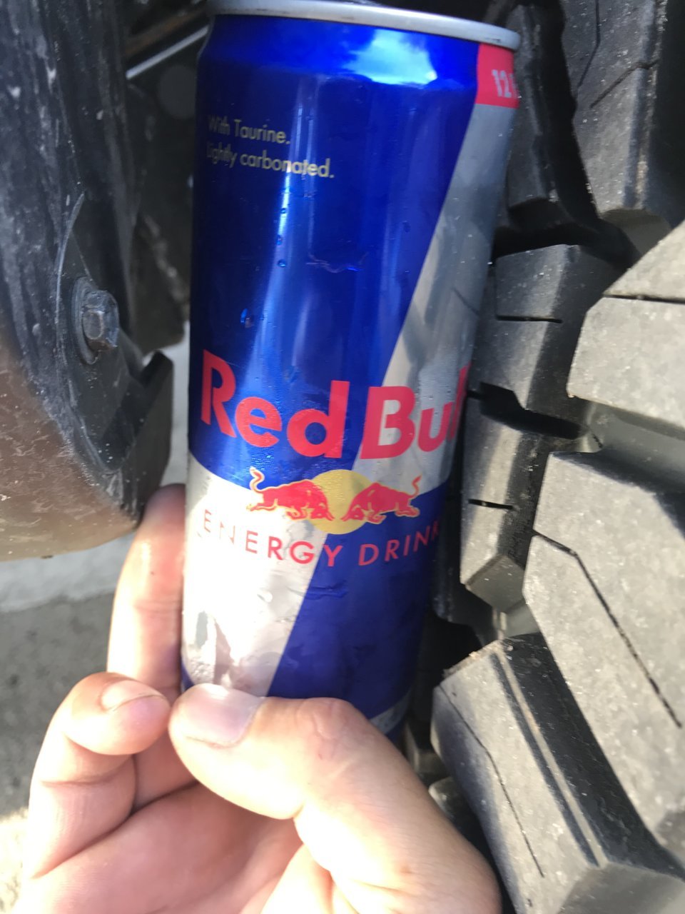

    Anyone know if this is normal? (No alignment specs were given so bare with me) driver tire is almost an inch closer to cab mount and fender (rubs for days on lower driver fender. I want to get proper alignment with specs before i cut more than i have to make it drivable)
    Here’s a few pics: wheel is straight & in same position for both pics
    Driver: 12oz rebull can is crushed a bit. After i have made a few cuts to plastic and cut some metal awayA5C1C851-4FB1-45B0-B6FD-AEF2230614CD.jpg
    Passenger: i can fit the can plus a finger. No cutting whatsoever
    Drives straight as an arrow: just not sure they gave me proper caster 3-4

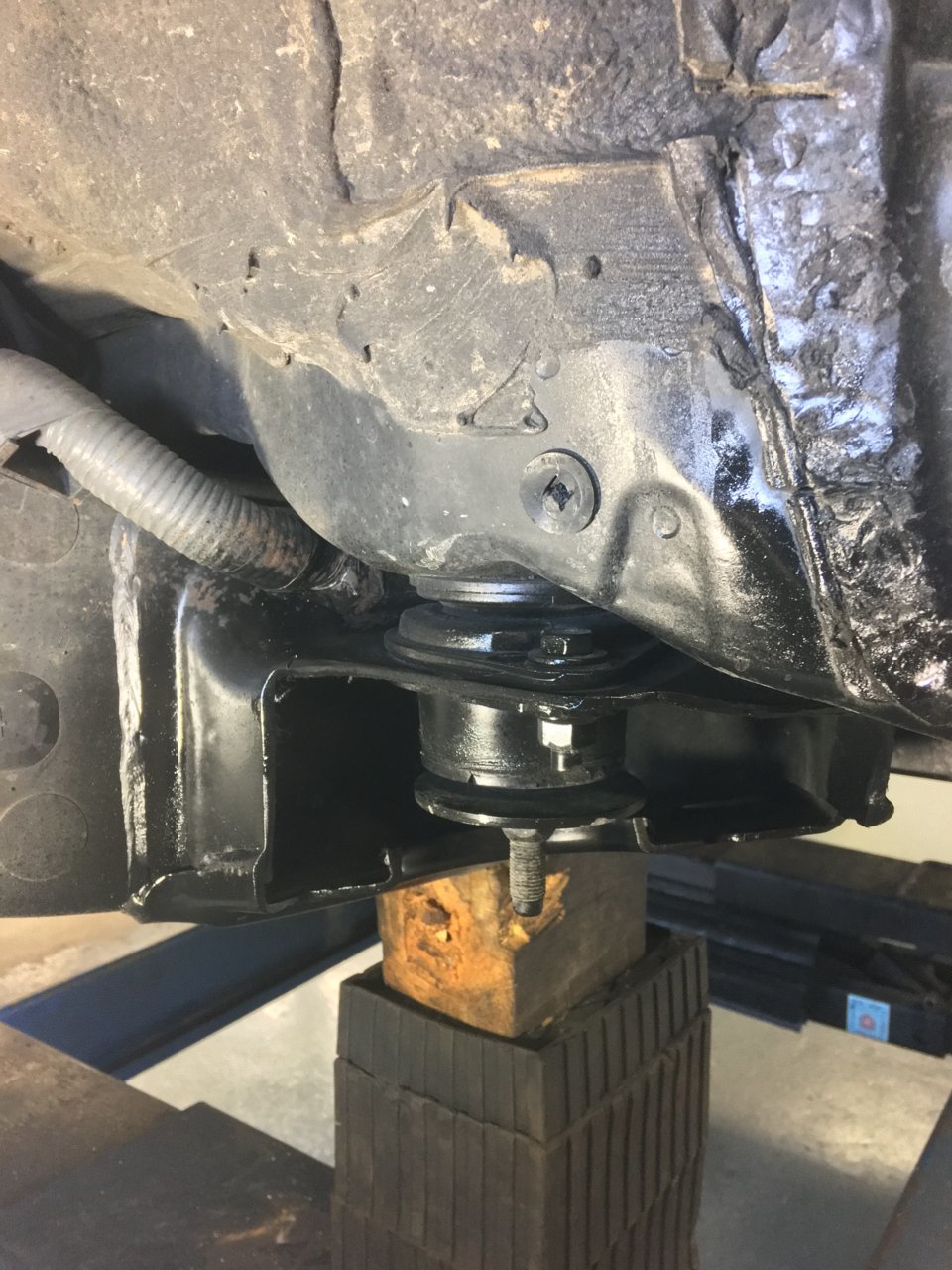

    Well good luck sir!! Let me know what you find out!! i know you are going to have to cut more than me.. wheel and offset, as you know, will make a difference in the chopping.
    mcharfauros[QUOTED] likes this.
  10. Mar 1, 2019 at 4:48 PM
    #1090
    mcharfauros
    mcharfauros IG: mcharfauros
    Apr 21, 2017
    #216893
    4,256
    MO
    2017 Black TRD OR DC
    Dumb Truck Thangs
    Thanks boss, appreciate it. If I cut anymore, I may just relocate the whole damn thing, or get some spacers since I’m on 4” BS. Will definitely keep the thread updated when I get it dialed in68A11D8A-B27A-4D05-AA54-890D228770BA.jpg
  11. Mar 1, 2019 at 4:52 PM
    #1091
    Hookedup
    Hookedup Well-Known Member
    Jun 27, 2014
    #132830
    773
    SOFLO
    2012 DCSB SPORT/ 2019 OR DCSB
    FOX 2.5 DSC/ICON RXT/SPC UCA
    Wow that’s aggressive!! I have to regrind and repaint mine.. sloppy job i had done but i clear the body mount (haven’t flexed driver side yet) i think we’ve hijacked this thread a bit.. so to be more on topic.. what’s your caster at?? Both sides..

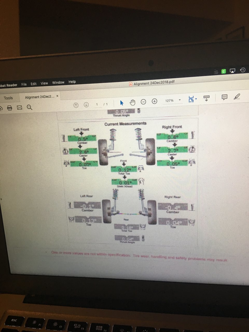

  13. Mar 1, 2019 at 5:03 PM
    #1093
    mcharfauros
    Apr 21, 2017
    #216893
    4,256
    MO
    Dumb Truck Thangs
  14. Mar 1, 2019 at 5:22 PM
    #1094
    steveo27
    steveo27 Ask me about my weiner
    Aug 12, 2013
    #110326
    6,050
    Steve
    Pittsburgh
    '11 TRD Off Road & 1992 VW GLI
    The same shit everyone else has.
    Set more caster in the upper ball joint then push the LCAs forward. Should make more room

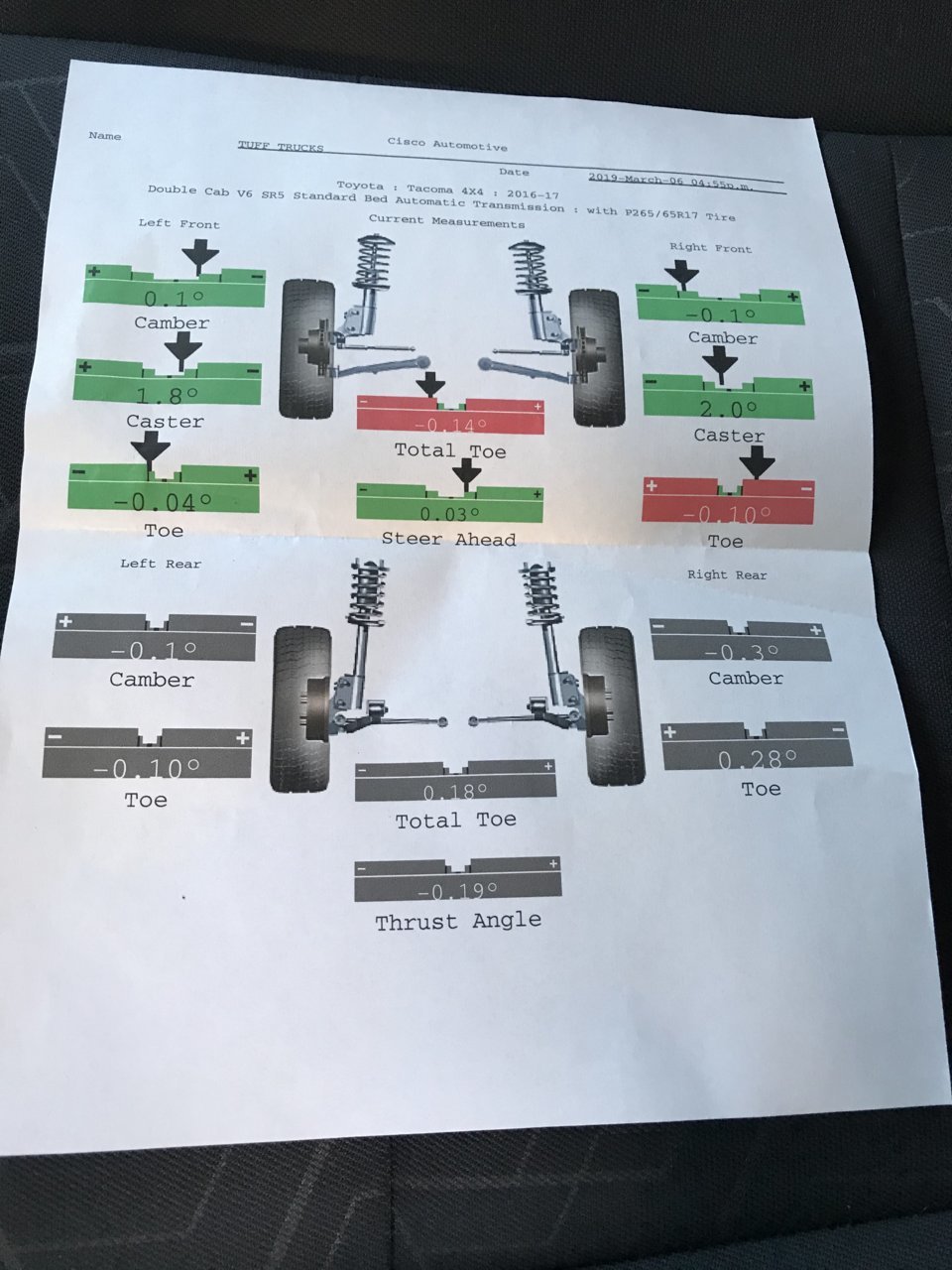

  19. Mar 9, 2019 at 3:41 PM
    #1099
    Hookedup
    Jun 27, 2014
    #132830
    773
    SOFLO
    470C9D0A-5655-4D87-83B5-21D8953C5FCE.jpg Rub a dub dub.. took it to another shop for an alignment.. they did nothing other than tell me my tires were too big.. seemed utterly clueless when i told them to push out my caster from LCA and adjust UCA for caster/camber.. but at least i got them to print out my specs.. need more caster.. Now I’m driving more than an hour away to a shop that has actually worked with SPCs before on Wednesday.. and have them redo my CMC.. will report back
  20. Mar 9, 2019 at 8:15 PM
    #1100
    steveo27
    Aug 12, 2013
    #110326
    6,050
    Steve
    Pittsburgh
    Set the LCAs yourself to push them as far forward as possible. Set the ball joints to position E then go get it aligned.
    This will give you a ton of clearance. And still get you almost 4* of caster. The won’t have to touch the UCA ball joint other than to set the camber. They’ll be able to tweak your caster with the alignment cams.
