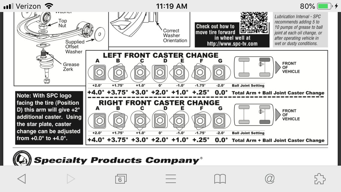

    Do you know where the SPC logo sits when set at E??

    Diagram doesn’t show where SPC logo sits.. i think they are at D ‘neutral’ now with the round side facing in towards cab.. i will check to make sure they made proper adjustment to ball joint.. I’m at alignment shop now. I can see the offset hex outside outside the uca

    The flat spot on the uca is where the logo is. Position D

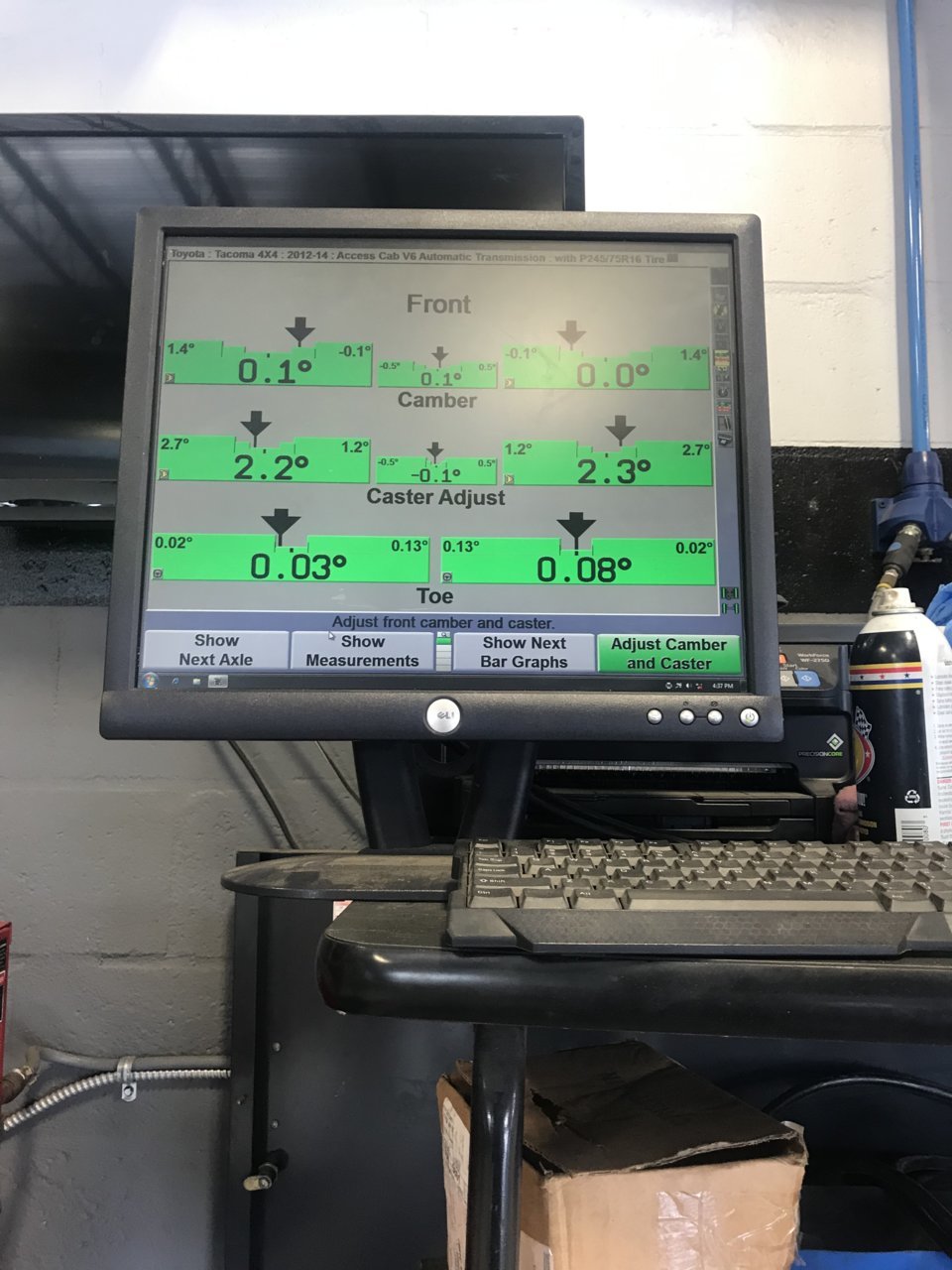

    With the lowers maxed out and upper set at E all i can get is 2.3 on driver side.. sound right?

    Not terrible, surprised they couldn’t get any more at that position.
    How’s it ride? How’s the clearance?

    Perfect!! No more rub!!

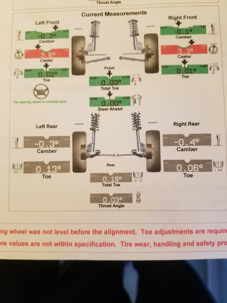

    After going to a few local shops f20190316_083507.jpg inally found a tech that understood what I was looking for and got these numbers with spc's set in D position man does it drive nice
